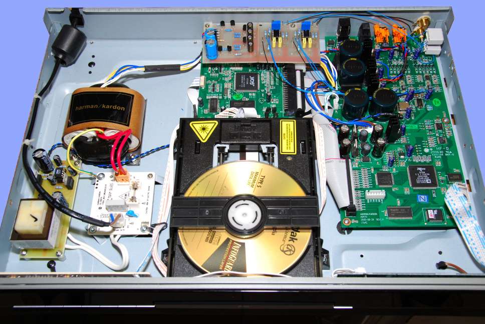

Here is an alternative internal view of HD970 and alternative upgrade:
1. Lower left hand side, the new clock power supply. The original M-Tron oscillator is still used. Why did the use 24.576MHz when this is a CD Player only. This is a DVD spec'd frequency 256 x 96KHz.
2. All post DAC circuitry has been disabled and no current drawn. We can now use the internal power supply before regulators. You can see the new output stage is powered from the input pins of the plus and negative IC Regs.
3. An entire new output stage using Passive Differential I/V (current canceling). This is kept Low Z and uses the FLTR 2.39V DAC pin to float it. The AC signal is very small and needs high gain and low noise. I use effectively a Moving Coil Phono circuit a la JLTi MC Phono, without EQ. No negative feedback. (See http://www.positive-feedback.com/Issue28/jlti_phono.htm). Minimal filtering - 50Khz single pole becoming 2-pole above 300KHz.
4. Replace plastic RCA output sockets with cryoed types. Signal single core wiring also cryoed.
5. Some SMD components fitted to lower back-EMF noise in the digital section.
6. Added a large bituminous loaded damping panel to Top Cover.
The end result? Very nice, a good and lively sound, even vibrant. Top end is quite good with plenty of nice detail. I would not describe as neither cold or warm but down the middle. Excellent bass IMO.
Joe R.
PS: George, it was two words?
