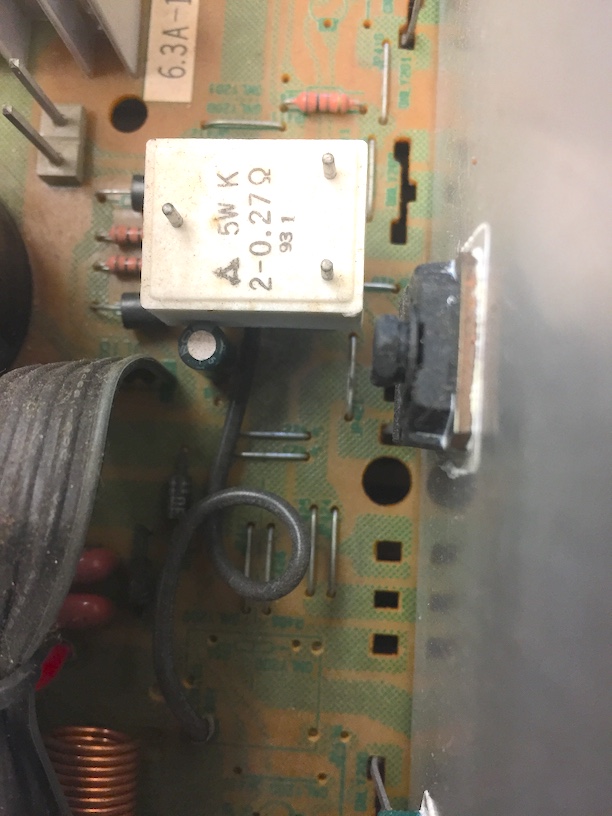

I also found what seems to be a very poorly placed capacitor (C428, next to resistor R488), and was wondering If maybe this should be a littler farther away from that big old 5W resistor. See attached photo:

From what I could find from the service manual (schematic and layout diagrams mis-cropped and multipage in the pdf alas), PCB-5 is the protection board, and its seems to be quite small.
Given its 30 years old or so I suspect a lot of electrolytics could be replaced to good effect once the fault is sorted.
Muting is by Q401, 402, 417 and 418 all controlled by Q3. The only electrolytic capacitors in the circuit are C12 which is part of the small power supply for the circuit and C11 which along with R13 is the time delay.

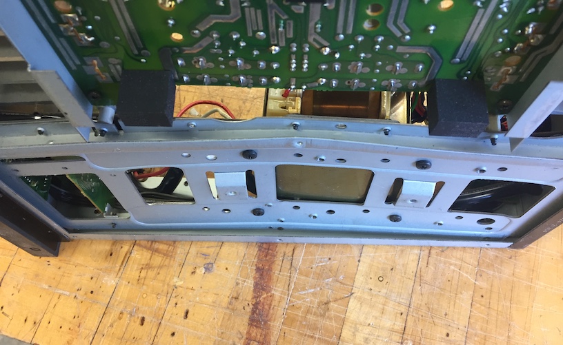

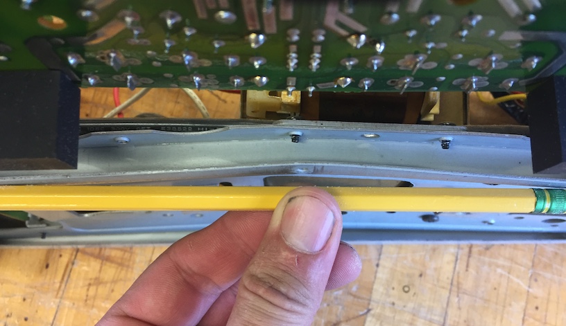

The transformer mount looks badly bent, but it is so symmetrical that it must have come from the factory this way. zero damage to the bottom cover. Maybe this was to make the mount slightly rigid and reduce hum from the transformer? Someone else in another thread re-mounted with rubber grommets, which I may do at some point if it all ends up working.

Wondering if anyone can confirm that the transformer mount has been bent on mine or if it is supposed to look like that? I don’t want to mess things up by trying to fix something that is not broken!
