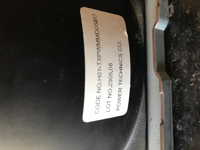

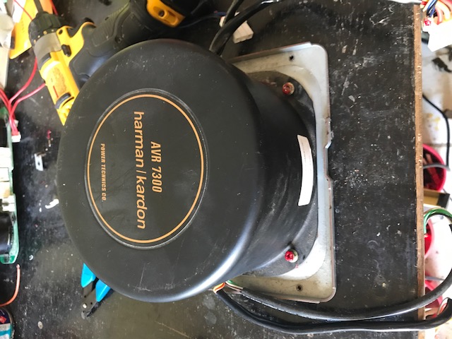

A friend gave me a deceased Harman Karon avr7300 for parts. It has a huge torodial transformer and I am trying to find out the specs of it. Contacting HK didn't help.
Anybody knows the specs of this transformer or where to find them?

Anyway, coming back to your question the amp boards use +-55V. That is after regulation obviously. So my guess would be 2x55VAC give or take.

Power amps rarely fed regulated power. My bet would be 40V-0V-40V.
This can readily be checked if you can identify the wall-cord winding and use a dim-bulb limiter.
It can power essentially what the original was rated. Two channels at >125W 8r each steady-state. It can power seven channels at >100W (or probably two at 4r at >200W) as long as it is speech/music/movies and not steady test-tone.

If you look at the manual page 154 and 157 most of the voltages are shown.
So there seems to be:
10V-0-10V
17V-0-17V
20V-0-20V
45V-0-45V (main power for output stage)
48V-0-48V
There are also secondaries S6 and S7. Voltages are not shown on page 157.
On page 150:
The (AC)-0-(AC) seems to be used for a +10V unregulated supply, which is used for the fan and the 5V and 3.3V regulators.
The other secondary is just called AC. It is used for a +44V supply for the display board, probably at a low current level.
The currents needed are not shown, so it will take some further study to calculate/estimate them.
