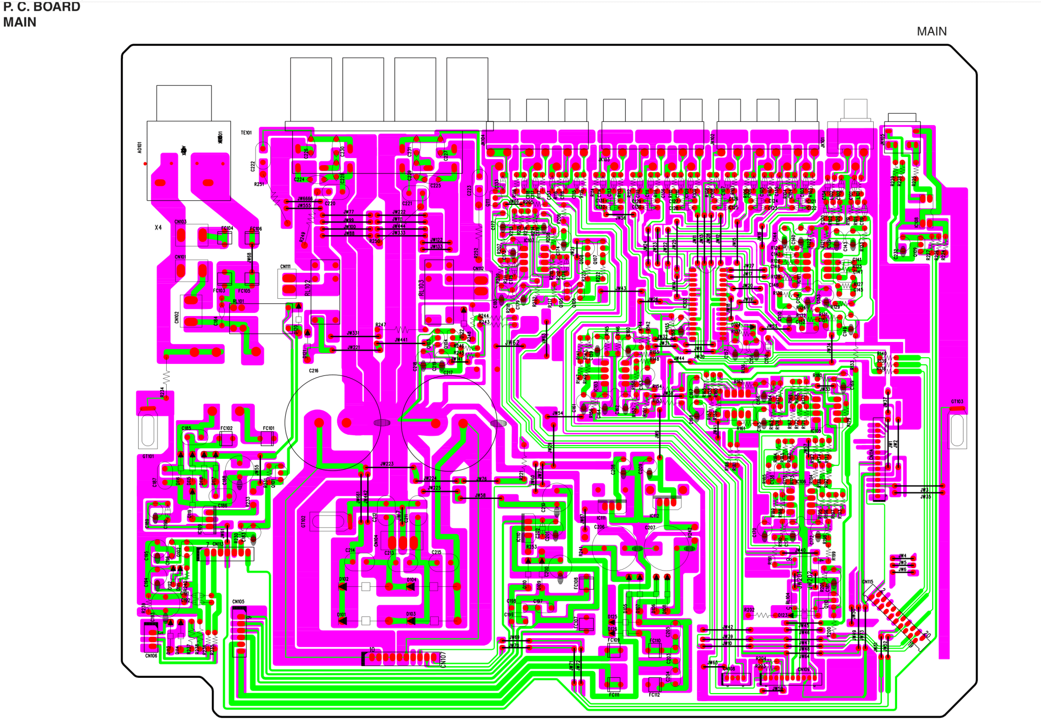

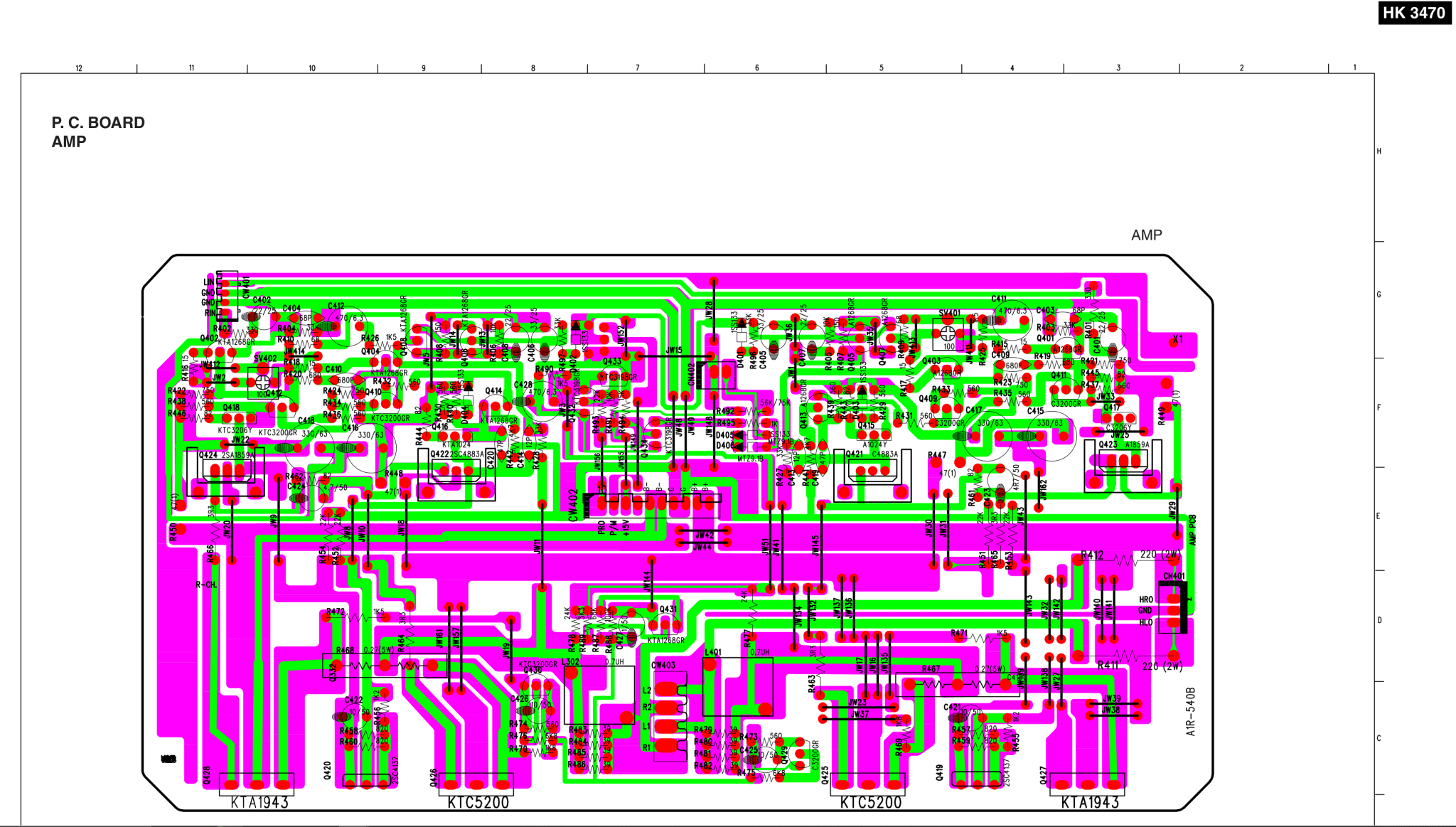

With the internal preamp connected there is a buzzing sound added to the humming noise even when the volume is at 0, this is because of a bad pre-amp design i think. Can you help locate the supply rails? I don't feel comfortable poking around with my multimeter inside a working amplifier. I have uploaded the PCB pictures from the pdf i uploaded earlier, the schematic is on page 113, and 116. I'm not an expert at amplifier reverse engineering, but i think the two B- and the B+ are the rails that go into the amplifier from the main board right?

But wouldn't that bypass the capacitors? I should measure them with an LCR meter, but their capacitance is too high to measure them on the PCB, so i have to desolder them sometimes in the future. I should also consider buying a protection, because i have an expensive pair of DALI speakers with this old amplifier, a Guardian-86 maybe a good option i think. As for the rails i think i can manage to get my multimeter's test leads into the connector.
I was suggesting measuring ripple voltage present across the big electrolytic caps. From that we can draw rough assessment of health of the caps. Knowing DCV on the caps is good for perspective.

I've measured the VDC on the connector itself (CN107) on the main board and the B+ to GND and B- to GND were the same 58.4VDC, maybe close to 60VDC, i also measured a 0.002VAC at the same place. The measurements were all measured using a APPA305 TRMS multimeter. Should i get a measurement before the smoothing capacitors?
