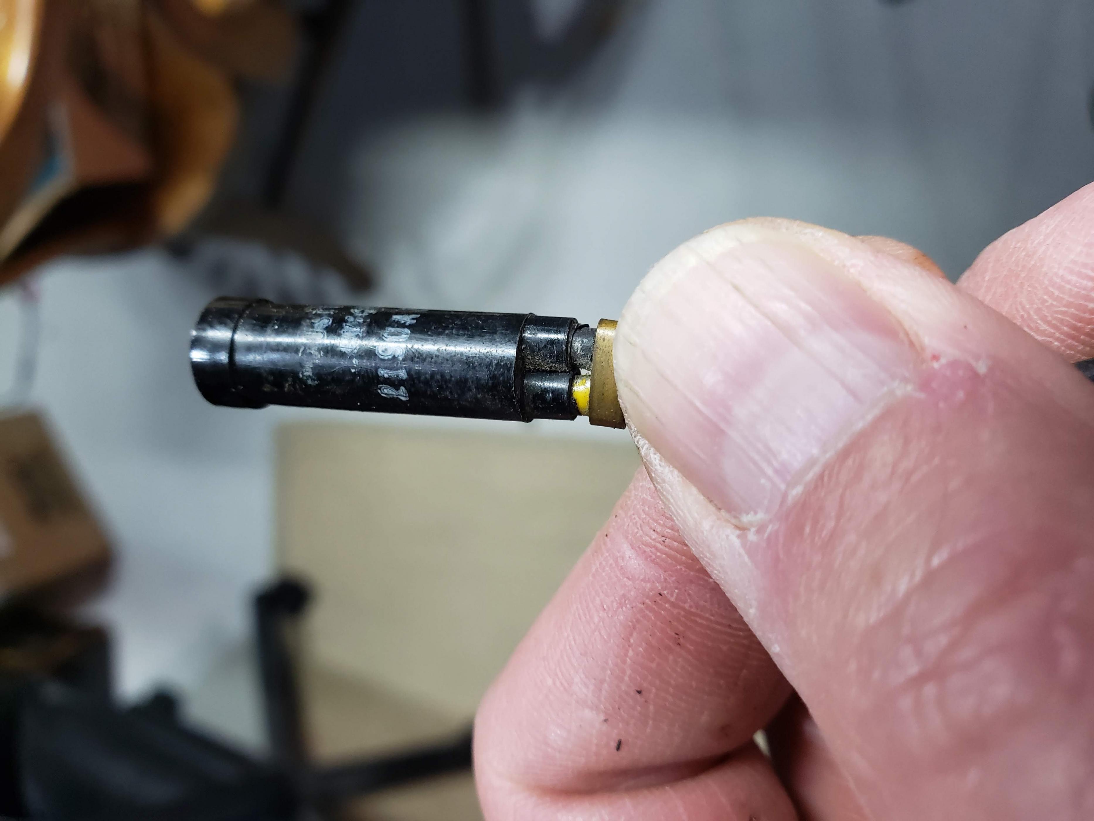

All...
The stereo indicator on this receiver will not light even when on a strong stereo signal. According to the schematic the indicator is a neon lamp ACOM 7337. No results for that part number.
I tried a couple different types of new neon lamps, NE-2. One had a firing voltage of 90V DC, the other 50-60 VDC. No luck.
I measure 30VDC arcoss the neon lamp, which is likely why the new lamps are not firing. I also measure .3mA, which is not enough to drive a red LED (about 20ma or better);
I recently aligned the tuner, and it provides an excellent FM stereo signal with plenty of separation.
It is entirely possible that the circuit should drive higher than 30V, but I wouldn't drive anywhere near what I need for 50 or even 90vdc.
I would like to either find a neon lamp that fires at a lower voltage, or modify the circuit to use an LED instead.
Of course, I could just leave it alone since it sounds good anyway.
Has anyone replaced these type of indiciators? Find a source for them?
How about modifying to use an LED?
thanks,

As I said in post #24 it ends up a 19KHz signal, as you can see one end is connected to T1=GLCOM6167.
VERY little current is used in those neons because in this case its not just a striking voltage required to activate it but a superimposed audio signal --don't confuse this circuit with electrical mains derived indicators .
FYI - radio hams made use of neons to "tune up " their HF transmitters with NO physical connections just the RF field.
