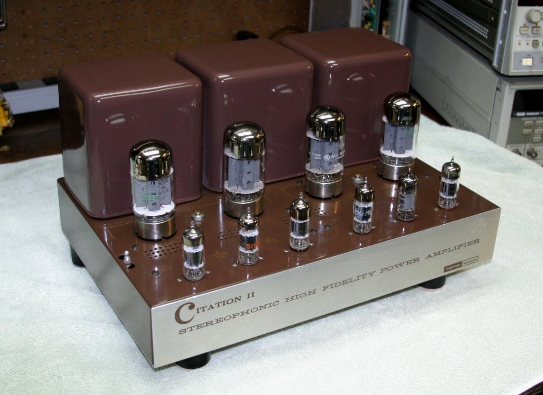

The answer to your original question is, yes! It's certainly worth restoring. Someone gave me one less tubes in 1976 I think. I put tubes in it and used in sound reinforcement (remember disco?) and as my home amp for years. It took a regular beating and about 10 years ago it finally smoked. Time to open it up.
The original parts for the PS are no longer available so I put in the PS kit from Jim McShane along with new sockets, tubes, speaker terminals, coupling caps, etc. My wife gave me a set of Gold Lion outputs for Christmas and I got it up. I built a tube analyser and found that my collection of 12BY7As showed two modes. The RCAs and the Sylvanias had 4-7 ma plate current at a given bias and the GEs showed 9-17 ma under the same conditions. So I took Jim's advice and used the GEs in the phase inverter to balance things up.
So - Sounds great. I had an opportunity to blind A-B it with a Mac 275 with friends. Everybody preferred the sound of the Cit. In fact, it blew it away, and the Mac was in good shape. The Cit is a classic for a reason. If you fix up a Cit II you have something that will sound better than just about any "high end" amp made and for about 10k less money.
I woudn't F*** around with it very much. Stu Hegeman did some real witchcraft with feedback in that amp and I can't think of anything to do with it that would make it better. As it is, I can drive it to well over 100 watts a channel without detectable distortion. (I didn't measure the distortion as I didn't want to run the amp at that power for long enough to measure it.)
The only thing I would advise you to do is to check for components that have changed value and replace any worn out hardware. Should last another half century with no problem. BTW, Jim McShane is a wealth of resources and advice. The world is a better place with him in it.
P.S. I also used the Cit II to drive a cutting head cuz the sound was better than what came with the lathe. Made the records sound deep and clear. Just hooked up the 16 ohm terminals to the 500 ohm head windings. Worked just fine.

No idea what you are talking about.. 😛 The stock amplifier has plenty of voltage gain, referred to the 16 ohm taps around 28dB under load, about 3 dB less referred to 8 ohms. (Given constant output power.)

I have to agree with Kevin. Sure, there's some incredible feedback both global and local and only Stu Hegeman could have gotten away with it. It's made up for by using pentodes (12BY7A) for the input and phase inverter, which have much more gain than the triodes other amps used. Or you might say the higher 3rd order distortion of the pentodes is made up for with lots of negative feedback.
It must have been done skillfully cuz every time I try to use NF it makes the program kind of dead sounding. Good numbers on test equipment but muffled sort of. A subjective thing. The Citation doesn't do that. Best sound I've heard.
Also, TBH, I didn't notice much difference when I replaced the thirty year old GE 6550s with new Gold Lion KT88s. Just a little more power wide open, which I never use. I'd be interested to hear if someone else has experience with that.
Age isn't necessarily a big issue, the number of hours of operation and how hard they were pushed is more relevant. A higher quality tube may also last longer operated within its ratings than a comparable but cost engineered competitor. The pre MPD GE 6550 was a pretty high quality tube. (I still have some I use in projects from time to time)
The 12BY7 exhibits high gm. That "speed" protects against HF error correction signal induced slew limiting. Hegeman, a most competent engineer, understood RF circuit designs and applied that knowledge to an audio problem.
Of the 36 dB. or so total NFB in a "Deuce", only a few are present in the outer, global, loop.
