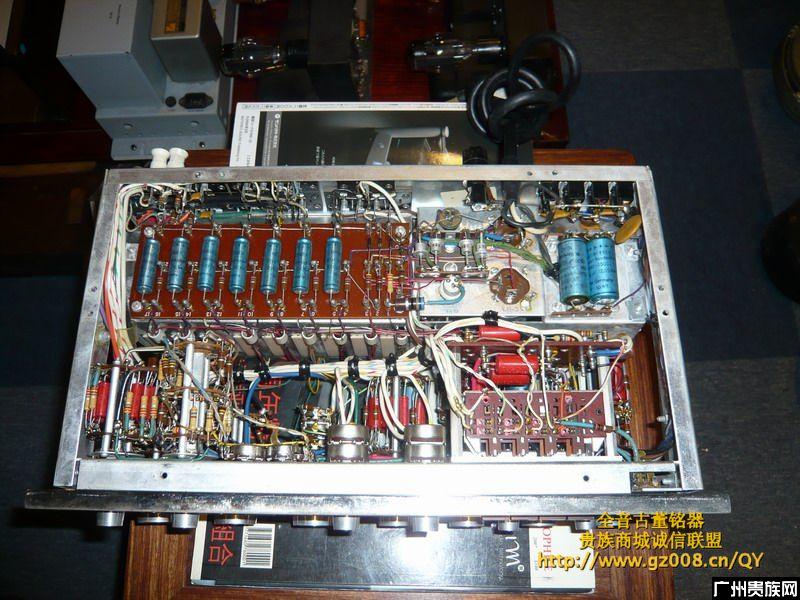

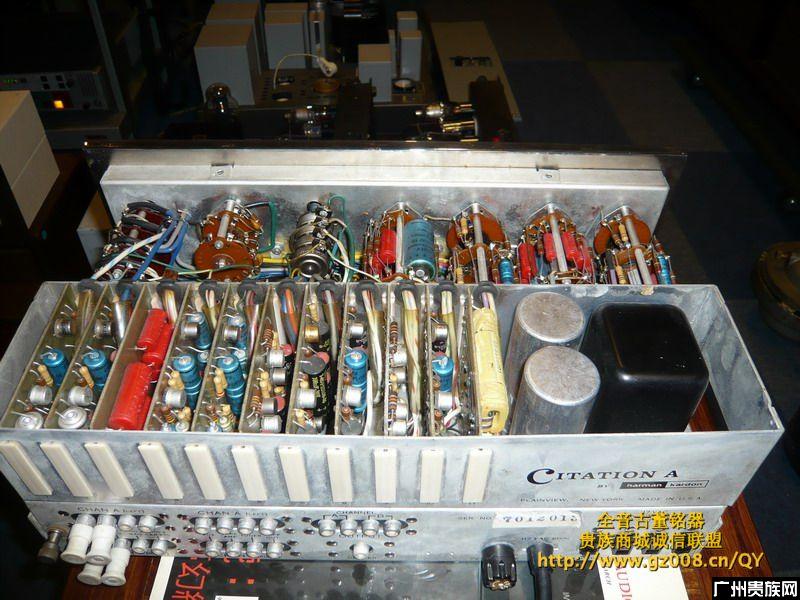

hello, i realize this is an old thread, but if anyone can help id really appreciate it. i have a citation A. all electrolytics have been replaced. now im having transistor trouble. the transistor numbers on the amp boards are hkt 10 which is a pnp germanium hkt 11 which is an npn silicon. and hkt 12 which is a pnp germanium. im not sure if this is supposed to be. but it is this way on all seven amplifier boards. the emitter follower boards have two pnp germaniums and two npn germaniums. the preamp does work however there is distortion at higher levels and when i turn either bass knob up at any point passed half the signal cuts in half and becomes distorted. im wondering if this pre was designed to use these npn silicon devices. or if they to are supposed to be germanium. any insight would be greatly appreciated.

Hi Everyone,
I was the originator of this "Citation A" thread. Just to give an update of my transistor trouble that may help some of you. My transistor turned out not being defective. Transistors usually work or don't work. One or the other. Not part time. Mine would work when I turned it on but after a short time it would start hissing or fizzing. This only affected the one channel. After exhausting all possible avenues of replacement I decided to pull the transistor and look through old transistor replacement manuals to no avail. Since I didn't know what the particular transistor was, I had a difficult time. I decided to give up and put the transistor back in the board. Much to my surprise it worked and continued to do so without any further problems. I came to the conclusion that more than likely it had a cold solder joint and when I reinstalled it with new solder it solved the problem. This preamplifier didn't get much attention when I bought mine and did an in-depth review of it's qualities. Now they are getting the attention they deserve. It's a fantastic early transistorized preamplifier (in fact the first one) work of art. Check those solder joints. Enjoy!
