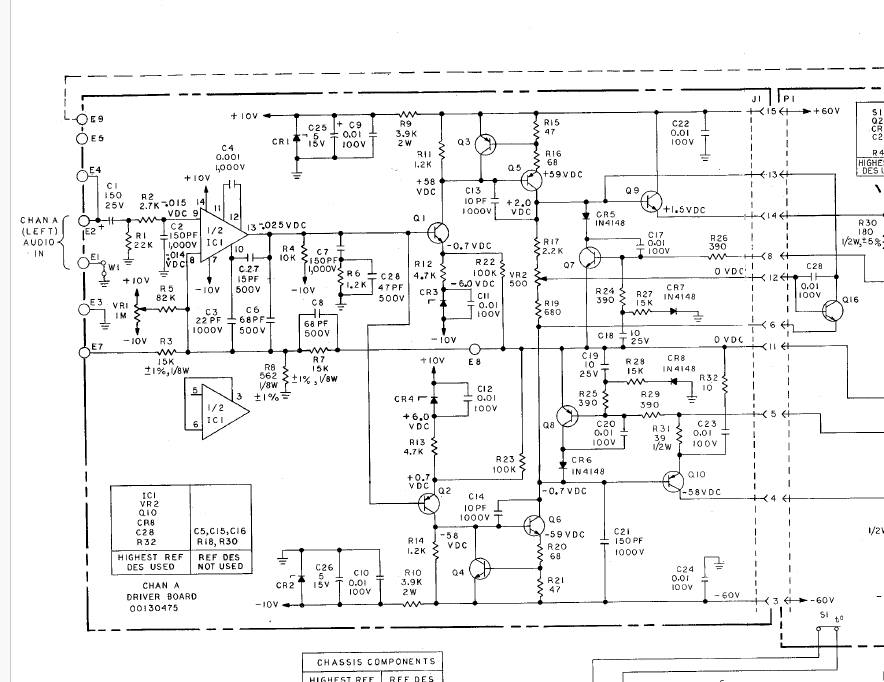

So the 739 ICs where expensive on there own. And the site that sold had a minimum of 100$ purchase of international shipping. And as I live in Sweden. Where we “looooove” taxes and other **** in that category… I will receive tax of this product as it outside of EU. So it will probably land on 150$ for 2 ICs…. But a dude I know will fix for me. He has a lot more experience than I have. He will fix a good replacement of this IC for me in some weeks. But I have a curious question.
Wich HK is there better one? 16 or the 16A ?
I have read a lot of forums. But not really got a hold of which one is the better “sounding” one
First - the front panel light was a very simple fix, it just needs a new neon panel lamp assembly, with the correct internal resistor for your local power line voltage, it had nothing to do with anything else going on inside the amp, it is just there to indicate that the transformer is getting AC power and the fuse isn't blown and the heat sink thermal protect - S1 - is not tripped.

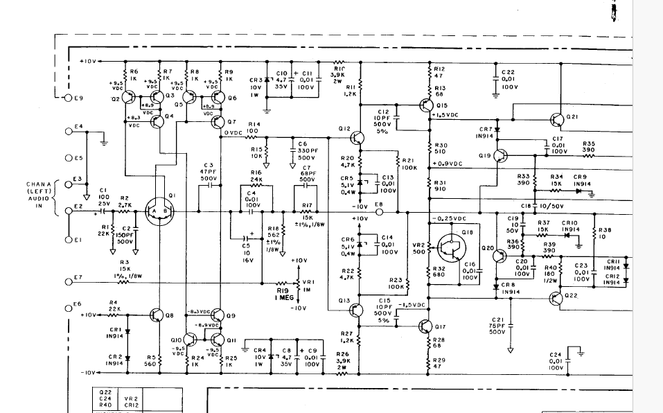

The 16A is a different animal in a few ways. Instead of the IC's you are having issues with, it uses 10 other discrete transistors per channel to do the voltage amplification and feedback in the low level stage. The 16A also uses a darlington transistor on the PCB, and the heat sink, to monitor and self-adjust the bias when temps change. The BIG difference, is, they designed the 16A to run at a MUCH higher bias level, so it operates in Class A up to almost 3 Watts, which also raises it's idle temps on the heat sinks to 60 degrees C, but, is supposed to make it a much lower distortion amp at lower listening levels by eliminating the crossover distortion an amp with a lower bias level may have. There's nothing wrong with a 16 in general, but if I was choosing between the 2, i'd choose the 16A

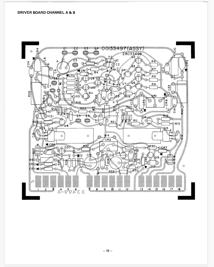

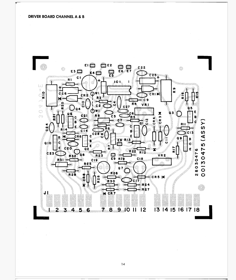

Silkscreen and schematic of both boards.
Replacing the 739 is not a strait forward job ( so I read )
