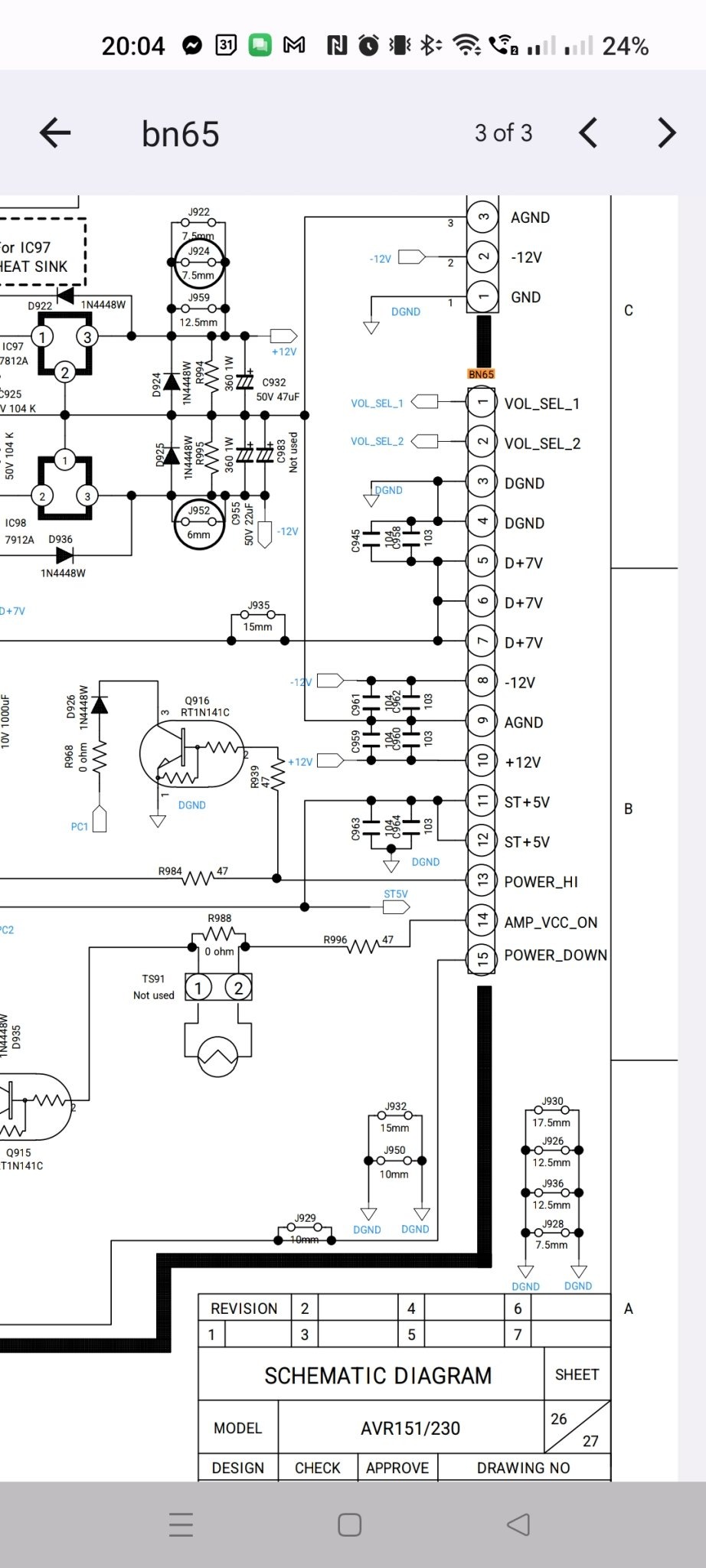

Still trying to figure out whats the problem. Could it be that the main mcu is shutting it down / not turning it on? On connector BN65 i have pins 13,14,15 which are POWER_HI, AMP_VCC_ON and POWER_DOWN. I have 4.8V on pins 13/14 and i have a 50hz square wave on pin 15 with ~3.6V rms. But i cant find what are the correct values for those pins or are they inputs or outputs.

The 50Hz square wave looks okay for me. It's generated by an optocoupler from the mains voltage. I don't see the issue here.
Did you check the rest of the power rails, especially +-40V of the CN20 that supplies the amplifier stage?
