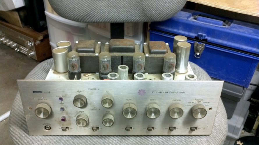

My father-in-law gave me his old Harman-Kardon A50K, which I believe is the kit version of the A500. It's spent the past few decades in a garage, so it is a little crusty/rusty. It still has the original tubes, so it seems. HK-branded 7355's and "Made in West Germany" 12AX7s. It obviously needs to be recapped and generally fixed-up before applying power.

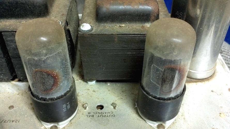

The 7355's have some getter left, but definitely look worn. He used this amp for a long time and liked it a lot, so I imagine they are tired. The 7355 seems all but extinct.
Any advice? Is this amp worth fixing-up (assuming that it works)? Should I mod it for 6L6's? I assume the OPTs are good quality, so should I just build something better around them down the road?
When I get a request from someone who wants to buy 7355s (now VERY hard to find, let alone find matched ones!) I recommend the Sovtek 7591XYZ. Those were the stopgap tubes made for a while until the EH 7591A came out. The XYZ tubes were Sovtek 5881/6L6s pinned out to match the 7591. As a result the XYZ is a virtual drop in sub for a 7355. Just one caution...
H-K A500/A50Ks used pin 4 as a tie point on the output tube sockets since the 7355 tube didn't use pin 4. They usually connected one end of the grid resistor there. But on the 7591A or 7591XYZ there is a screen connection at pin 4! So anything in the amp tied to pin 4 MUST be relocated and pin 4 left empty - or you'll have the screen voltage applied to the control grid! :eek:
That's the only change needed to use the 7591XYZ. They sound nice, pairs/quads is no problem - and they're cheap too! I did an A500 with a set of XYZs not long ago - it turned out great!

Not the 7591A!! The 7591XYZ. The XYZ is much closer electrically since it's a 6L6 type. You'd have to redo the bias circuit to use 7591As.
And the 7591XYZs fit fine.
Remember - the 7591XYZ is the tube you want, NOT the 7591A.

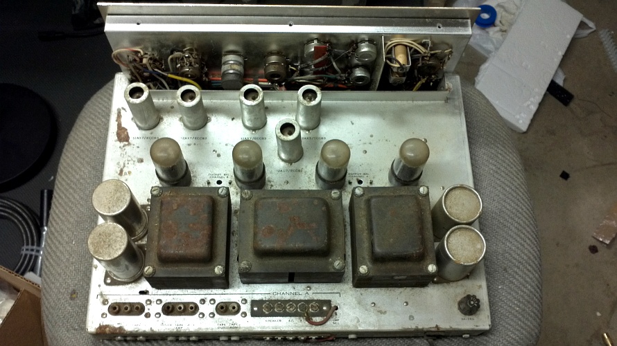

I popped the bottom off. After vacuuming out all of the bird seed that was packed in there (mice?), it looks pretty good. Whoever built the kit did a nice job. I see one repair where an old film cap was replaced. Everything else looks original and in good condition. I think I will attempt to reform the caps on the variac and see what happens. If it works, maybe I'll keep it. I think my father in law would be a bit heart broken if I dismantled it.

Just wanted to follow up on this thread. I finished rebuilding the amp using a kit from Jim. The amp sounds pretty good now. Even better when the tone controls are bypassed. The only real mods I did were the lifting of pin 4 on the octal sockets to allow 7591s to be used and also converting the "Tape HD" input to a line-level input instead of a preamplified one. I put a proper chassis ground in as well.
After the rebuild and repairs, I found that the original 7355's have some life left in them. They draw enough current to power the DC heater string for the preamp section properly. A couple of the 12AX7s were almost completely gone, but those are simple enough to replace.
After some cleaning up, it has been serving in my main system while I finish a preamp project.
