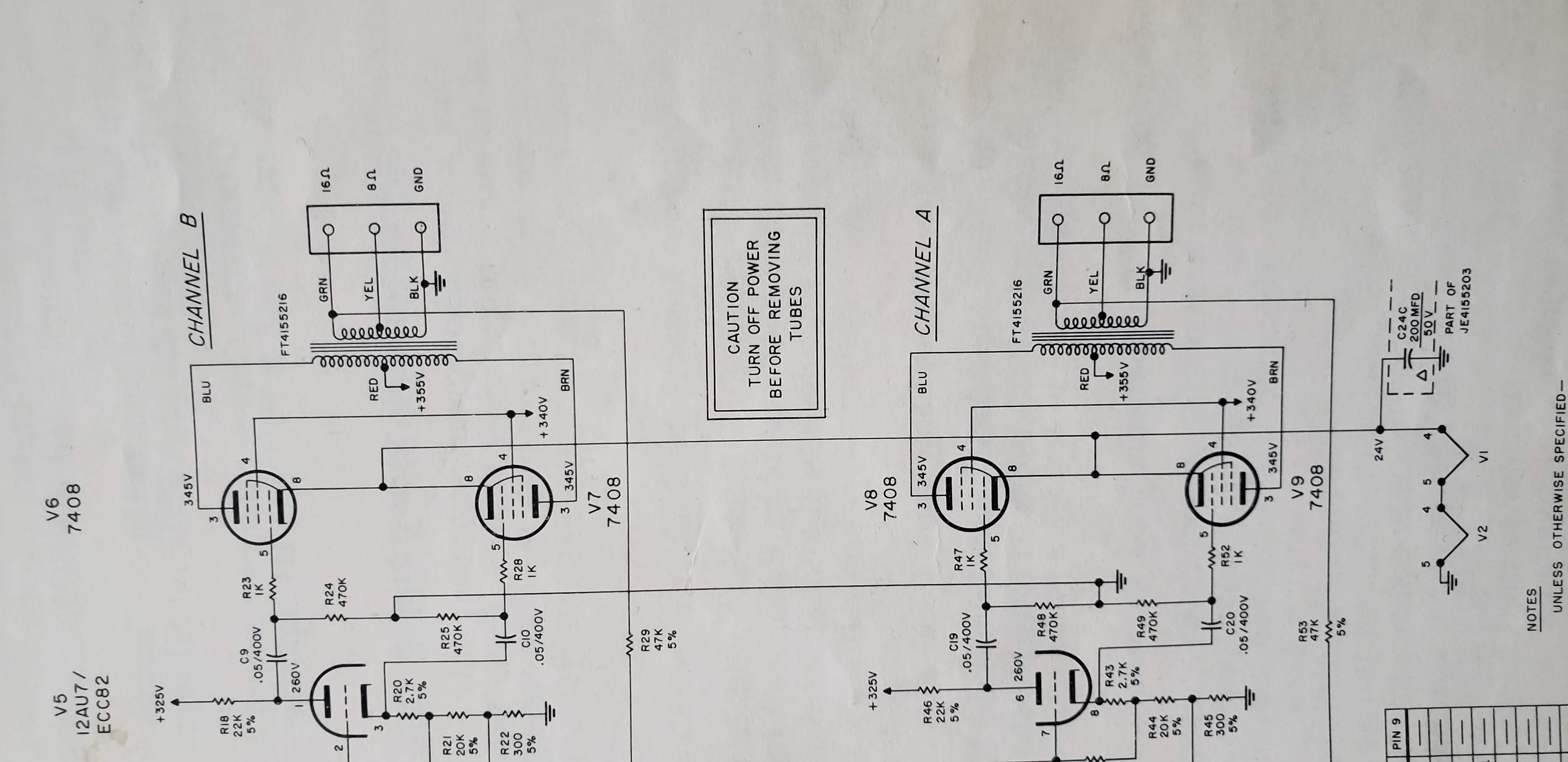

I have a HK A300 stereo tube amp.
Presently the output tubes are biased throught the 12AX7 tubes.

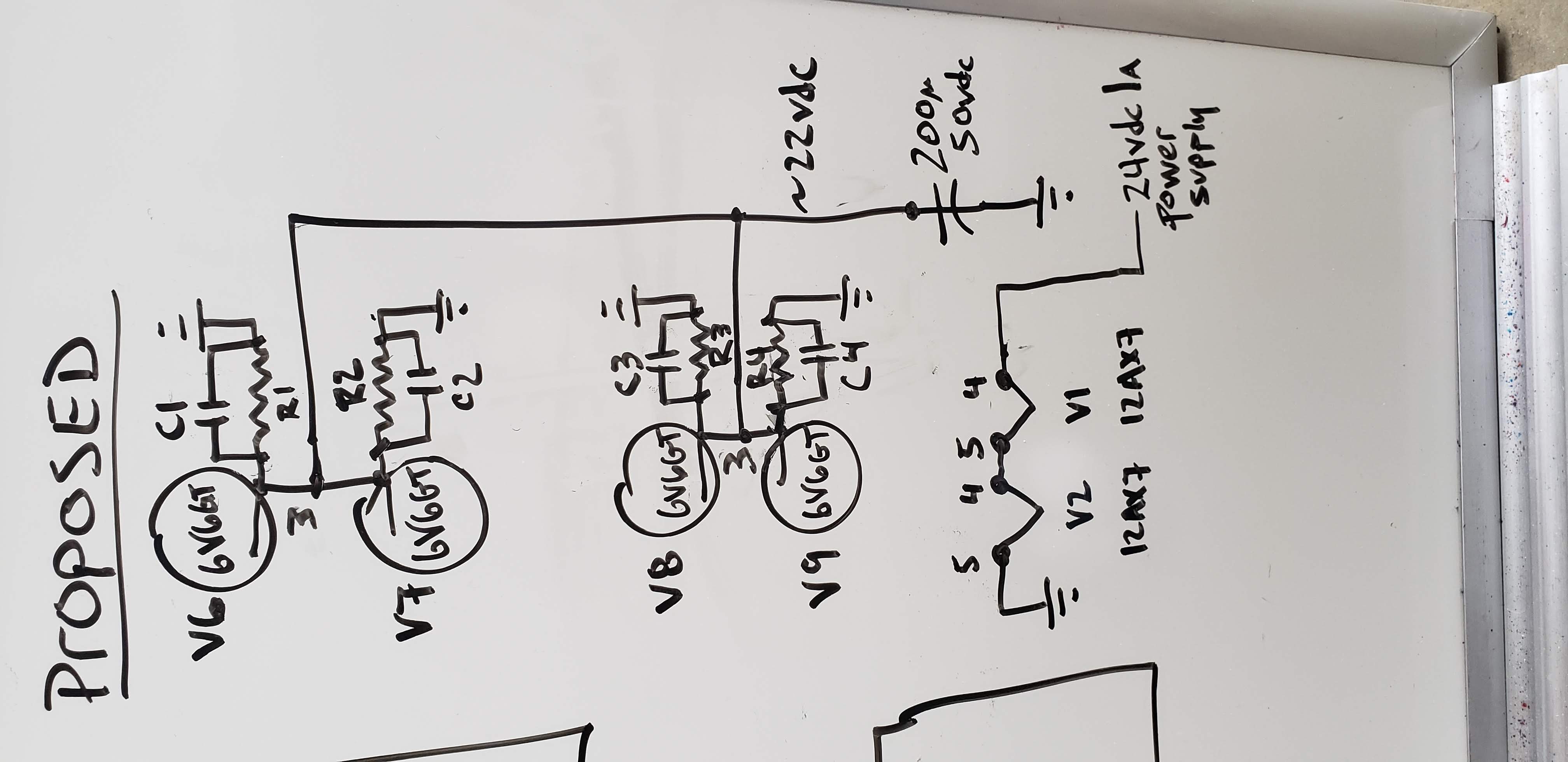

I want to split the 4 output tubes from the 12AX7 preamp tubes to allow me to individually bias each output tube (orignal Schematic of output section attached)
1. Is my proposed wiring diagram correct and functional? Attached
2. I could use some help in determining the R values and wattage rating, and the C values.

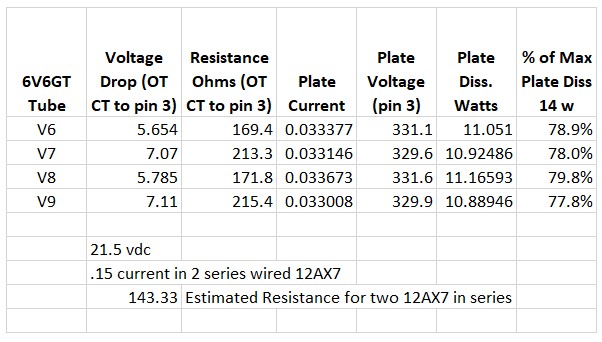

My specific BIAS readings are attached.
I see that some tube datasheets provide a rating for the resistor, unfortunately there is none provided on this tube datasheet. Attached
I assume I need to calculate it. I estimate is at 143 ohms. 21.5 vdc / .15 = 143 ohms for each R, correct?

I estimate that the 12AX7 tubes are providing 143.33 total resistance
Resistance and voltage drop was measured from OT center tap to pin 3 of each 6v6GT

The filament string resistance is 24VDC/150mA = 160R. Use four times that for each output tube.
This will be 4 x 160R = 640R, each one dissipating 24Vx24V/640R = 0.9W. Use a 620R, 3W resistor.
All the cathodes are separately biased with a 620R resistor each, and not connected together.
Use the parallel C for each 620R set at 10Hz, so C = 1 / (2Pi x 620 x 10 ) = 25uF, use a 27uF/50V capacitor.
For 2Hz use a 100uF cap.

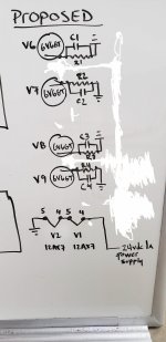

4X completely independent RC bias networks is what you're looking for. I revised the proposed schematic.
FWIW, I totally agree with eliminating "Cheap Charlie" DC heaters in the phono section. Only 150 mA. are needed from a "24" V. supply or 300 mA. from a "12" V. supply.

The small output transformers (OPT) absolutely require that the currents in each pair of 6V6 be balanced.
If the currents are unbalanced, you get early saturation of the OPT, bad bass, and more than normal intermodulation of the bass notes on the mids and highs. Negative feedback can not cure everything, there are limits. In fact, as the core saturates, the negative feedback will make it even more saturated in an attempt to 'correct' the signal.
Purchase very well matched tubes, and hope for the best (may be matched at a different operating point.
Or, use individual self bias resistors and bypass caps, just as you have proposed.
you can easily measure the cathode voltage of each tube, and see how well the currents are balanced. And you can check later, as the tubes age.
Oh, and who wants to purchase a matched quad of 6V6, since they all 4 cathodes are connected to each other, in order to power the two 12AX7 filaments that are in series.
High power that is distorted is not very good (this amp is not intended for Guitar amp service).
A small loss of power when using individual self bias resistors is a good tradeoff, just use plenty of capacitance in the individual bypass caps.

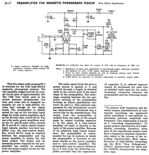

The varying O/P tube plate currents modulate the temperature/emission of the phono section cathodes. 😡 That's exactly the sort of unwelcome feedback loop to avoid. Selenium and, eventually, Silicon SS rectifiers made "proper" DC heating practical/affordable. Several hundred mA. of low voltage DC is a very difficult proposition using vacuum rectifiers.
While I don't care to try, it is possible to obtain acceptable residual hum levels, in a phono preamp, with AC heating. It is an extraordinary challenge. Types with spiral wound/hum bucking heaters, like the 7025 and 6EU7, get used. RCA allowed/planned for AC heating in their famous passive EQ design. Notice the schematic calls for a 7025, not a 12AX7.

So you're saying it needs a bigger cathode bypass cap?
I'm saying "Cheap Charlie" DC heaters has to go. Install SS rectified and regulated DC heater supplies.
H/K and all the other manufacturers that used the "Cheap Charlie" technique had the wherewithal to well execute AC heaters with either 7025s or 6EU7s. Instead, they relied on a cheap (in the grammatically correct sense) gimmick to "hype" sales. "Cheap Charlie" DC heaters is an example of the American weakness in preferring "glitz" over solid engineering. The prime example of that shortcoming lies in the automobile industry.

The A300 output tubes are self biased.
The two phono 12AX7 filaments are wired in series, nominal 12.6V in series with 12.6V = 24V.
The output tube cathodes are all in parallel, and are connected to the top of the upper 12AX7 filament.
The total of all output tube current is applied to the series filament string of the 12AX7 tubes.
There is a single bypass capacitor that connects from the output tube cathodes to ground.
12AX7 filaments are rated for 12.6V +/- 10%. The nominal current at 12.6V is 150mA.
All 4 output tubes draw about 150mA (about 37.5mA each).
The g1 grid return resistors of all output tubes are returned to the junction of the filaments of the upper 12AX7 and the lower 12AX7.
The bottom of the lower 12AX7 filament is connected to ground.
Output tube cathodes are at about 24V. Output tube g1 grid return resistors are at about 12V;
So output tube the bias is about 12V, the difference between +24V and +12V.
If that is not clear, than you need to find a schematic of the A300.
