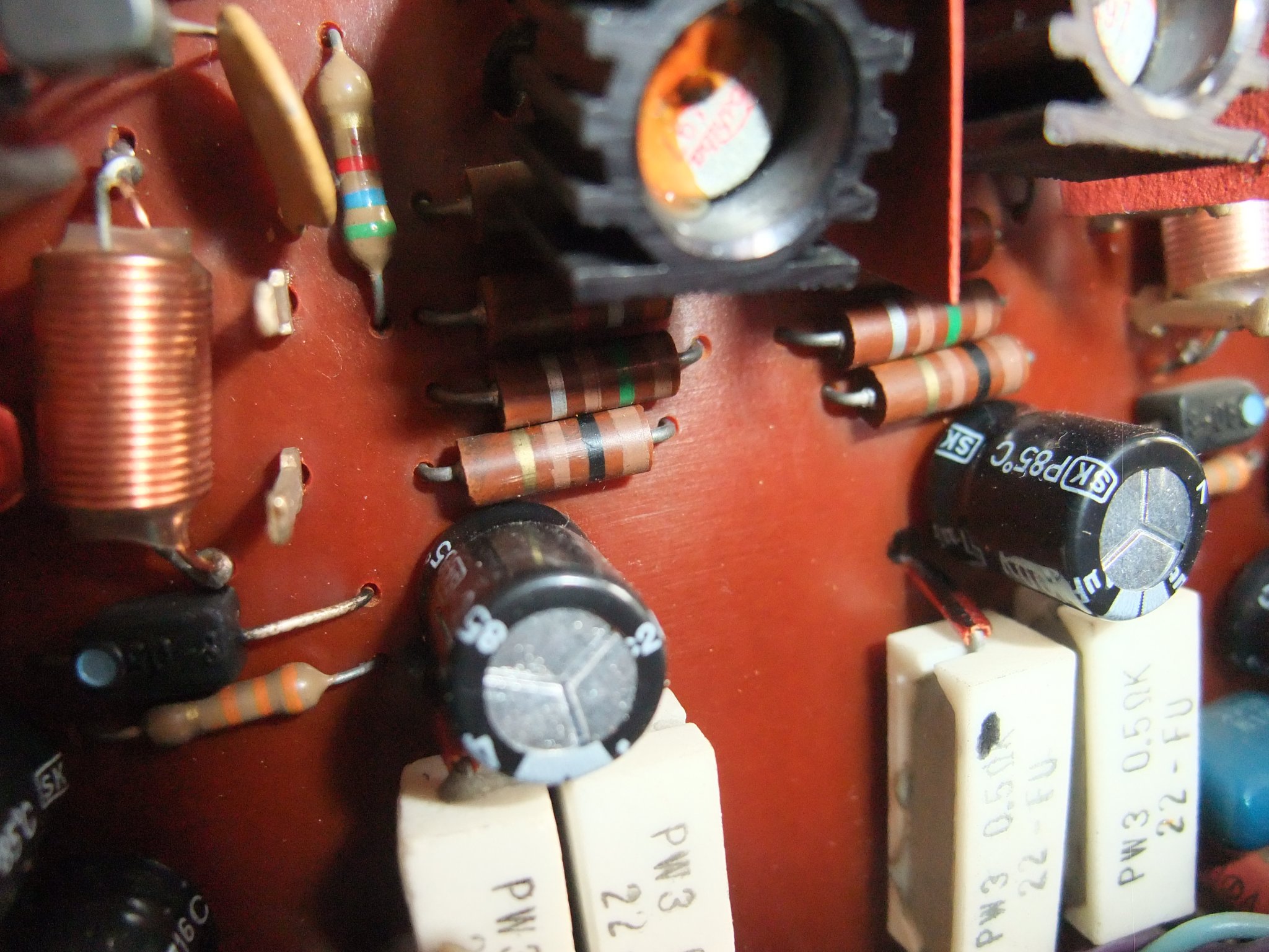

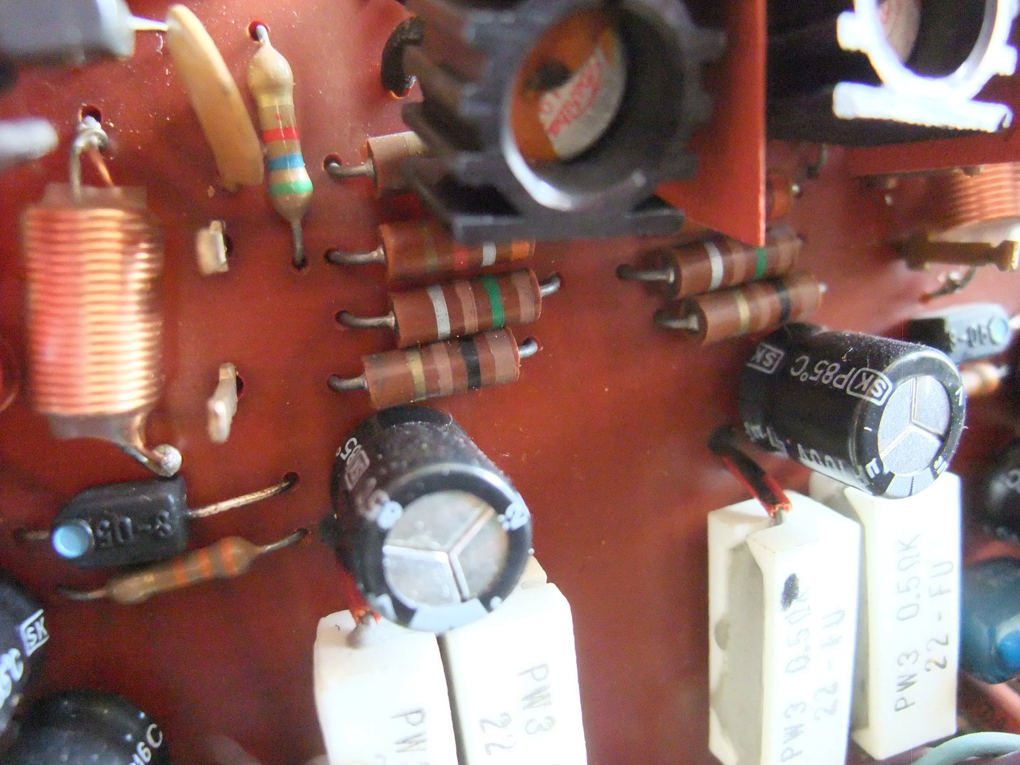

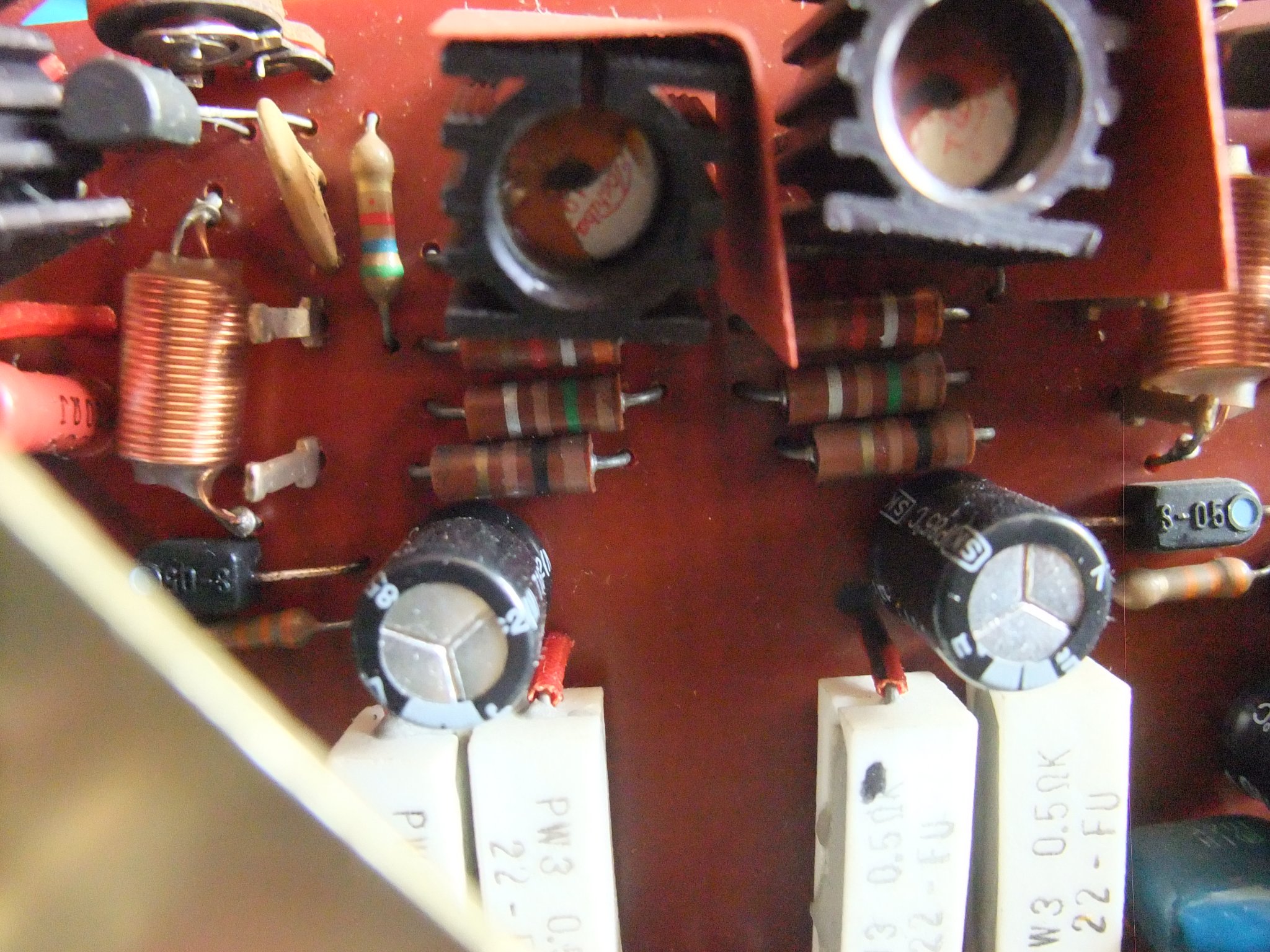

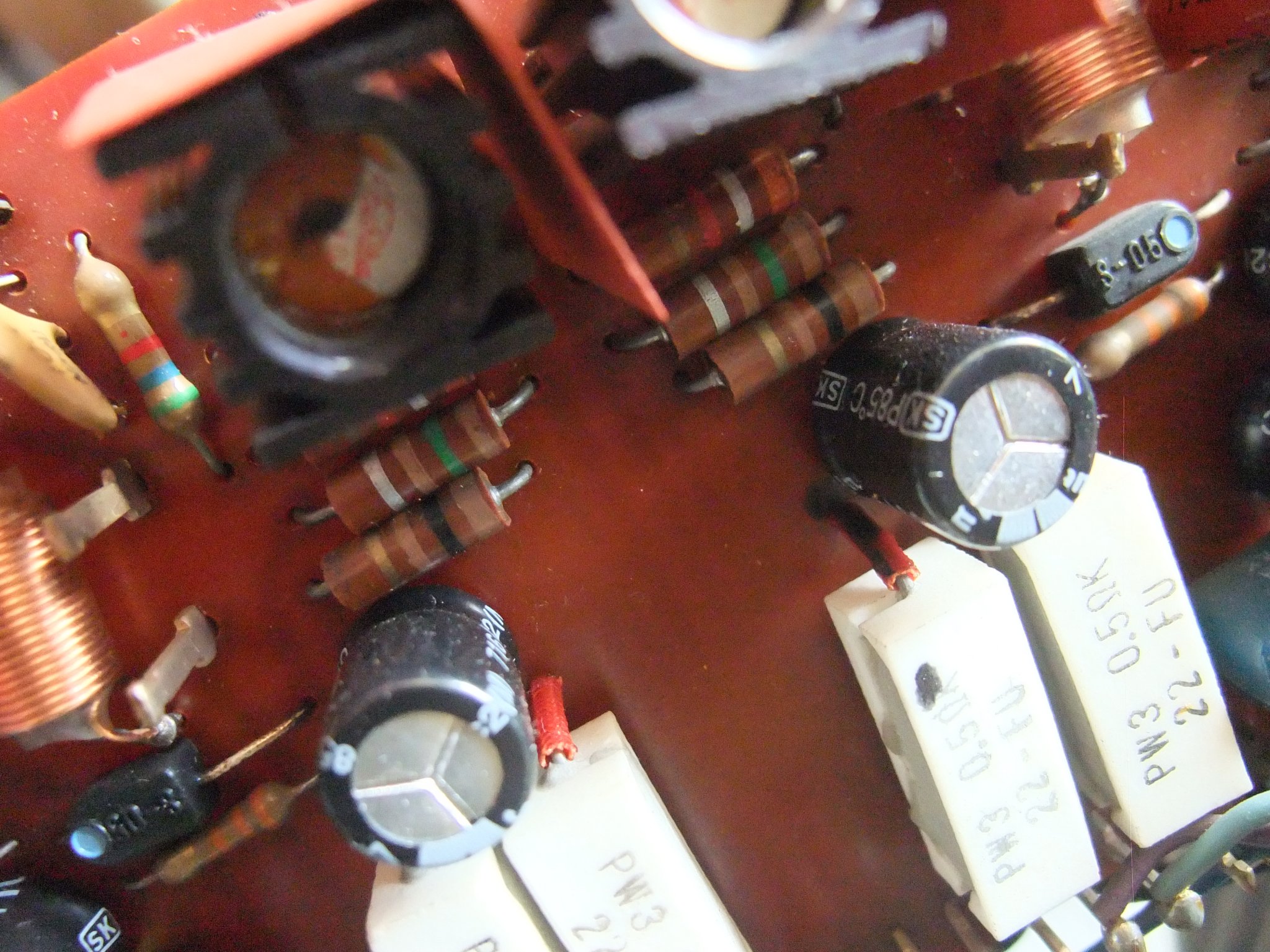

At my device of this model BIAS isn't stable at both channels after warm up despite new variable resistor (trimmer) and small signal TO96 Transistor for Vbe multiplier (small effect and drift between 10mA and 50mA), but not really audible. After replace the resistors from the attached images from pre-driver PCB (2x100R, 2x150R and 2x3K9) this unwanted effect wasn't longer to observe - i. e. idle current through the output transistors is constant after warm up.
What kind of resistors are this and from what manufacturer ?
Should I such resistor versions (mainly to find in vintage stuff) replace in general
even without occurs of unwanted effects ?
Thanks for an advice.
