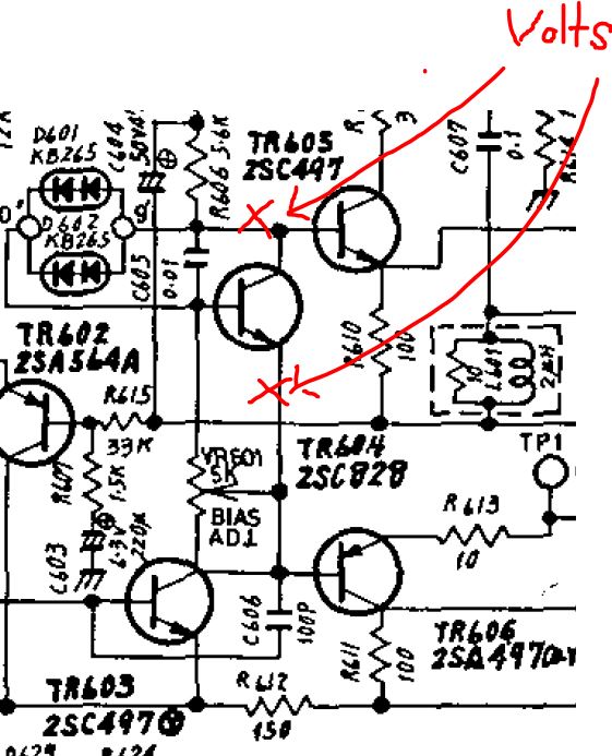

Mooly it is the DC bias adjust measured on terminals TP1 and TP3, what HK calls the Bias Adjustment. DC meter on these terminals with a shorted input and an 8ohm dummy load I get erratic readings with seemingly no control from the variable resistors. Calls for 15mV on each channel. Hope that make sense.
A couple of things to look at and try.
1. Practical problem. Test points can be tarnished and covered in insulating grime. Solder flying leads to the test points and securely connect to the meter.
2. Measure and record the DC voltage across the vbe multiplier as you alter the pot. That's TR604 I think (the manuals a bit hand drawn 🙂) Its the transistor in the middle that connects the drivers together.
This one. It should vary up to around 3 volts as the pot is turned but be careful... if it is working then the output stage will start to get hot as you increase it.
That would be TR602 and TR622 I believe. Measure collector and emitter.

You must measure the voltage across the device rather than from ground to it. Its the only way to get an accurate meaningful result.
There is no way of getting to the leads, real tight in there. Can I go from the solder side or is that going to distort the readings?
Anywhere that's electrically connected is OK such as R606 and C606 etc (just make sure you get the right ends) or across the base of the driver transistors.

No, you are just reading and noting the voltage across that transistor as you turn the bias pot from min to max. If the bias isn't adjusting as you say then we need to look at what the bias voltage generator is doing. The voltage should vary smoothly to around 2.8 volts or so (that's four base-emitter junctions in series, the drivers and outputs, each at around 0.7 volts) at which point the output transistors should begin to conduct and get hot. So if thats not happening then we need to find out why.
This is going to be tricky, holding 2 probes and moving the pot without shorting.
I should then hold the probes across C and E on the device and then turn the prop.
I'll try the helping hands on one probe.

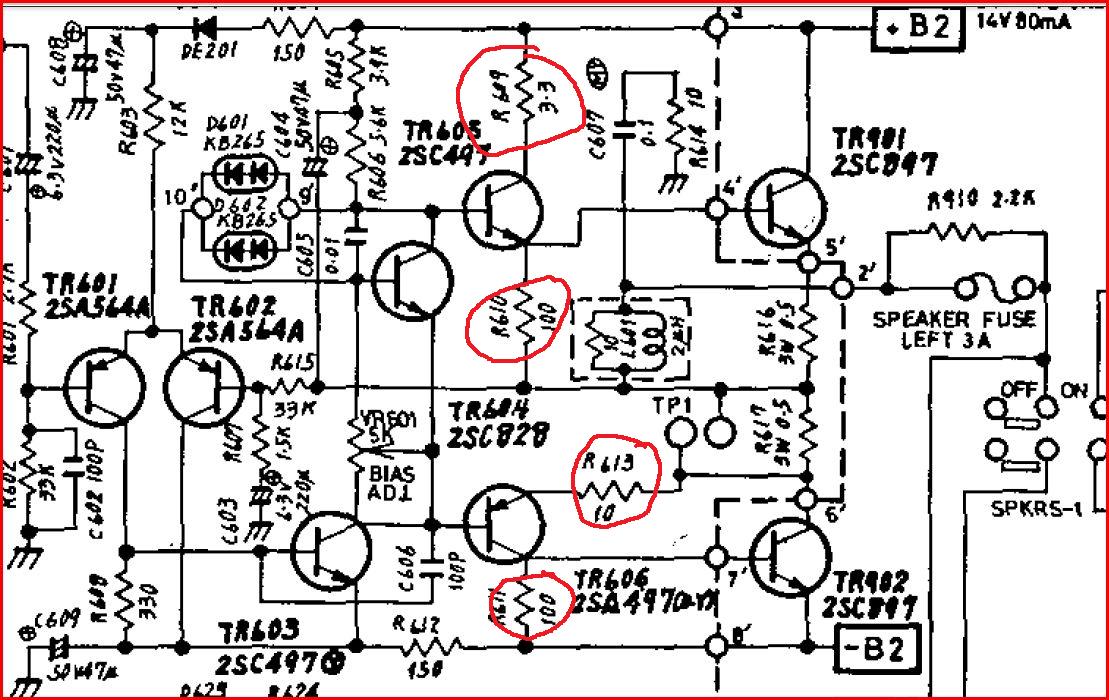

If you are sure of the readings then that is nowhere near enough. Make a note of which way the trimmers adjust and set to minimum volts
Before we look at it closely, has the amp any previous history and have any parts been replaced ?
Reasons for not enough volts.
1. The current in the VAS transistor chain isn't enough... unlikely.
2. There is a faulty or incorrectly fitted driver transistor. Its worth checking the base-emitter volt drop across each. It should be around 0.65 volts.
3. One of the resistors marked is open circuit. If any are then the cause is likely to be a failed driver.
