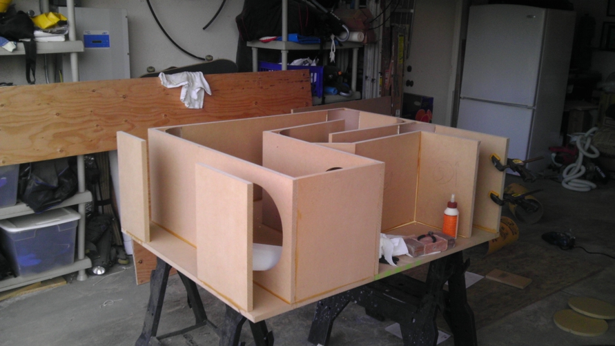

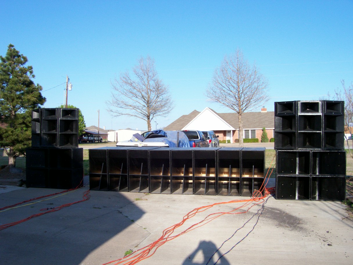

However there is one puzzling trend I've noticed. I see tons of people using vented box designs, but everyone always seems to build the vent into the box via carpentry rather than use some kind of port tube. Any reason for this other than cost?
you will find most of those that you are seeing are more than ports, rather folded horns. They are not just a flared opening, but rather tend to curl around inside to make the port much longer than is achievable going front to back. this way they are able to produce much lower frequencies than typically possible even with reflex designs.
so you can with some effort get pretty decent extension with a fullrange driver
this effect can be taken to extremes for massive Dub-horn or Tapped Horn speakers built into floors that fold the horn many times and are capable of 'the brown note'
With your skills and access to materials you would have good fun with the TH-18 project here on the forum, extensive thread, good measurements
