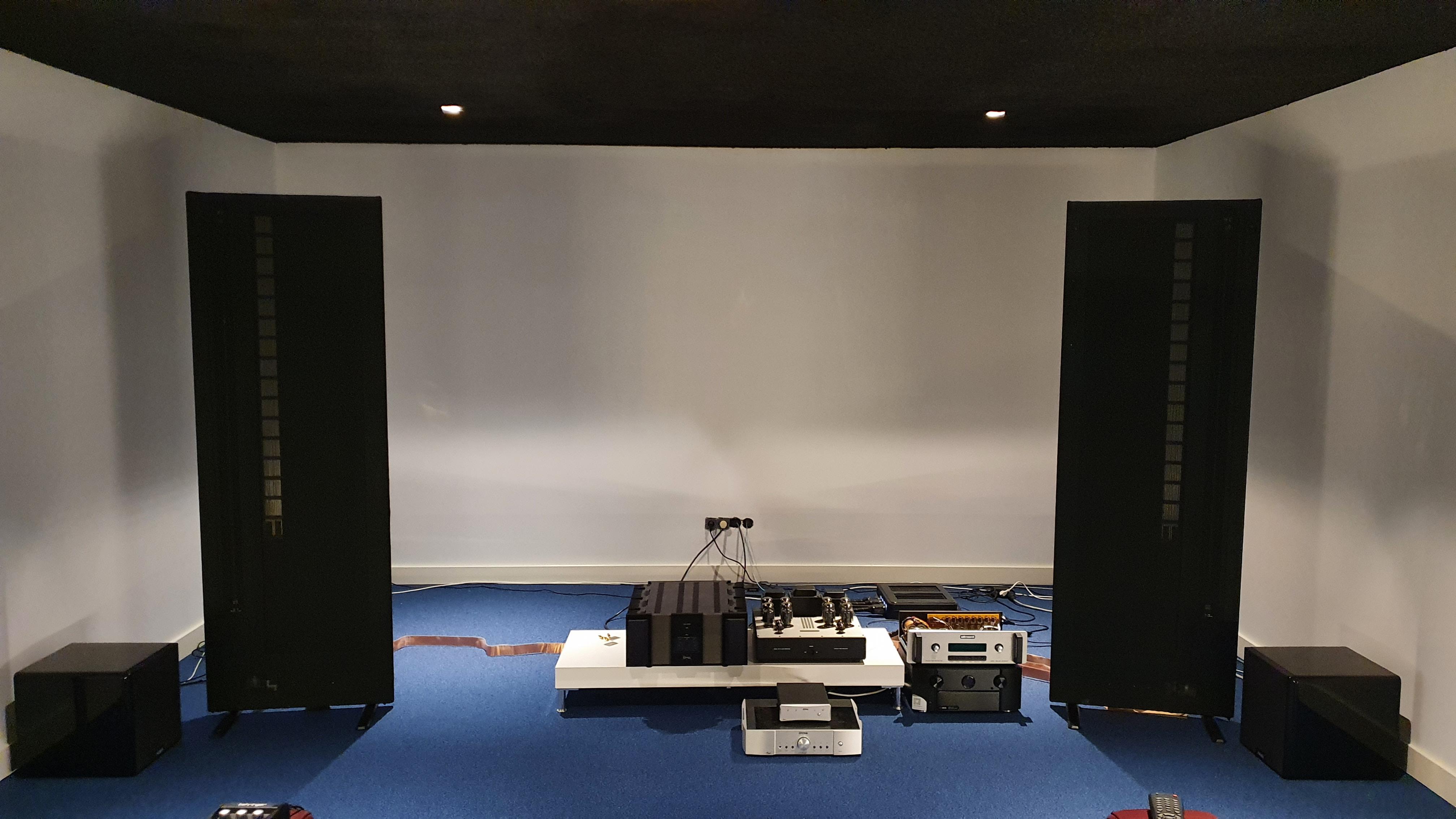

Hello krivium, thank you very much for your posts and information. I really appreciate this! It helps me now I am going to enter the DSP based audio world .
I also did read more about Barry Diament Audio (BDA) and how somebody with his experience in recording, mastering etc. did build up his system to reproduce the sound during recording.
Interesting to so by the picture of his studio he is using more or less the same speaker setup I am using. Like Barry I am using Magnepan speakers but I use the bigger MG20 (who I did upgrade, looks like his are stock and can be much improved), and I also use 2 subwoofers (mine are servo controlled Velodyne subs).
I agree that at a certain point most very good DAC’s are able to provide a very good analog output of the digital audio signal. They can sound different and some you like and some not. In my case I use the Metrum Adagio NOS DAC which I like because of its big nice sound stage and very good low frequency reproduction. They are very well priced and compared to really expensive DAC’s out there.
When I read your last posts correctly you advice me not going in the direction of using 3 stereo Metrum DAC’s but go for an multi DAC to avoid jitter/ timing differences between the 3 DAC’s.
Is that correct?
I read you use the Dolby Lake, I did read Barry is using the Metric Halo ULN-8 (older version).
I also did read people who are using the Lynx Studio Aurora and the Merging Hapi.
The Merging NADAC looks like a audiophile level of product but also expensive compared to the ones mentioned above.
Are you advising to use such a product?
If I move to such a multi DAC solution I also have to check again what kind of output to use from the DSP PC. Will I still use the RME HDSPe AES or is it also possible to use USB or Ethernet?
I have purchased an Acourate software license and soon will start using it with my current system.
I did add an photo of my current system to give you an impression of it.
Initially I had to plan to use a PC with PC card like the RME HDSPe AES to output 3 AES signals (low, medium and high frequency) out of the PC and use 3 stereo Metrum DAC’s to perform the DA conversion.
I did read people advising to use a multi DAC with 6 or 8 channels (like the Merging Hapi) to perform the DAC because this would lead to better performance.
For me at this moment it is not clear why this would be better.
The Metrum Adagio I have now is a really good very analog sounding DAC which I expect will perform better than the Hapi regarding DA conversion.
I just want to understand why a “lower” performing 8 channel DAC like the Hapi would be a better choice. Is anybody able to explain this or has anybody experienced this in practice?

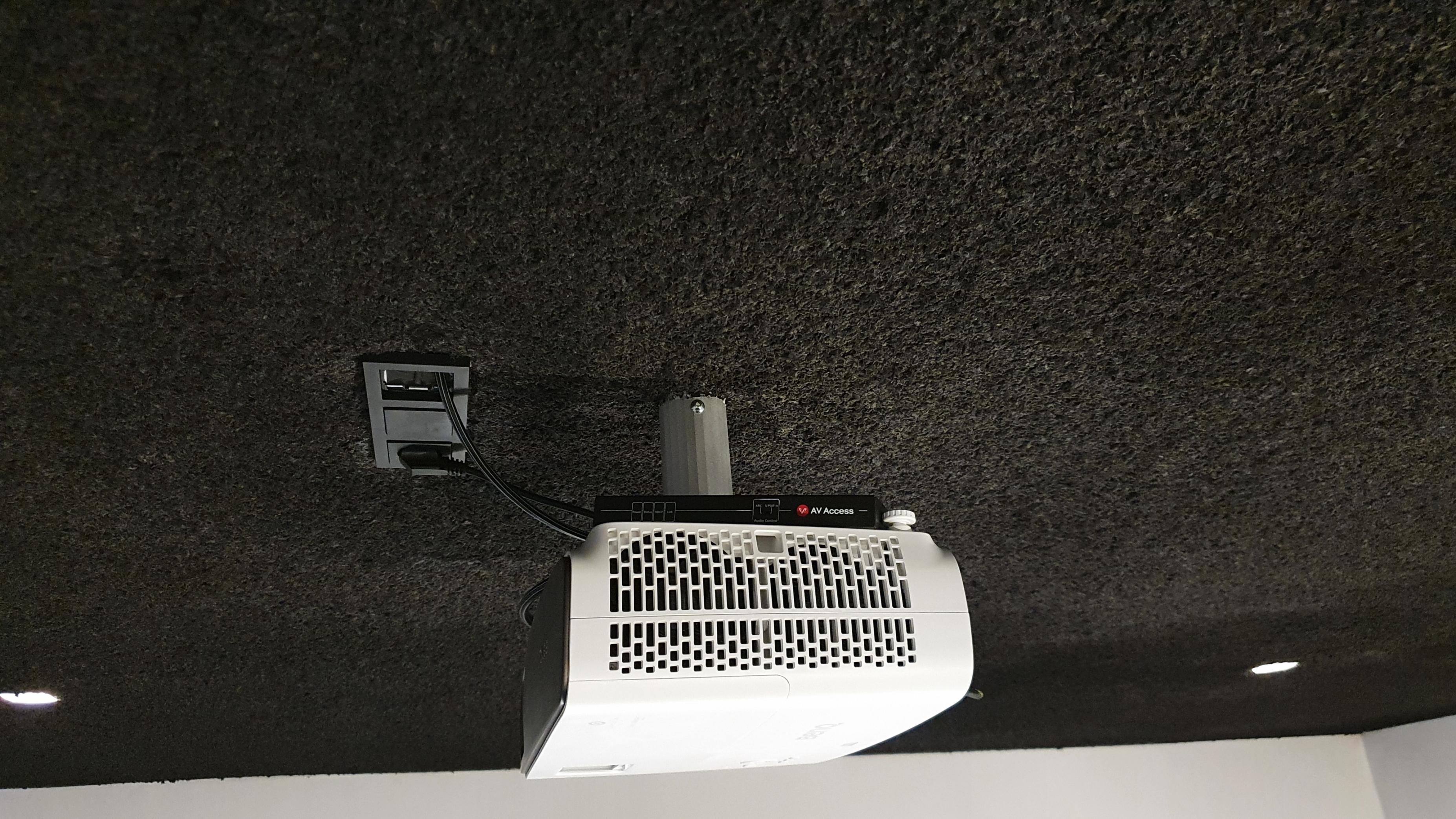

I also add a photo of the “acoustic” sealing I have. On the photo also my 4k beamer which I use to beam on the wall behind the Magnepan speakers (wall has special paint to beam on). It consists of a mixture of paper and glue that they spray against the ceiling, which is available in several colors.
Based on the photo, your listening room is highly reflective on the walls (& likely ceiling) and has comb filtering effect on the floor due to carpet. You would benefit greatly on sound quality by working on room acoustics (absorbers, diffusers, bass traps). It will be many times more effective than spending time and money on DAC. In other words, you have a priority and it sure isn't jitter level in DAC.
Hello Evenharmonics and Markw4, thank you for your feedback!
I totally agree that it should be possible to improve the room acoustics by applying damping and diffusion. In parallel with the study how to setup my software DSP and what DAC to use I will perform new measurements with REW and try to interpret what to improve regarding room acoustics.
