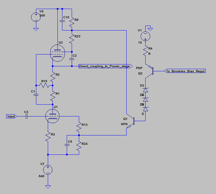

The plan is to first adapt a pair of Salas HV shunt PSU on the driver and also adapt a Broskies type Auto-Bias. The bias regulation will read the bias current on two low R resitors between primary windings and ground and symetrically act on 6AU6 screen voltage and 6SN7 cathode voltage to keep the same idle current on the Mu follower whatever the bias voltage.
That's where I'm in trouble, I'm having a hard time to find comlementary BJT able to regulate with a few mAmps (2 to 5) with up to almost 600V across them. Most of the HV trans easily available on the market (mje15034/mje15035 ; MJE340-350 ; KSC3503/KSA1381) have a VCE that hardly goes over 300V. So the only way to use them would be to share the voltage across two units.:confused:
There's switching devices that go higher in voltage and current but I'm not sure they would fit to the purpose. Are we going into a penury of High voltages linear transistors ? Power mosfet may be a solution but for a few mAmps ?

I was looking first for a complementary pair of HV devices to act on both ends of the driver but I didn't know that HV trans in P flavor are rare as BJT (but all are switching devices and SMD package) and simply doesn't exist as MOSFETs.
Anyway, I better switch to a single ended design with a NPN across the 840v of the driver's Voltage supply. Thanks for the zener stack idea, it will allow me to drive it with a NPN with lower voltage capability. Something like that :
As for the term "Linear", I referred to some datasheets that oppose linear applications to switching. I did not know much what it implied but thought it would not be good to use high power switching devices for small current DC regulation.
Give us a schematic (even simplified) of what exactly you have in mind and we will find a way to do without Bjt's :D
One post up. ;)

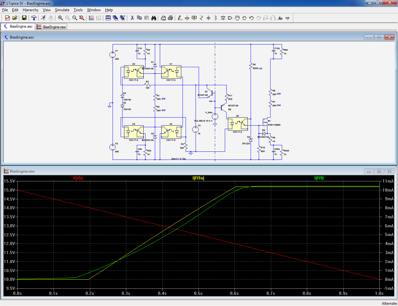

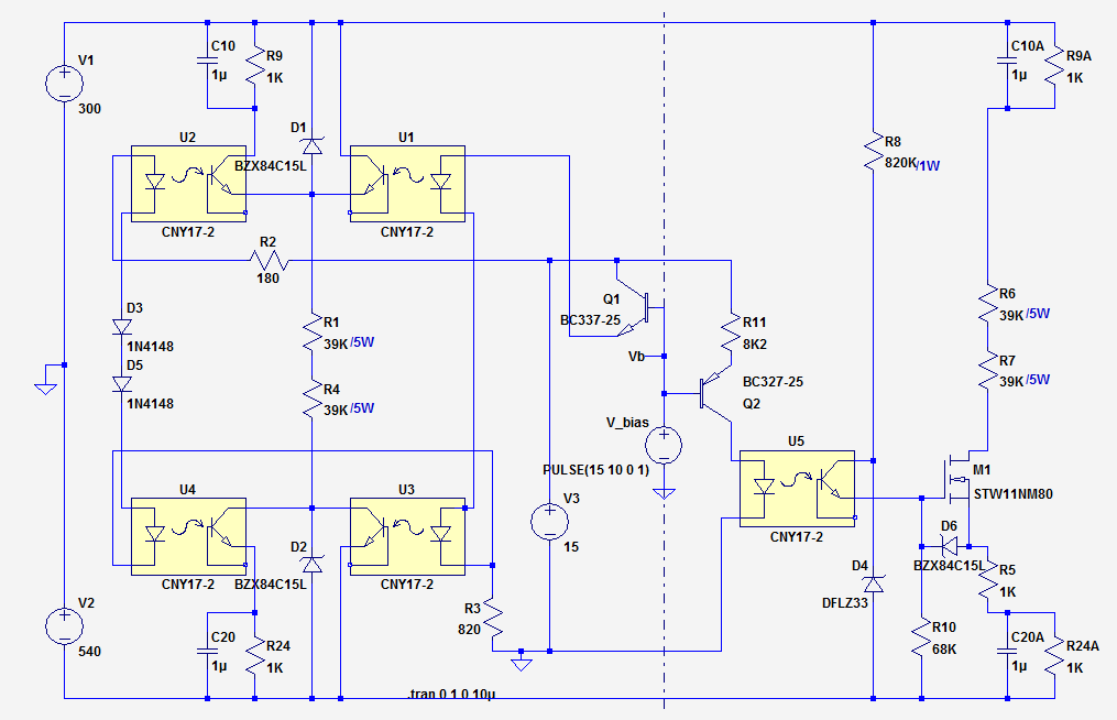

Ok, here are two ideas, based on opto's: first is opto-extremist, 100% opto, second is hybrid and uses one opto and one MOS.
Topology and values have been dimensioned to ~suit your apparent requirements (I don't have all the info). You can easily correct the gain, offsets, etc yourself.
Note that even if some BJT's are available with a Vce in excess of 1.8kV, the SOAR shrinks to zero beyond ~500V, making them useless for linear applications.
MOS are better in this respect, and you can easily find a 1kV NMOS perfectly usable in linear regime
Thanks, that's an elegant and efficient solution while the "hybrid" one makes more sense to me.
One question please : While the base of the opto's output transistor is driven internally by the led, why is the base available and not connected on the output ? Is it a possibility to establish a quiescent current in case of AC connection on the input ?
I expect to draw between 1 to 3 mA on the HV trans. There's almost always some room for such a small current next to the max voltage on the trans I had a look to. I can also stick a resistor on the collector to decrease VCE as you did on your hybrid solution.
The choice between BJT and mosfet would be about reliability. I have no idea on parameters or safe design to look at for such a choice, beside I always heard MOS as being "sensitive devices". Same for optos a few years ago, while it looks like they can be very reliable devices now.
I do not see clearly what you exactly mean: the photo current is generated in the B-C space, and contributes to the base current, but also to the collector and emitter currents, since you see the device as a dipole when it's open base.
If you connected the base to the output, you would change your transistor into a diode, having a Vbe only marginally influenced by the light.
The base is accessible for other purposes: for example, in the first part of my schematic, I have included 15V zener diodes to clamp the maximum voltage in case something goes wrong (15V supply lost for example).
With a bit of ingenuity, you could replace the zeners by dividers going to the bases, but I didn't do it, because you have to be careful not to shunt the photocurrent during normal operation, and this could be quite delicate: I opted for the simple and safe solution, but anyway, the cost to be gained by replacing a single zener by two resistors and probably a diode seems minimal and not worth the trouble
