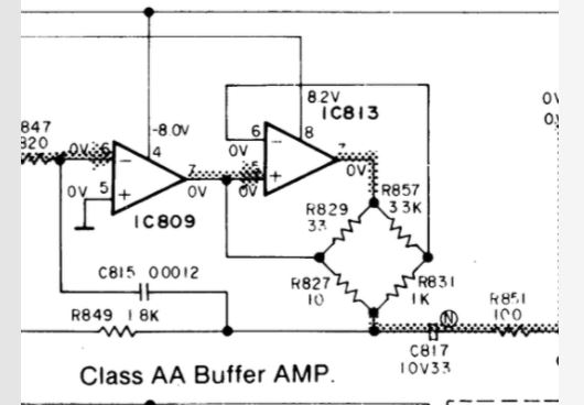

Disabled Account
Joined 2015
This is class AA buffer of Technics dating the precedent century.
895466d1605982987-lm1875-technics-class-aa-buffer-jpg
It was used in CD player output. The principle is far different than my multiplier. The opamp simulates a negative resistance in proportion to the main's resistance, if they are equaled the driving opamp sees the load infinity. If it simulates half of it, the two share the load. See applications The LM1875 for best
Mine is much basic. In fact I asked with class AA type to be given a star if like, only one reader gave, so I remembered Faux French saying , The diy's need to understand how the circuit works. This why I created a simpler than the class AA.
