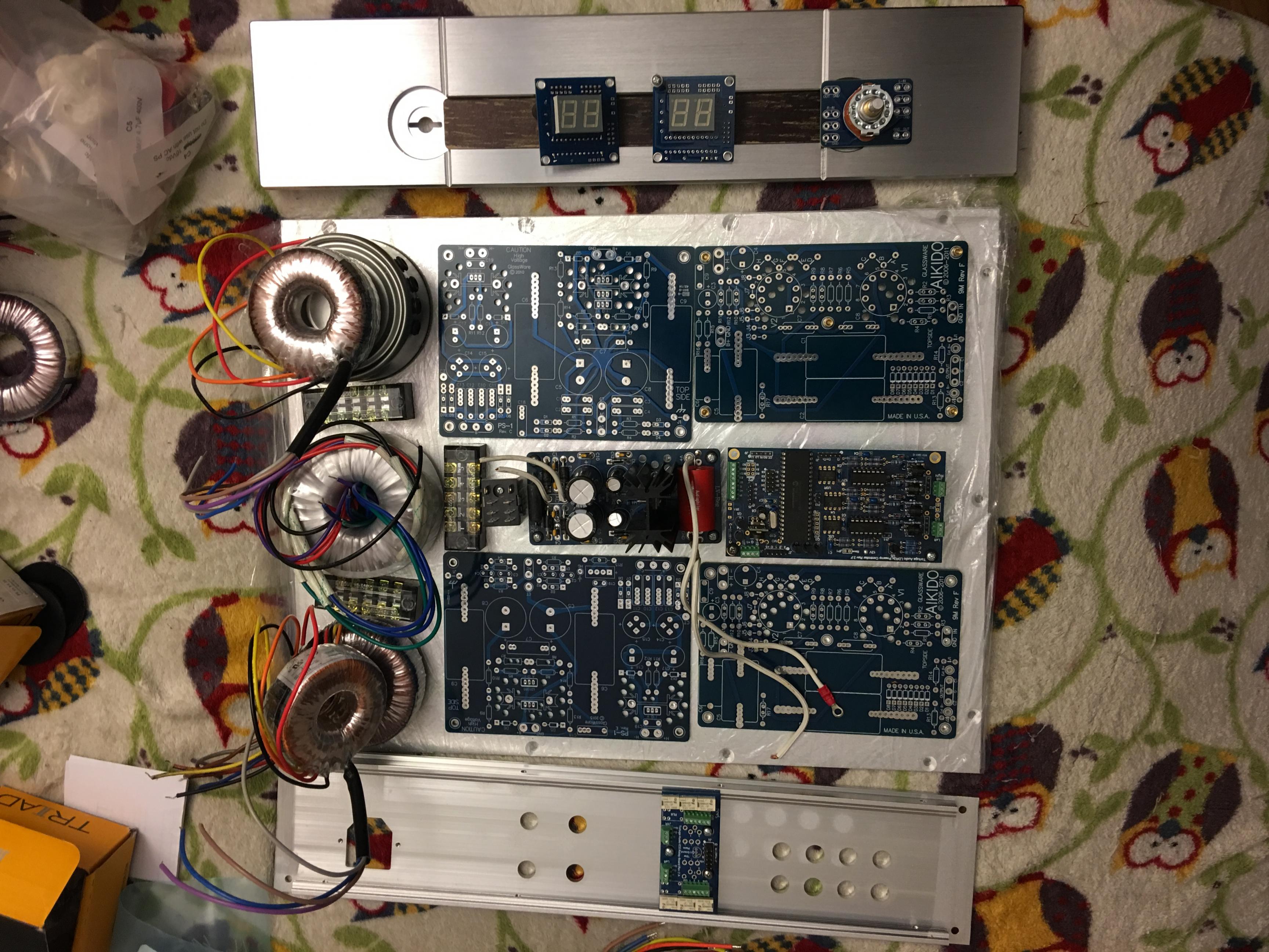

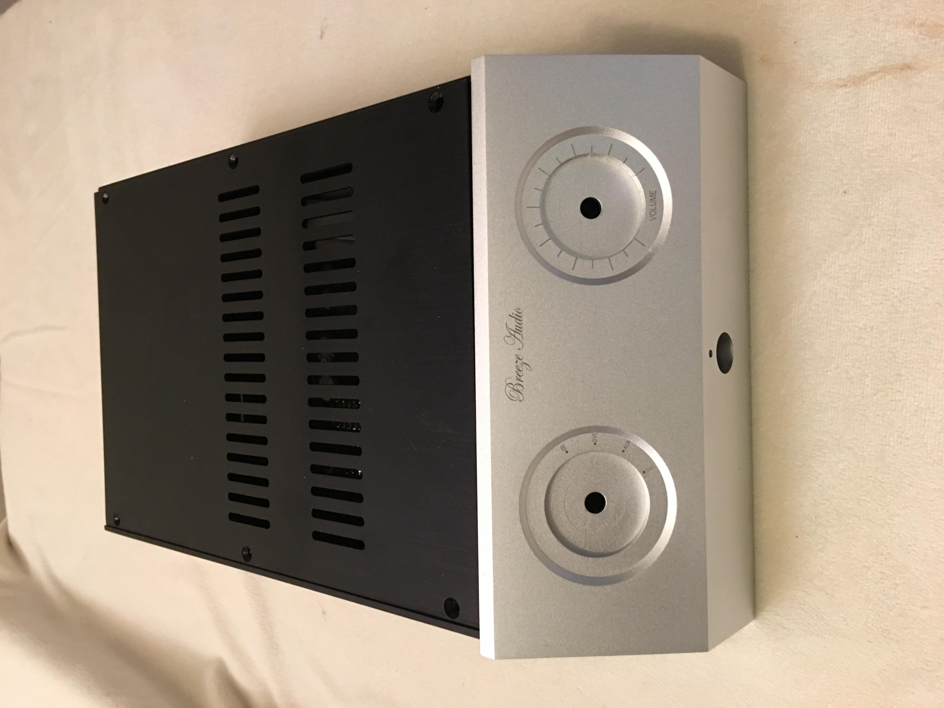

Full dual mono Aikido preamp with adjustable impedance Tortuga LDR attenuator & remote
I'm calling this a full dual mono because it's got a pair of 9-pin mono Aikido line amp boards from John Broskie, each powered by a separate power supply board (PS-1, also from Broskie). Each power board provides separate high and low voltage DC supplies for B+ and heaters, fed by separate high and low voltage toroidal.
The Tortuga LDR modules provide remote control, attenuation, source switching and the front panel LED displays, and are fed by a separate 12V power supply (LV-1, also from Broskie) and 25VA transformer. Power to the Aikido boards is controlled by a 12V trigger (there is no external power switch). Also, that's five donuts.
This preamp will run four 6CG7 tubes, configured for around 20 dB in gain. I bought an aluminum chassis with predrilled holes off eBay. There's not a whole lot of room inside the case, and the boards have been positioned to keep heatsinks and tubes directly beneath the vents in the cover. I may have to vent the bottom as well. Because the vents run along the left- and right-hand sides of the cover, one channel's Aikido and power supply boards will be stuffed and mounted upside-down to maintain symmetry and keep the tubes and heatsinks positioned under the vents. I may regret this when it comes to troubleshooting.
The case came with two knobs, and I only need one to operate the encoder input to the Tortuga board. The other knob, I may just attach another encoder and let them both do the same thing. I've also thought about putting an output capacitor selector there, but that would involve running signal from the back of the unit up to the front and then back to the back panel. All the signal input, manipulation and output is currently done at the back of the unit, and all the donuts, power supplies and controls are at the front.

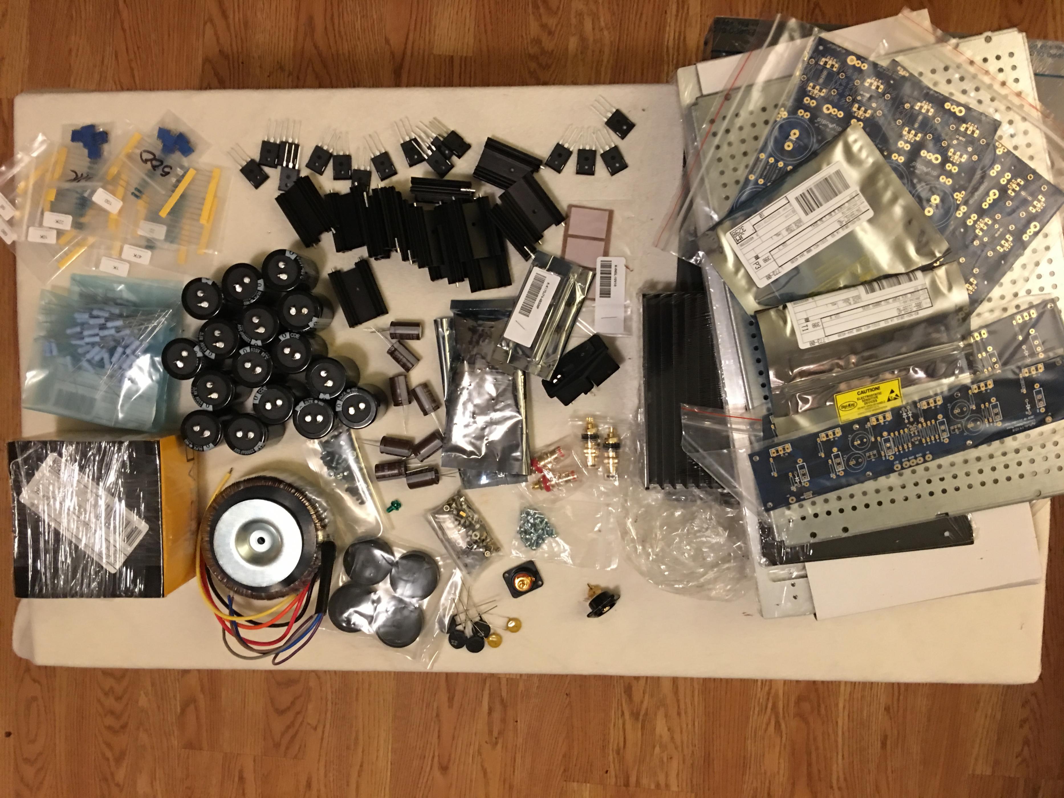

Pair of Nelson Pass F4 "Wild Weasel" edition full dual monoblocks
Also known as the "so you want current?" edition. The name "Wild Weasel" is a reference to the electronic warfare missions my dad flew in F4 Phantom jets when I was a pup. I'm calling these full dual mono since each monoblock has two separate power supplies, each fed via 250VA donut and carrying 4 x 22,000uF in capacitors per donut. These will live inside a pair of diyAudio 4U "jack of all chassis” cases.
The hope is that the Aikido preamp plus running each F4 in parallel mode will give my Magnepan speakers the voltage gain and current they crave.
The preamp case has two sets of output jacks. (Most likely this case was for an integrated amp and the outputs are supposed to be binding posts.) And the Aikido boards have two separate output capacitors each, suitable for driving separate outputs or selectable tone. So I am going to experiment with putting different capacitors on each output, and then running those outputs into each monoblock.
It won't be exactly parallel, each half of the F4 would see a slightly different signal instead of just jumpering the inputs. But the outputs will still be tied together. How will it sound? I have no idea! Will it blow up my F4? I sure hope not! I'm betting it won't!

The preamp, in one of many Tetris-like incarnations before the current final layout.

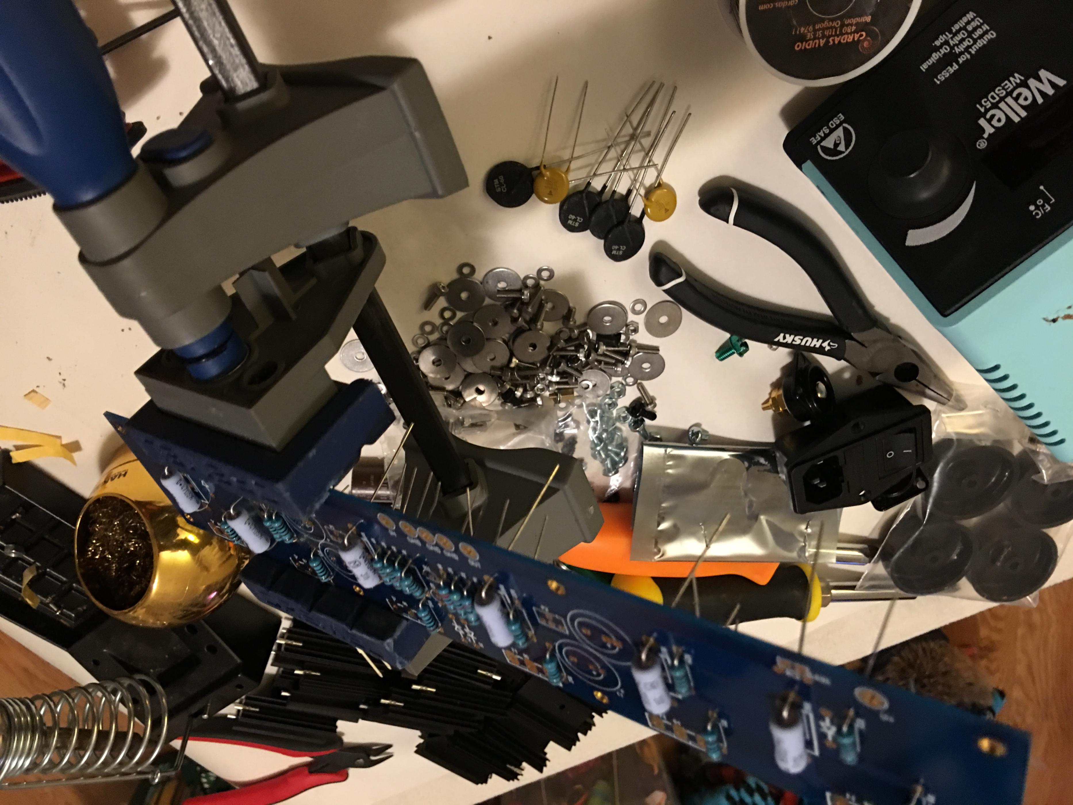

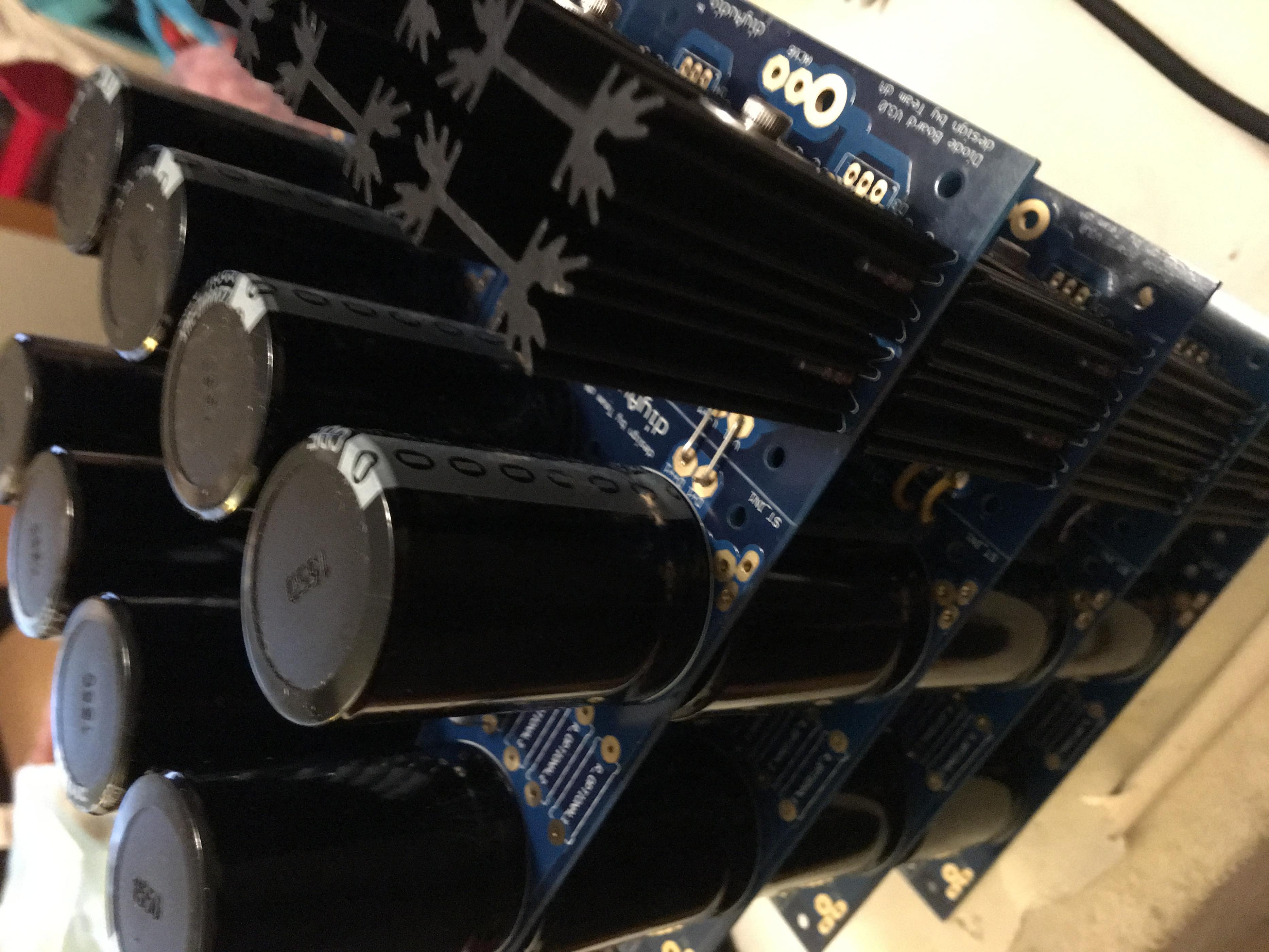

It's an F4! Well, the pieces for one, anyway. I miscounted the capacitors in my post above. I think this amp is like 85 percent power supply at this point.
This one is going to be the Wild side. The Weasel side will be the same except the transformers are Avel Lindberg instead of Triad.

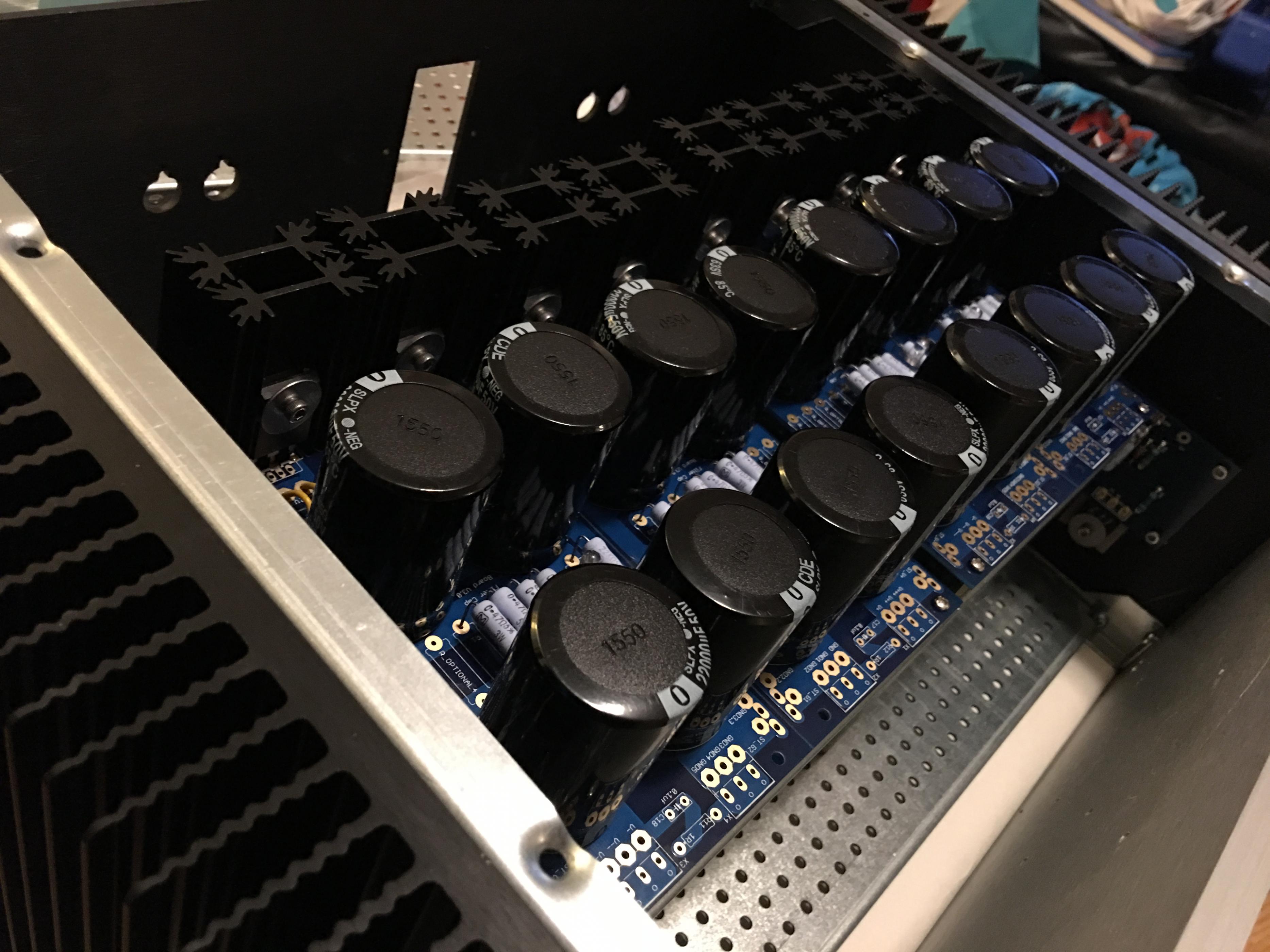

I ran out of parts, I have yet to apply current to a single circuit, but Ampsgiving 2016 has been a complete blast. I ended up swiping parts from the Neurochrome amps, so now I've got two projects to resupply. And really, that's got to be at least half the fun, since it appears to be where I end up spending 90 percent of my time...

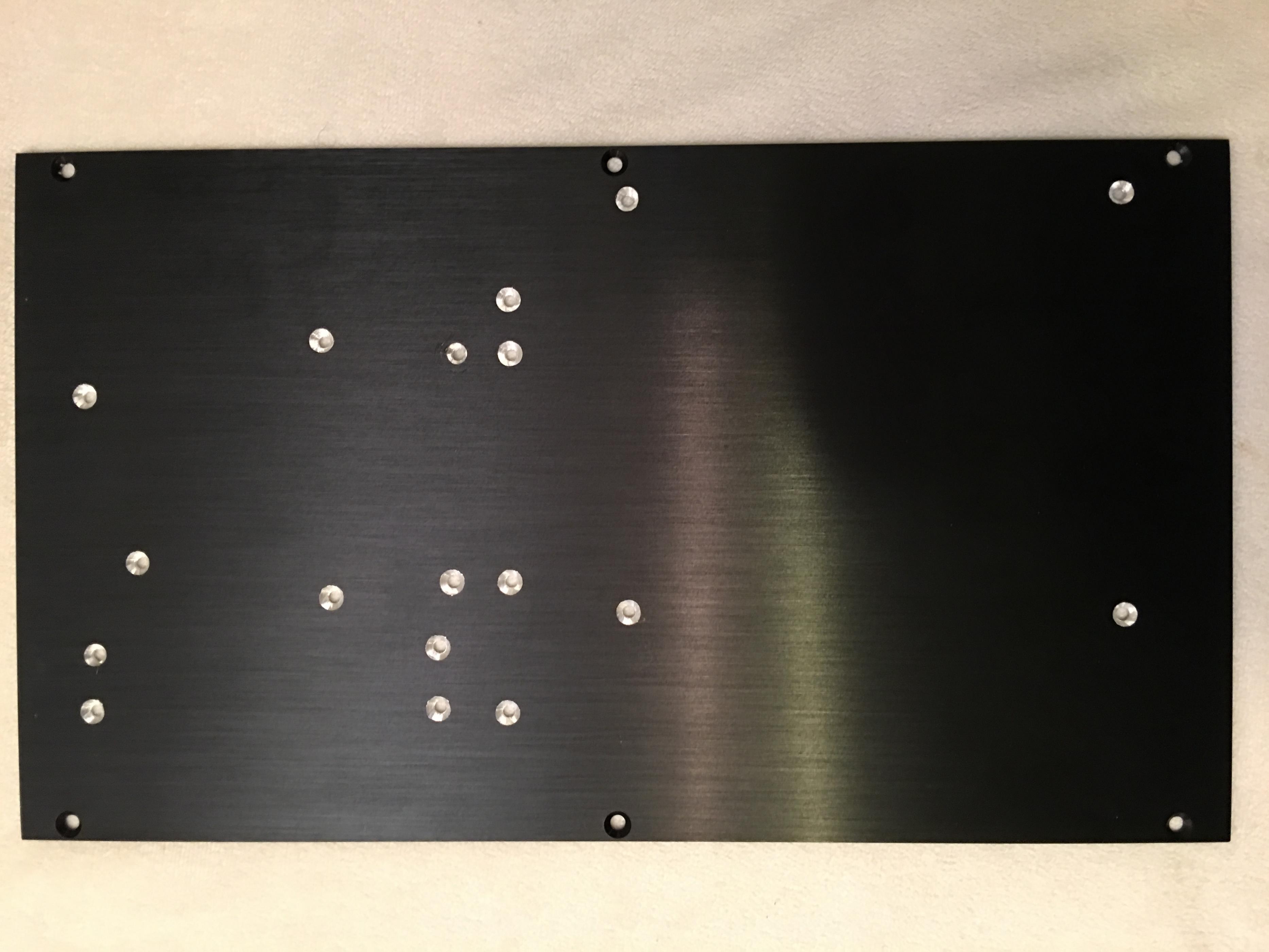

If you only put two per chassis it fits better, so no tower of power. The eagle eyed will notice the back panel has some issues regarding orientation. There are good reasons I've decided to go with unscrewable everything rather than soldering connecting wires. I've got to be able to go back in there and fix all the terrible mistakes I'll probably make.

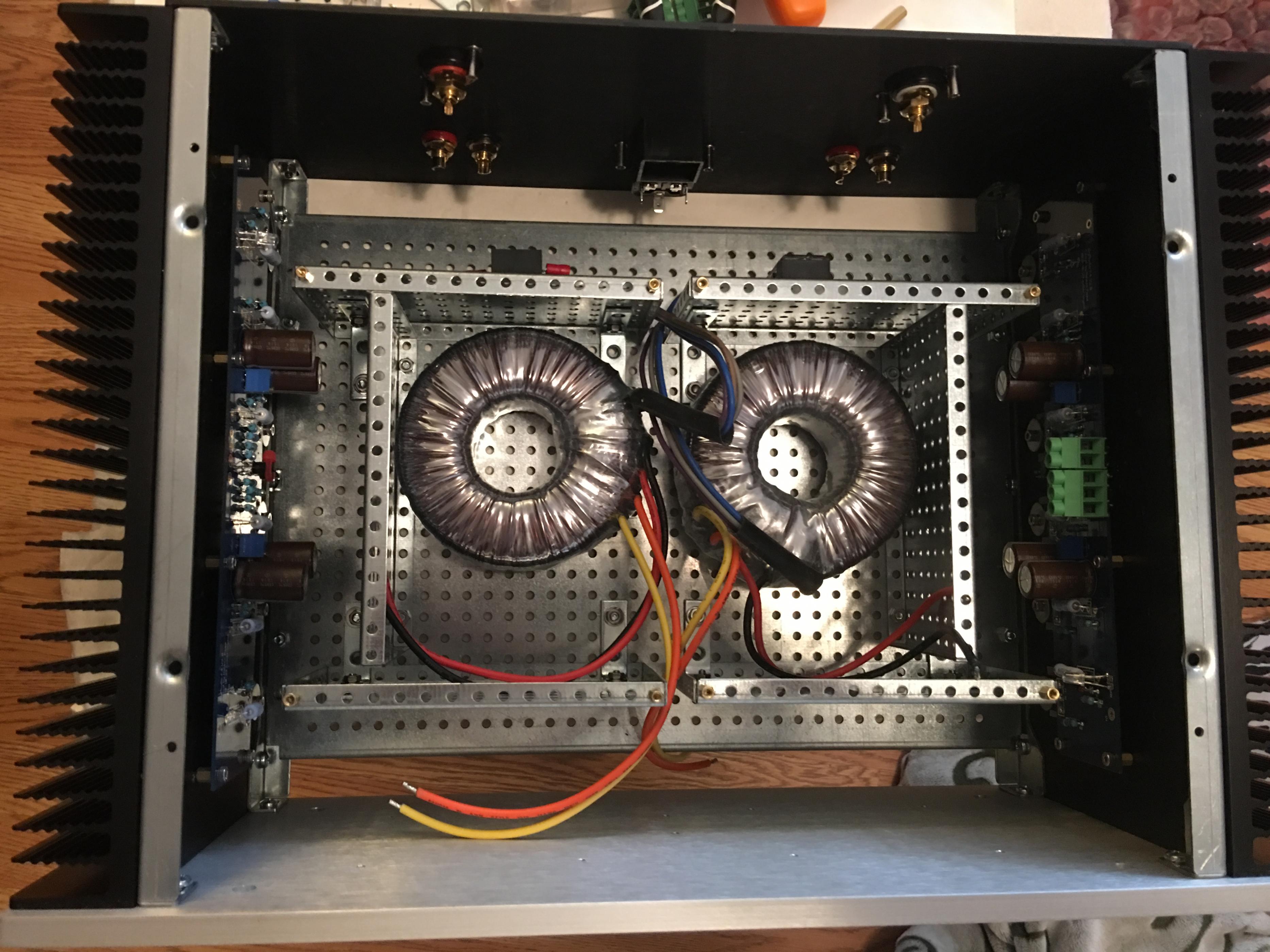

The power cage! This mostly supports the power supply boards, but the little risers from the diyaudio store remind me of erector sets, and are as much fun to play with, I couldn't resist adding a couple non-load-bearing pieces for, um, improved "shielding." So now I need to order more for the Weasel side. (I am still building two of these, I swear.)

Also, while you CAN cram a set of mono Aikido boards and associated power supply boards and their associated four additional toroids into a diystore 4U chassis in addition to a dual mono F4... it doesn't mean you should.
