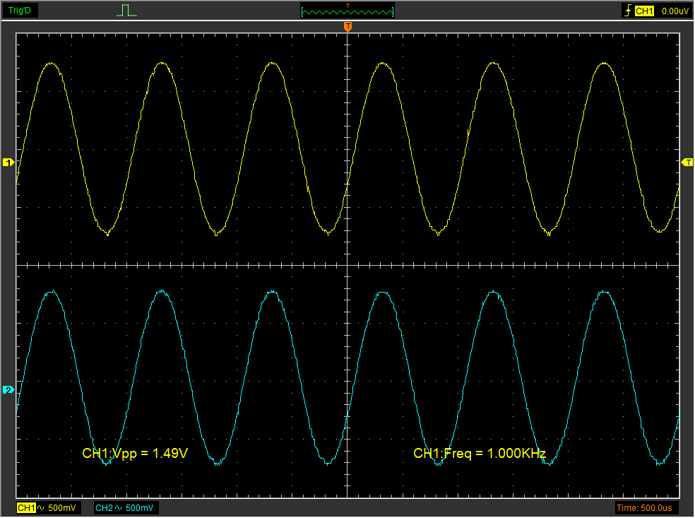

I tried its PC software today. Can be downloaded at the manufacturer's site. Has nice features but updating slow. Every one second or so. Alright, its nice seeing it large and allowing more measurements or math functions etc. but not good for real time refresh. Most practical aspect is it can save a screenshot I guess. Such as this pic where I fed its scope inputs with sinewaves from a dual channel bench generator.
