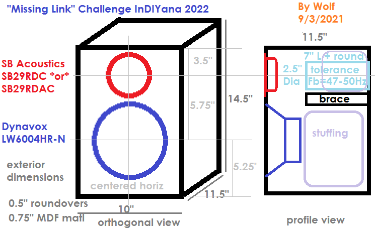

About the VersaBox...

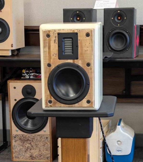

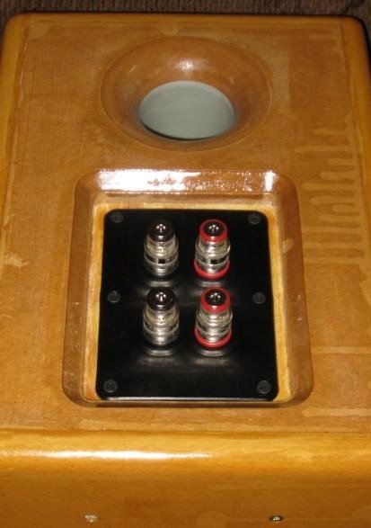

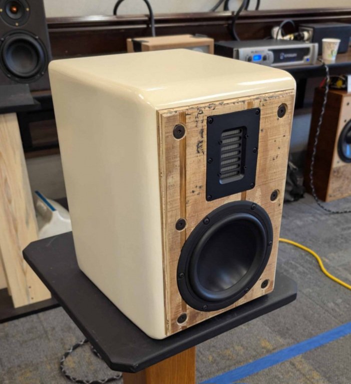

It's a fairly basic 15 liter vented box. There is a rear port with grey 2.5" electrical conduit. One solid shelf brace connects the rear and sides for about 2/3 of the cabinet depth, ending just below the inner port exit. Fb is fixed at 47Hz, yielding an F3 of 44Hz, and so far has been a really good place to tune these cabinets with good results in all of the builds used herein. The front baffle has a 3/4" deep inset mount for an interchangeable baffle which is secured with 6x 1/4-20 furniture style hex-drive bolts. All edges have a 3/4" roundover, and the port has a 1" roundover on the exit.
The baffles were originally going to be textured black/white cutting boards, backed to make up the thickness required. Upon looking for the backer pieces, I found a piece of 3/8" thick T111 tongue and groove plywood siding that I had forgotten I had. It had apparently been laid face down and used as a spray paint base or platform at some point. Since the Dayton drivers are purportedly 'Amazingly Affordable', I felt a well implemented piece of scrap wood would give these a very unique aesthetic against the gloss white the rest of the VersaBox cabinets bring to the table.
If you don't read these for woodworking information, skip this next long paragraph about woodworking....
This board had obviously seen better days, and wasn't thick enough for the 3/4" deep recess, but there was enough of it that I could use it with mirrored inherent grooves on left and right adjacent cabinets and have enough for both speakers. I used a piece of 3/4" ply as backer for both, resulting in 1.25" thick boards. Once that was glued, trimmed to width size, and deemed still usable, I gave it a light sanding and used the shop-vac to remove any dust debris or dirt. The board had a void that travelled from one side of the baffle to the other about 2-3 layers down from the face on one end. The middle was riddled with worm tunnels, which my thought was to save as much of at this point. Spalted/Wormy wood always costs more, and it provided a path for stark contrast against the tone of the pine plywood. I made my cut to separate the then conjoined twin boards and salvage the majority of their former pesty lunch travels. I then used West Systems epoxy and some tongue depressors to remedy the void, which involved applying tape prior the pour, and then applying tape on the face after poured because the epoxy was finding gaps and feathering through the surface. It came out okay luckily, just had more fill in some irregular areas. Then I applied a very light coat of the same epoxy to seal the board surfaces using a fake-advertising style fake-credit-card that came in the mail. It allowed a very thin coat and solidified all of the loose or soft fibers in this aged board, and only filled the work channels minutely so they could still be filled with something else. Sanded and vacuumed yet again, followed by a small chamfer of the face perimeters, and then driver rebates and rear-side reliefs; I came upon a Youtube vid channel I had been watching periodically by Four Eyes Furniture. He was using black glue-sticks in a hot-glue gun to fill voids in a table, setting 321 aluminum blocks on them to cool, scraping off excess with a chisel, and then a light sand to finish it before his final resin coat or epoxy. I thought I could use this to enhance the spalted lines' visibility as contrast, and it worked rather well. I used an old heatsink and pressure since they weren't as heavy as the 321 blocks. I would recommend the low setting on the glue gun, as it is easier to use without drips or stringy problems. I got the glue sticks at Home Depot under the Ryobi brand. Another light sand, and that is where I have them at the moment. They are due to be 'epoxy-carded' one more time with sanding to follow in finale. I hope to be able to leave some texture to the boards as they have a good feel to the touch as they are.

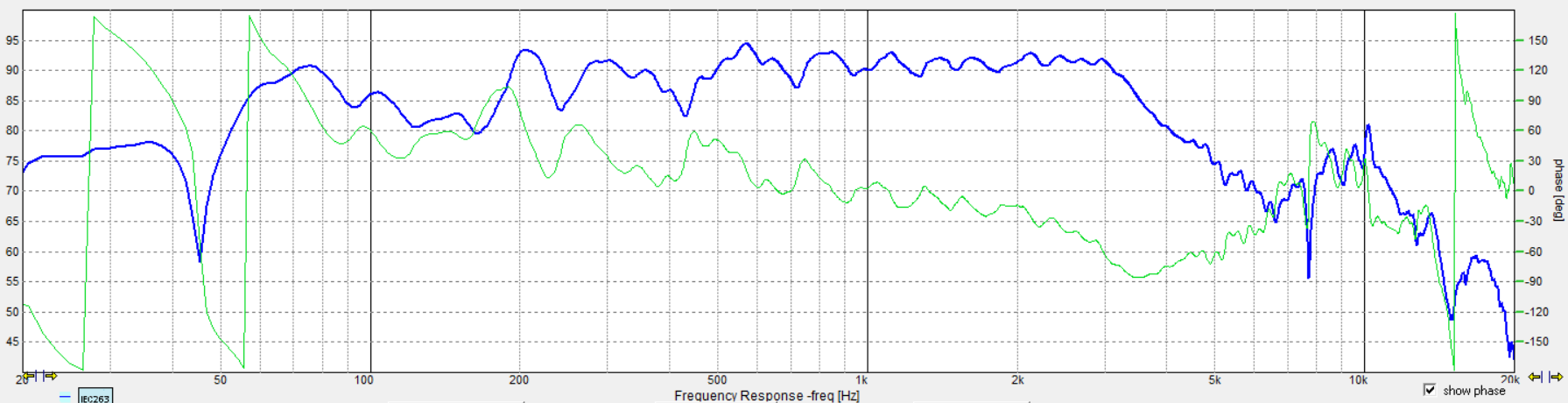

The drivers' characteristics....

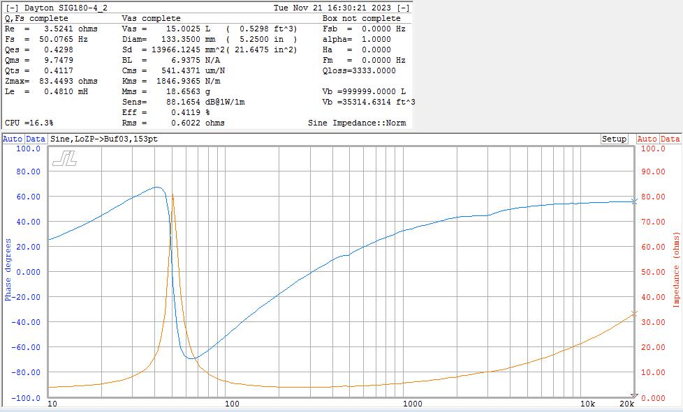

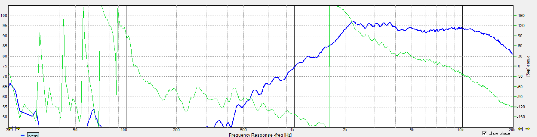

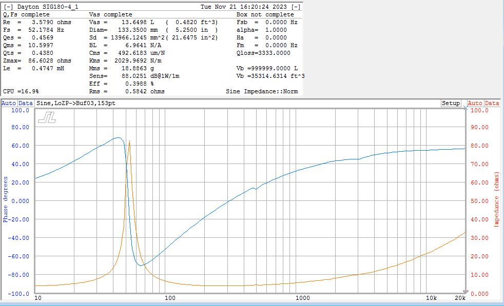

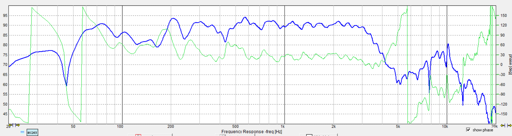

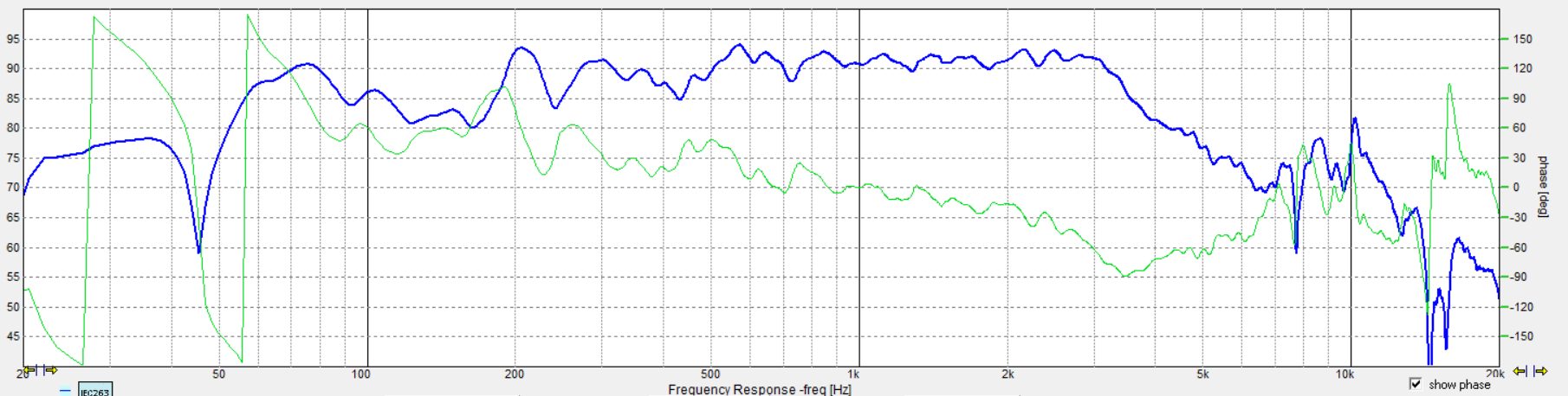

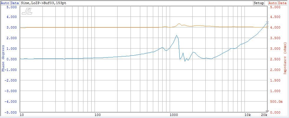

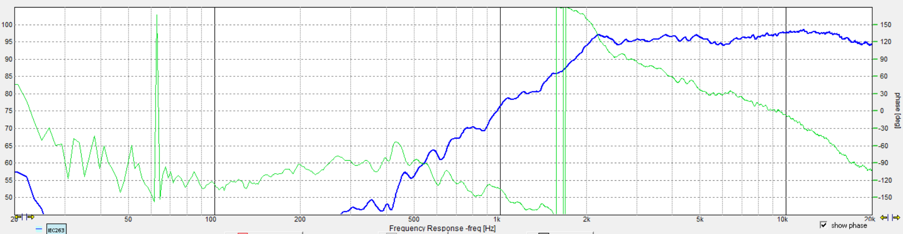

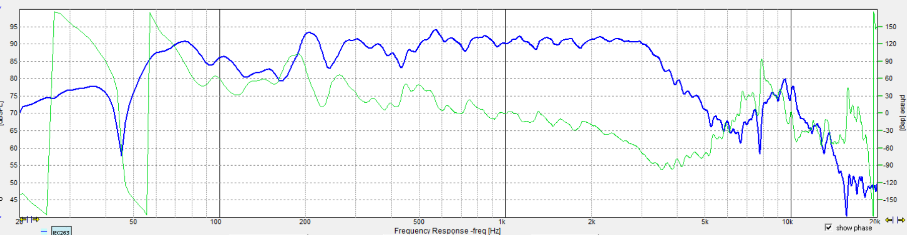

Measuring T/S of the SIG180 woofers, I had a Qms much higher than spec initially. I then remembered to remove the packaging plastic from the backplates and did it again. I still had Qms considerably higher than spec. Even so, the T/S was manageable in a modest box volume, and yielded an F3 that was low enough to be accepted. Doing an impedance sweep with tones for the most part was fine- until the breakup region hit. These drivers have had some lengths taken to try and minimize the magnitude of the aluminum cone breakup areas. As I believe I've read, the voice coil former helps to damp the cone due to the material used. Looking at the frequency response in the spec sheet, the plot rises to a very broad plateau and then dives like an expert in a swimming contest. Due to the assembly as designed, it is hard to tell where the underdamped breakup magnitude would be the strongest were it less well-treated. As the tones were increasing in frequency, 2kHz stuck out like a sore thumb. 3kHz came and went with less bravado. So- how to treat the breakup that doesn't measure or offend where you think it does? Since 2k was brash, I purposely placed a dip in the response there and started the woofer rolloff early. Then I tanked the response at 3k to both heavily damp where a typical breakup is before rolloff, and damp the knee of the total rolloff more heavily. The woofer also has a broad rise in 3rd order HD centered around 800-900Hz. While it looks worse than other supposed better or SOTA drivers, it is at a lower level than -40dB/1% from reference and is really truthfully of no concern.

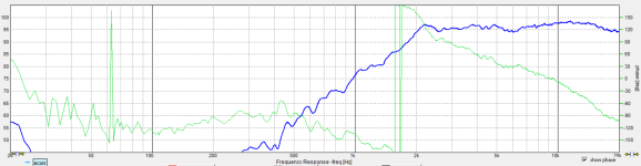

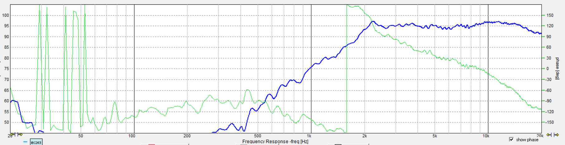

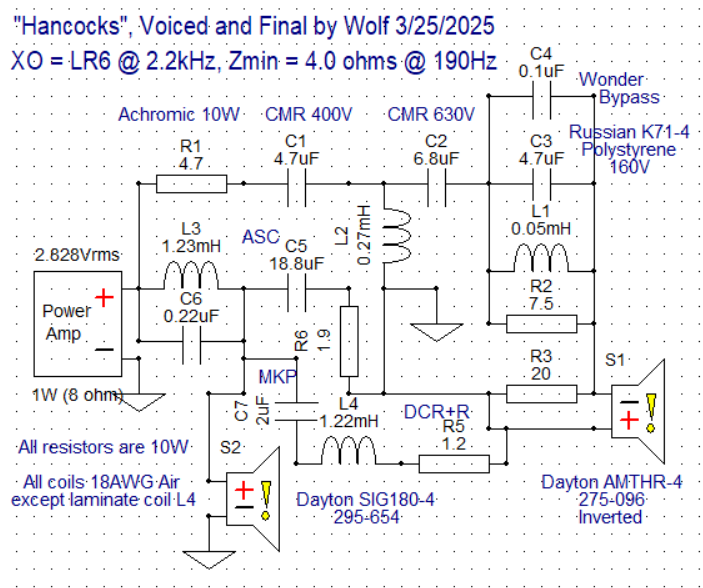

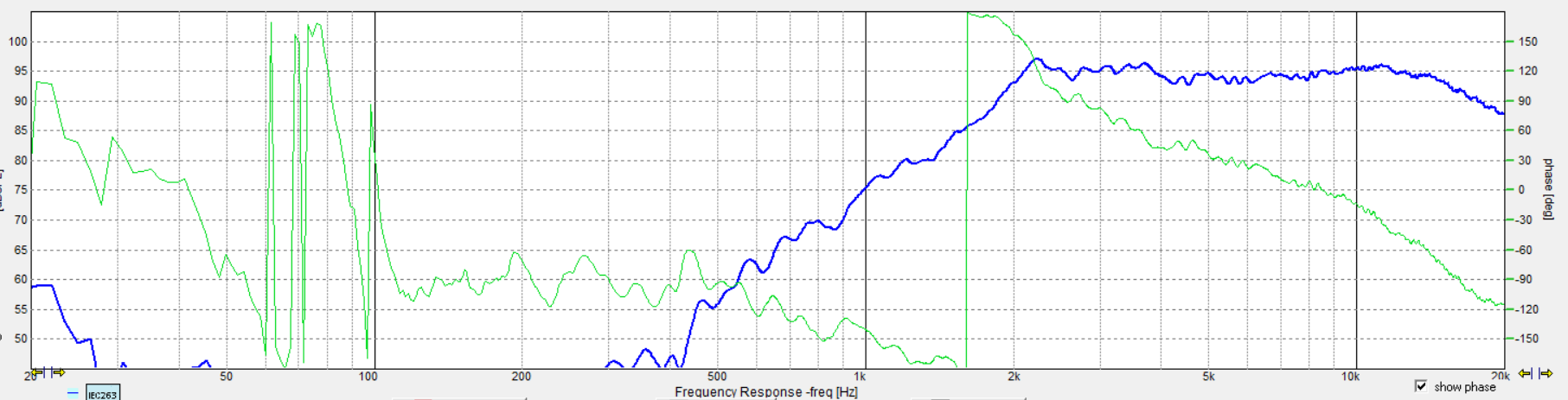

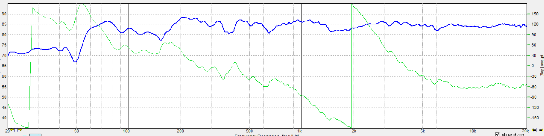

Why did I need to damp the knee so heavily at the rolloff? Well- because as stated the woofer needed it is indeed one reason. The other is due to the AMT and how they tend to work. All tweeters using shallower slopes tend to want higher cutoff frequencies. This is a given. The lower you go, the steeper the slope that is required. Being an AMT, the HD measurements taken and how to best use them, they are limited to about 3kHz with a second order electrical slope. If going to the lowest plausible, the 2.2kHz point requires a 3rd order electrical network- which yields an LR6 acoustic rolloff slope. Due to how the drivers work, where they wanted to meld together automatically made this an LR6 summation.
The AMT also had a broad peak centered at 10kHz, which meant it needed suppressed.
Then I put the tentative xovers together, and ran through the bunch of caps I happened to have in the values I modeled. I noticed that they all sounded a little different. Then increasing the first cap from 3.3uF to 4.7uF added the body in the music that was missing. Another round of trying caps in the new value ensued. Such is another benefit or curse of the AMT, as they are resolving enough to tell there are differences. One sounded shrill, one benign, one plucked hard, and 3 or 4 were fine save for some grit in the lower treble. When I finally stepped up to Clarity CMR, the grit disappeared and all was finally well, with nice detail and space of the recording.
Thus far, only a few cap brands/models have done this for me. Jantzen Superior and Silver, Northcreek Zen, Fostex Copper-Mylar, Clarity CMR and MR, Audyn Plus, ASC X386/X387, AuriCaps, and sometimes SoniCaps or MultiCaps. I haven't tried them all, but have more to try. In one of my previous builds called Nephila, the AMT sounded much better to me on the Zen caps over the industrial GE or Arcotronics style caps. The Zen yielded a massive soundstage while the GE/Arco was more focused and less expansive. I was hoping to find the right capacitors to allow lightning to strike twice for me in this build vs the previous of the same style.

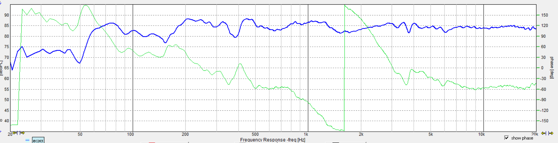

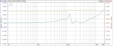

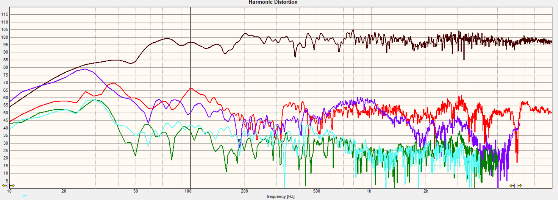

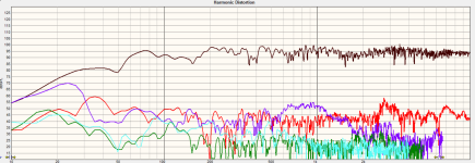

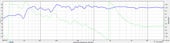

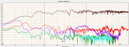

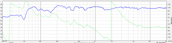

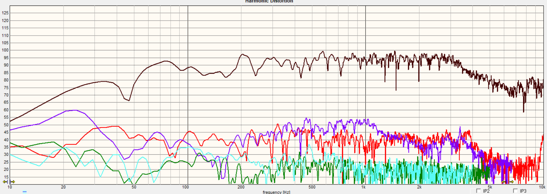

I wound the coils myself from 18AWG Blue (Dry-Oil) enameled wire. It was worth the cost to find a spool of it, as it looks really cool. I know 16 parts is rather high in count, but it was worth it for the results I achieved. As shown, at 1m distance measurement, the HD remains below the 1% threshold even at 100dB output. Zmin is about 4 ohms at 190Hz, and sensitivity is roughly between 86 and 87dB.

PS- the Missing Link was the first design in this box, so I included the drawing for that build....

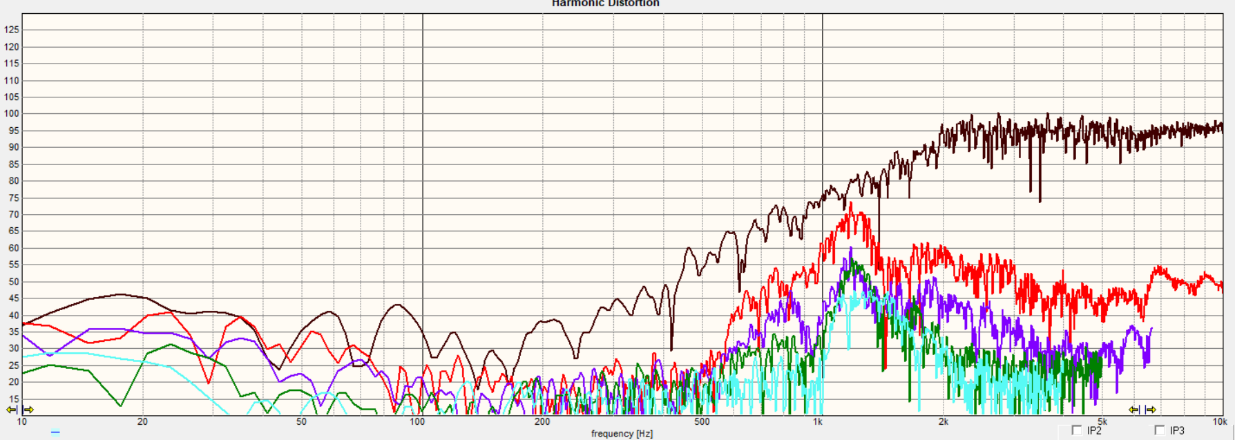

Raw driver FR/HD measurements....
Raw impedances...
