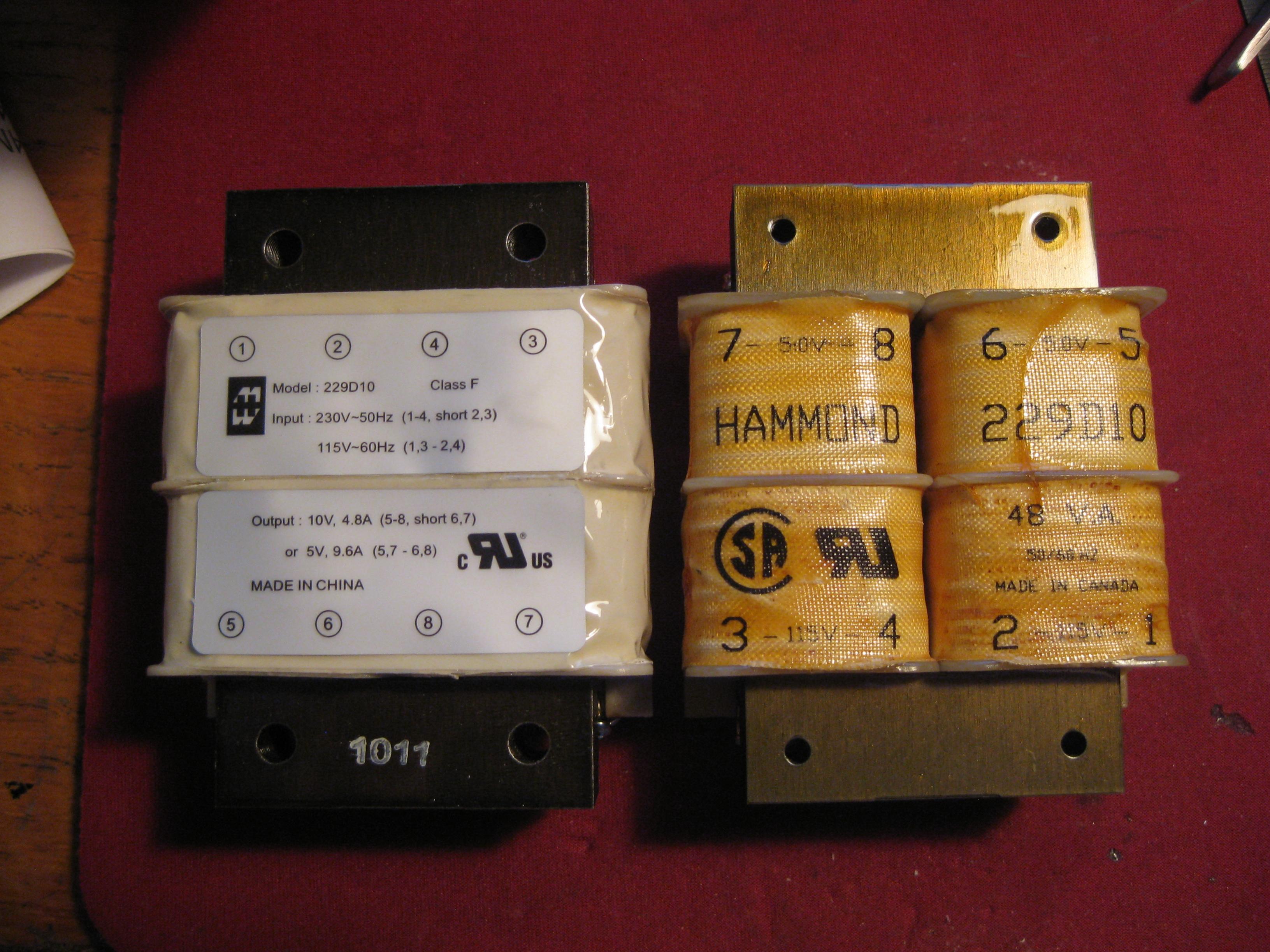

In a recent project, I ordered two Hammond filament chokes with one being Chinese and one being Canadian. From what I remember...Ignorant comment, probably driven by racism.
1. The Chinese choke had a channel frame made from thinner materials.
2. The Chinese choke had lighter duty lead wires that were very short.
3. The Hammond choke had extra bobbin tape over the soldered connections to better capture the soldered connections and immobilize the solder joints. All of the Chinese Hammond chokes I have in my inventory have this issue.
I am very annoyed and unimpressed that criticism is automatically racism. We have decades of people criticizing Hammond for various issues pre-China. This isn't anything new, but blaming legitimate gripes on racism seems relatively new.
