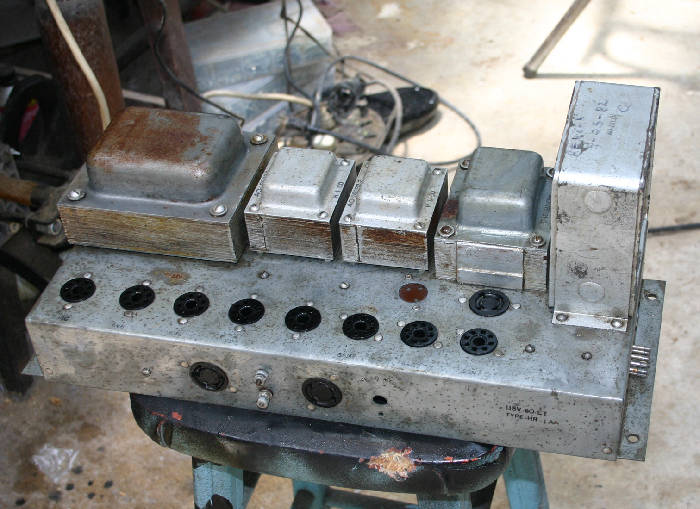

For now I think Ill build a separate preamp as there isn't much room for pots and jacks in the power amp chassis. Would there be any problem with raising the value of the filter caps to maybe 22uF?

If I go with cathode bias can I then just eliminate the field coils? I see that the 5k coil is a choke for B+ and it looks like the 250 ohm coil is part of the bias circuit, is this correct? Could I just bypass them at the speaker plugs effectively raising B+ without blowing things up?
The 5K field coil is not a choke for B+ but a *load* , eating 285/5=57mA so by not using it you have extra 57mA available. Good.
The 250 ohms one is the cathode resistor *but* it drops around 55V, while those 6V6, *in that amp* , require only around 18V , that's why they use a voltage divider at the grids.

Voltages are 305, 295, and -55vdc between the caps and ground and 295 and -55 across the field coils. Just curious as to what wattage resistor would be needed to replace the 250 ohm coil if I keep the fixed(ish) bias arrangement but eliminate the field coils?

W=V^2/R=55*55/250=12W
I would use a wirewound 250 ohms 25W resistor instead of the 2nd speaker field coil.
As of the 1st speaker and its 5000 ohms field coil, I guess that simply not using it will *probably* rise +V a few volts, because of reduced power consumption.

It's anybody's guess, but some 10 to 20V extra wouldn't surprise me, and definitely should not hurt.
Remember to un-use that cathode feedback winding, just pull and tape the wires and send cathodes straight to ground .... or even better through individual 1 ohm resistors, so you can read individual current any time.
You do not want the gain loss caused by that feedback winding, not their "HiFiness", much less in a "Blues machine".

I have it rewired and hooked up to a pair of 50 watt 12"s from an old SS Crate amp and even thru those it sounds great. When I changed the filter caps to 22uF it actually got much noisier than with the old oil can caps, any idea what would cause this?

Remember those caps were originally "floating", not with the negative side grounded (as per the original schematic).

How does that work? I guess I don't understand the internal workings of the oil can caps. Are they not grounded to the can body anyways? How are they floating? I see it in the schematic how it makes sense(sort of), but looking at the amp I just don't get it. How is one section grounded and not the others?
No, their case is not connected to any terminal .... while in electrolytics that's not the case.
Maybr you made some mistake because of that.
Ok, so how are they connected? I have 1 can with 3 terminals and a ground wire from the can case to the chassis, I just cant seem to figure out how this thing works. I can see that L3 and L4 connect to C5 and C6, I can see one lead connected to C7. How are they connected at the other end? The schematic shows C5 and C6 connected together and to R11 and C7 to ground, how? The can has only 3 point connected to it, the schematic seem to show more. I know it really simple but I just don't get it.
Are the 3 sections connected internally or are they separate? I have 3 new electrolytic caps here and no clue how to arrange them to fit the circuit. I just cant seem to make the connection between the schematic and the physical on this one.
