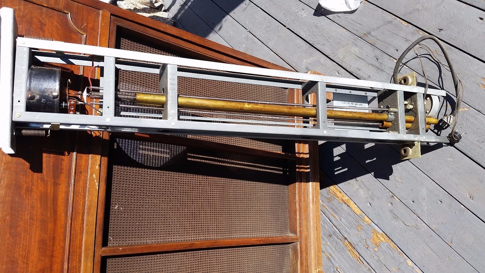

Slightly off-topic, but I'm trying to repurpose an old reverb tank as a piece of outboard studio gear........It's a reverb circuit. The tank came from a Hammond "tone cabinet" and I'm extrapolating just the reverb-specific parts of the circuit for a standalone unit.
Not sure what kind of tank you have. Hammond made lots of different tanks including several versions of the size typically found in guitar amps.
Back in my teenage years I had several large tanks removed from upright tone cabinets from the 1950's era. These tanks must remain upright since one or more of the springs terminate in a long brass tube which is partially filled with mineral oil to tune the damping of the reflected sound wave. I drove those tanks directly with the output of one of my DIY Fender Champ clones. I had 2 or 3 different versions of these upright tanks wired in parallel on the output of the Champ.

Now if I could only find one of those old reverb tanks......Ebay to the rescue. I found two old tanks similar to what I had in the 60's, so I bought the cheaper unit. I will do some testing when it arrives to determine the impedance of the drive unit, but it is likely fairly low. Then I plan to create a stand alone reverb unit for use in the modern studio that I am building (PC / DAW based).
If the unit does have an input impedance in the 4 to 16 ohm range, I will probably build a driver circuit using a 6V6 or similar sized tube, and a "Fender Champ replacement" or other small OPT to drive it.
My Champ clones from the late 60's used metal 6L6 tubes, or 6BQ6 TV sweep tubes since I could get both for free. These are two really different tubes, but both can play in the same socket if you have a plate cap connected to pin 3. These are both also possibilities to explore.
Thanks much, this is exactly the sort of reverb tank I'm playing with.

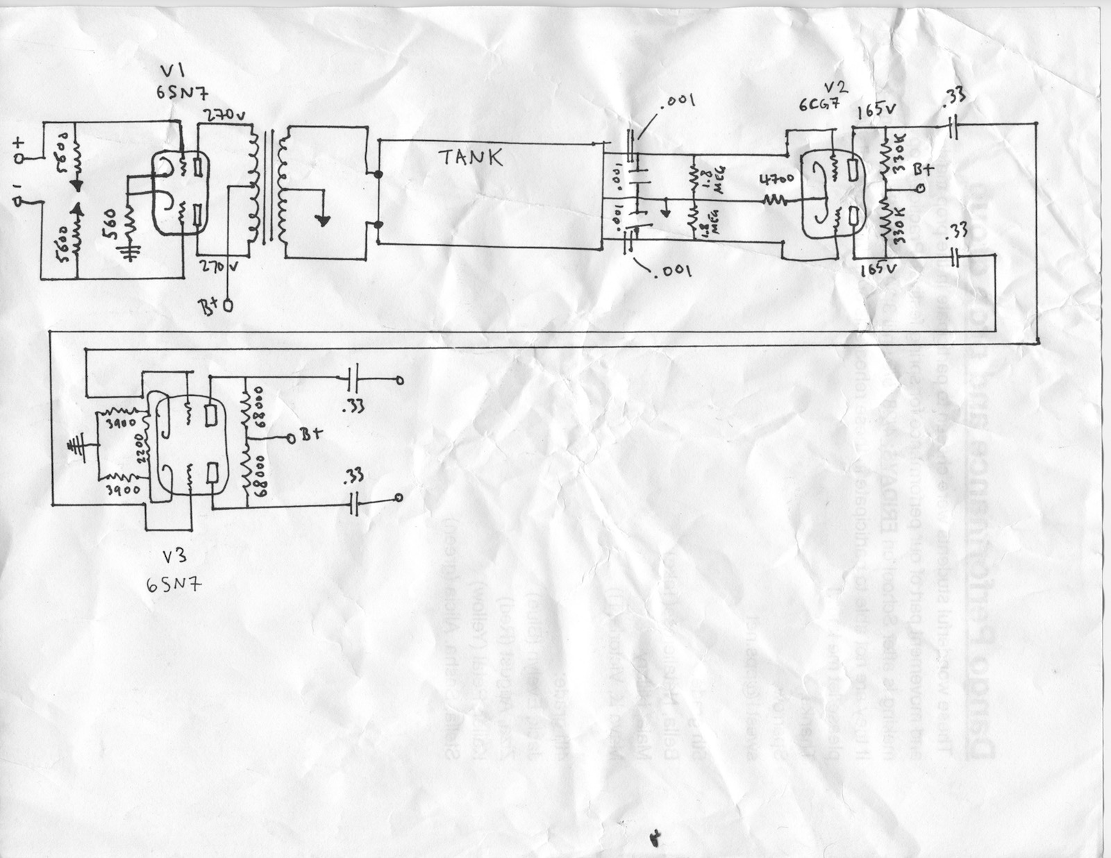

I could say more about the tank itself, but for the moment I'm running into issues with the amp circuit. Using V2 as the output, I was happy with the sound but the output was too low to play nicely with my console (it doesn't seem to return true "line level," and to get usable signal the preamp gain on the return channel has to be cranked up into noisy territory.
I then used V3 as the output stage, but strangely enough this made no difference whatsoever. I'm thinking there may be a couple of issues at play:
1. V2 and V3 are simply biased too low (note the relatively high value of the cathode resistors here).
2. I note that there is no reference to ground for the grids of V3. This seems odd to me; doesn't it typically want one?
3. Is an impedance mismatch going on between the reverb unit and my console? Perhaps if V3 were reconfigured as a cathode follower instead it would play nicer with the console?
Again, V2 in this drawing is incorrect; it's actually 6SC7.

You state that this circuit won't drive the input of your console. Is the console input a low impedance like 600 ohms? If so that would explain the loss of gain. V2 and V3 are configured for rather high impedance loads. If the console is a low impedance, then making a cathode follower out of V3 would make sense.
there IS a 1 meg reference
That was the only obvious flaw I saw in the circuit.
I don't actually know the specs of the console's inputs offhand, but inserting into a line input (lo-Z) gives no signal whatsoever, and into a mic input (hi-Z?) gives decent-sounding signal, but at too low a level.

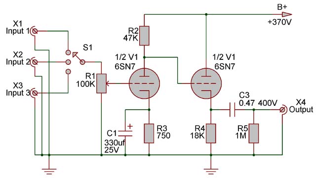

Where I'm currently stuck on V3 is the fact that Hammond configured everything as balanced. I see plenty of examples of circuits using a 6SN7 as cathode-follower output (see attached image) but they typically run the output of one triode's plate into the other triode, and then take a single cathode output.
I'm just inexperienced enough to be thrown by this. Can I simply run caps off both cathodes of V3 in parallel? Or drop one leg of the signal (coming off V2)? Or otherwise sum both signals coming off of V2? Other than that, I'm left with trying to source an appropriate push-pull output transformer for V3, which would not be the end of the world I suppose.

I'm working on an outboard reverb unit for my studio, using an old Hammond reverb tank and based on the circuit that drives and recovers it. I made a crude sketch and attached it here. (Note: V2 is actually 6SC7, and V3 has 1 meg grid resistors, not shown.)
My question is: I'd like to try and build a cathode follower output so the unit will play nicely with the lo-Z inputs on my console. I've looked at a few circuits using 6SN7 cathode follower outputs, but they tend to run one triode into the other. (Also attached.)
Hammond used a balanced layout, so throughout the amp, the "hi" and "low" signals are running in parallel. How would I build a cathode follower with this arrangement? Would I drop one leg? Sum them? Run one follower cap off each cathode of V3? I'd love some ideas, as I'm new at this.

Anyway, doesn't a "lo-Z" line input have a higher impedance than the mic input? Which mixer are you using?
I totally apologize about double posting jazbo8; I thought it was far enough removed in concept. I'll read the posting rules thoroughly, and be more on the ball.
As for the mixer, it's a Harrison PRO-790. I was referring to the input impedances of the two types of modules, but in retrospect this wasn't helpful (or accurate). What I should have said was that the line modules simply don't play well with the low-level, high-impedance output of the reverb unit as it's currently configured.
And thanks artosalo, I have seen (and often revisit) the Valve Wizard pages! My question is more about using cathode followers in this "balanced" environment, rather than the single-ended arrangement they so often seem to appear in.
I do often see 12AU7s as output drivers in old mixers. Unfortunately I'm a bit constrained by the chassis I'm working with (octal sockets).
I'm guessing this arrangement is simply a bit too esoteric for a "traditional" cathode follower arrangement, so I'm going to source an output transformer and see how that works. My guess is that it will do just fine, though with a higher voltage than specified on the Hammond schematic.
Thanks again!

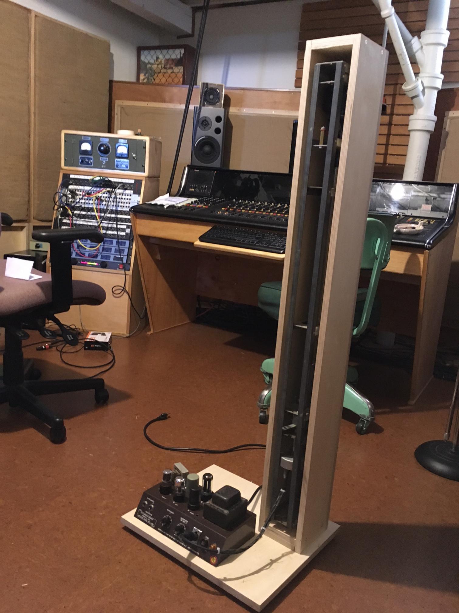

Just wanted to thank folks here again--particularly jazbo8--for the input and advice. Here's a photo of the completed unit ready to be delivered to its new home (no oil in the dampening tubes just yet!).
Unsurprisingly, following the Hammond schematic as much as possible was the best way to go. Used the output transformer included in the amp chassis (found in the trash!) to drive the tank, added a Triad A-65J as output. Sounds great!
