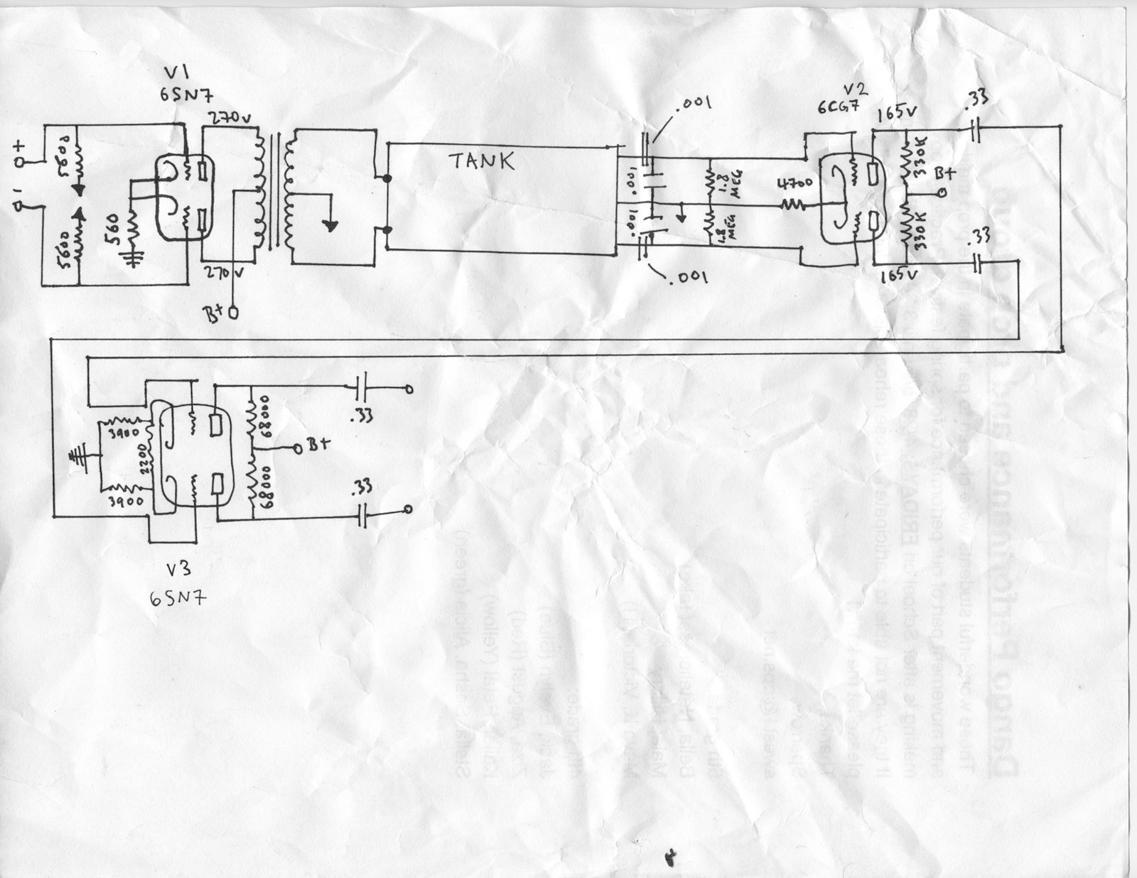

Slightly off-topic, but I'm trying to repurpose an old reverb tank as a piece of outboard studio gear. The schematic I'm working off of uses a 6SN7 to drive 6V6s as a power amp, but I'd like to use the 6SN7 in PP as a line amp.
My question is: Would the 10k primary on the output transformer still hold? Reading this thread, I wasn't certain if folks were using a single 6SN7 in PP or a pair with paralleled plates here.

FWIW, here's my sketch of the circuit as extrapolated from the original Hammond schematic. V2 is mislabeled "6CG7"; it's actually "6SC7." In the original circuit, V3 drivers 4 x 6V6. Perhaps there's even a better choice of output tube than a 6SN7; the chassis I'm building off of has octal sockets installed, and being a novice I'm playing it safe by sticking with the original circuit.

An old thread (it's undead), but I'm interested in this question too, so I'll take it up.
Can you post the schematic you have?

As for the schematic I'm working off, it's attached. Please note that V2 is actually a 6SC7, not 6CG7 as I wrote. In the "real" amp, V3 feeds 4 x 6V6.
Someone else was kind enough to point out that theoretically, I could just take output off the capacitors coming of the plates V2, first tying them to ground via 1 meg resistors. I'm at least going to try this and see what I get; it's quite possible that's enough output as needed for this unit.

It's not clear what you are trying to do... Are you actually building a reverb circuit or something else?
It's a reverb circuit. The tank came from a Hammond "tone cabinet" and I'm extrapolating just the reverb-specific parts of the circuit for a standalone unit.
So everything is working and you just want to take the output from the recovery stage to your console?
You got it, and thanks! I haven't actually tacked up the recovery stage, but I don't think it will be a big issue. Really just want to make sure output gets back to console with full bandwidth and least hum. With rongon and others' input, I feel like I'm fairly close to resolution!
I see, then taking the outputs from V2 into the board should work (keep the whole chain balanced). BTW, did you ever figure out the spec for the Hammond reverb transformer?

In theory if you want to turn a power amp into a line amp you could just take the output from the driver tubes. V3 in this case. Connect 1M resistors from the 0.33u caps to ground and you have a line amp.
Thanks again for this; amp is working well but I'd like to play with frequency filtering. I'm guessing you recommended 1meg resistors at output for full frequency? According to one of those handy calculator sites, a much lower value (around 2.8k) will form a high-pass around 250 Hz, which would be optimal for my purposes here....
2.8k might be too heavy a load for V2, and results in un-wanted distortion. If you want a LPF, it's better to put it in front of the tank.
