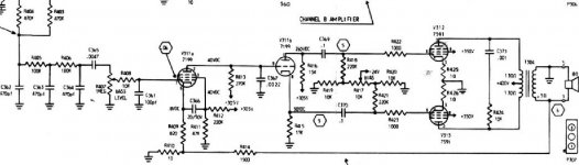

That appears to be a DC balance pot, not a bias pot. I guess you adjust it so that you get the same voltage drop across the two 10 ohm resistors in the output cathodes.
I agree with DF96, do that, and you can keep the current in the output transformer halves equal to prevent early saturation.
24V is a good check, and so is the 350V on the screens, and 400V on the plates,
Then check that the current times the voltage does not exceed the tube plate and screen power dissipation ratings (easier said than done, because there are no screen resistors to be able to test the screen current. I bet a 100 Ohm screen resistor to each screen would not appreciably affect the amp performance, but would allow easy testing of screen current with a DMM.
If I had that amp I would put those resistors in there.

Thank you and JonSnell. The organ sounds incredible, but I was concerned to avoid blowing the tubes, which is why I asked the question I the first place. The bass is a little funky sounding, though. Instinctively, you folks chimed in with what is really important, and why. This is most appreciated.
I was underneath planning to replace all the carbon and noticed one resistor in the mix of this section (bass) is out of spec high.
From the little reading I've done on power tubes, it does not seem prudent to risk an open anywhere while energized, especially just to save a few bucks.
The screen resistors are going in. It is not Hi-Fi so I doubt anyone would notice any loss in sound quality. May as well get rid of all the carbon, then set the balance. All the voltages are dead on, after all the electrolytics were replaced.
This is the bass channel amplifier of a Hammond H-100 organ, isn't it? As yet mentioned above, there is no way to adjust bias really. The -24v is a fixed voltage, coming from the lowermost winding of the power xformer (see complete schematics) via the rectifying and smoothing network of D703, C704, C705, R704 and R707. Trimpot R417 serves for DC bias symmetry of both 7591 output tubes.

It is indeed the bass channel, Kay. All those components were replaced with new, and there is the -24v coming out exactly. Strange way of making the negative--half-wave rectifier--but it works.
I cannot find the precise schematics for this particular version. There are some changes, but most of it is the same. For instance, resistors are used instead of inductors for smoothing the HT. Also the two preamps are solid state in lieu of tubes. Fortunately, these amps are the exact part numbers of those used in the R-100. There was also a small board (with many transistors) connected to the signal input to the audio amplifier. I read in a forum that it is some kind of suppressor, and that when it goes bad, the signal is reduced to an unusable level. The writer said if that happens to simply disconnect it. That happened to me and when it was disconnected, the volume returned. It blew/shorted around the time a contact cleaning was performed. Two days were spent trying to locate the problem.

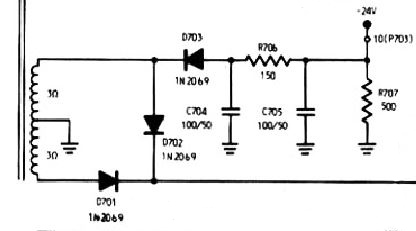

There is a large, chassis mount diode or zener in the amplifier chassis. I have yet to determine what it is used for. The circuit must be derived by tracing all the connections visually, and hopefully finding the part specs by the identifying number.

One thing about the 7591 bias, many E100 owners report the diode blows in the -24 v circuit and makes the 7591's glow cherry red. One should really replace the 1967 diode with a 1n4003. Of course maybe by 1971 or 73 when yours was made, the reliability of silicon diodes was better. E100's date from 1965 on. My 1967&68 units haven't blown the minus 24 diode.
