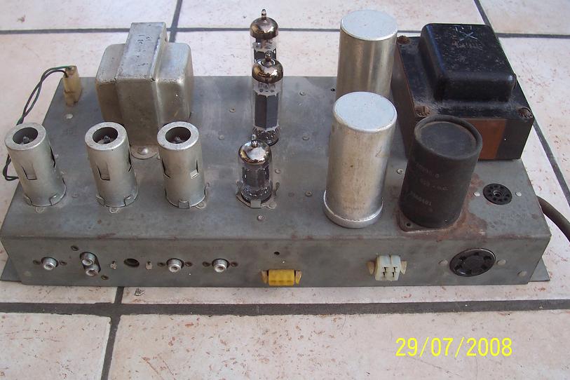

I got this organ amp chassis from a nieghbour who found the organ on a bonfire.He told me it was a Hammond.
The next day I rushed to the scene with my trailer to save the organ,but the local kids had completly kicked it to pieces(little tiny pieces!!) and burned the rest.
I am newbie to tubes(some minor experience,I am very aware of the dangers) and I want to make this amp into a guitar practice amp.The only info is the number stamped on the chassis.It says AO-48-1B.
I need schematics.I have searched in vain for days on the net and only reference to it is an Ebay seller who has replacement tube sets for hammonds and stuff.He says it is from an Everett 2022 organ but this has got me no further.
Also heard it might have been a Hammond Chord organ.Still,no luck.Too many models,variants etc..
I know I could just buy a tube amp but money is tight and anyway I would much rather ressurect this old amp from the dead.It seems such a shame to waste.
Has anyone heard of this amp,does anyone recognise it,any ideas where to get schematics?
Any suggestions greatly appreciated.
Here is a pic.
P.S it has 7247,12AX7(x2),6267,6BQ5(x2),6CA4

I have one of these that is currently sitting in a chassis as a guitar amp. I had to do a bit of work to get it working. The 6267 is the input pentode, i.e. and ef86. The 12ax7/7025 nearest the el84s is the phase inverter. The 12dw7/7247 is the reverb driver and tremolo oscillator. the other 12ax7/7025 is an intermediary recovery/amp stage. The oscillator's output is not designed (as far as I can tell) to make anything in that chassis oscillate, rather the signal was coupled out through the multi-pin (6 or 7?) plastic connector. It went to a solid state board. The 3-pin plastic connector is for the reverb, the larger resistance across it the more reverb. 1meg-500k is about max. The rca connector labelled "R" (you may have to clean to find this) is the reverb out. The rca connector labelled "G" is the return. The tank should be a 4-8 ohm input with high impedance output. Do not run the amp without the tank, the transformer for the reverb will short and become a flyback inductor for the B+ line (nasty--1.2kv spikes). Under the chassis you should be able to see which RCA couples to the EF86. This is the input. The other two RCAs are perfect for a putting a volume control and tone stack between as this was the foot pedal. It's a great sounding amp, I have mine in an old crate combo chassis with a '59 Jensen P12Q and a customized reverb tank. I redid a bunch of circuitry to get tremolo working. If you have any questions, PM your email address and I'll try to help. This amp will put most ~ 15-20w amps to shame, and it has great tone. Hopefully you have the tubes, they were mostly mullards in mine. The plastic connectors for the two plastic connectors may be hard to find, but I can walk you through hardwiring a different setup. Good luck! 🙂

I sent you an email, mine was from the same organ or very similar (everett 3000 and 2000 models are identical except for the solid state portions and number of keys etc. Poweramp is the same as far as I know.)
Good luck, that chassis is a gem!

here's more info on the reverb tank for anyone that finds one of these:
>The information that I have for an old Gibbs reverb with the letter R is it would be >the same as an Accutronics model 4AB2C1F. I also have info on a Hammond part >number 121-000020 without a clamp with the letter R showing as an Accutronics >model 4AB1C1F. And at the time the letters were the same for different delay times >and mounting planes. So to answer your question on input and output impedances >the models have an input impedance @ 1KHz +-10% of 8 ohms or .8 ohms dc >resistance +-10%. The output impedance @1KHz +-10% is 2250 ohms or 200 >ohms +-10%.

essentially a fender style tank.
