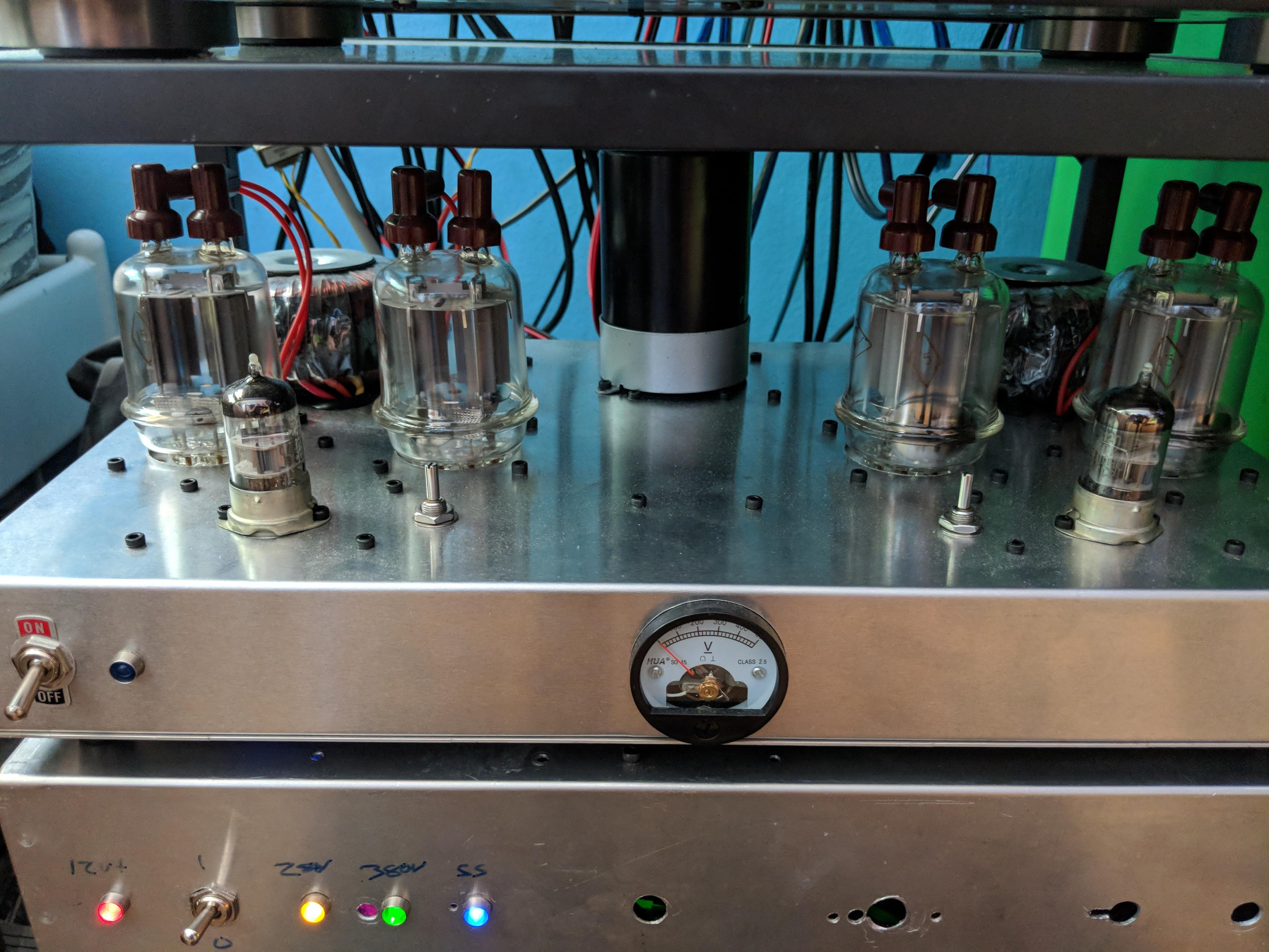

The power tube holes and the hole for the meter were made with a DeWalt hole saw.

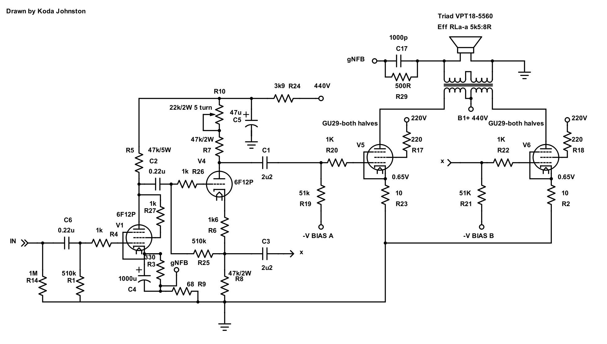

kodabmx- do you have a schematic for the amp shown? It is using 3E25 tubes in PP configuration?
It's actually GU29 with 6F12P phase splitter.
Here's the drawing.
