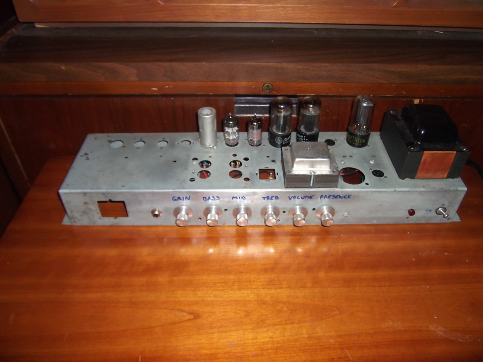

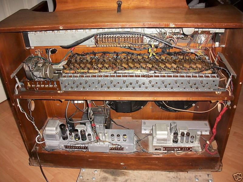

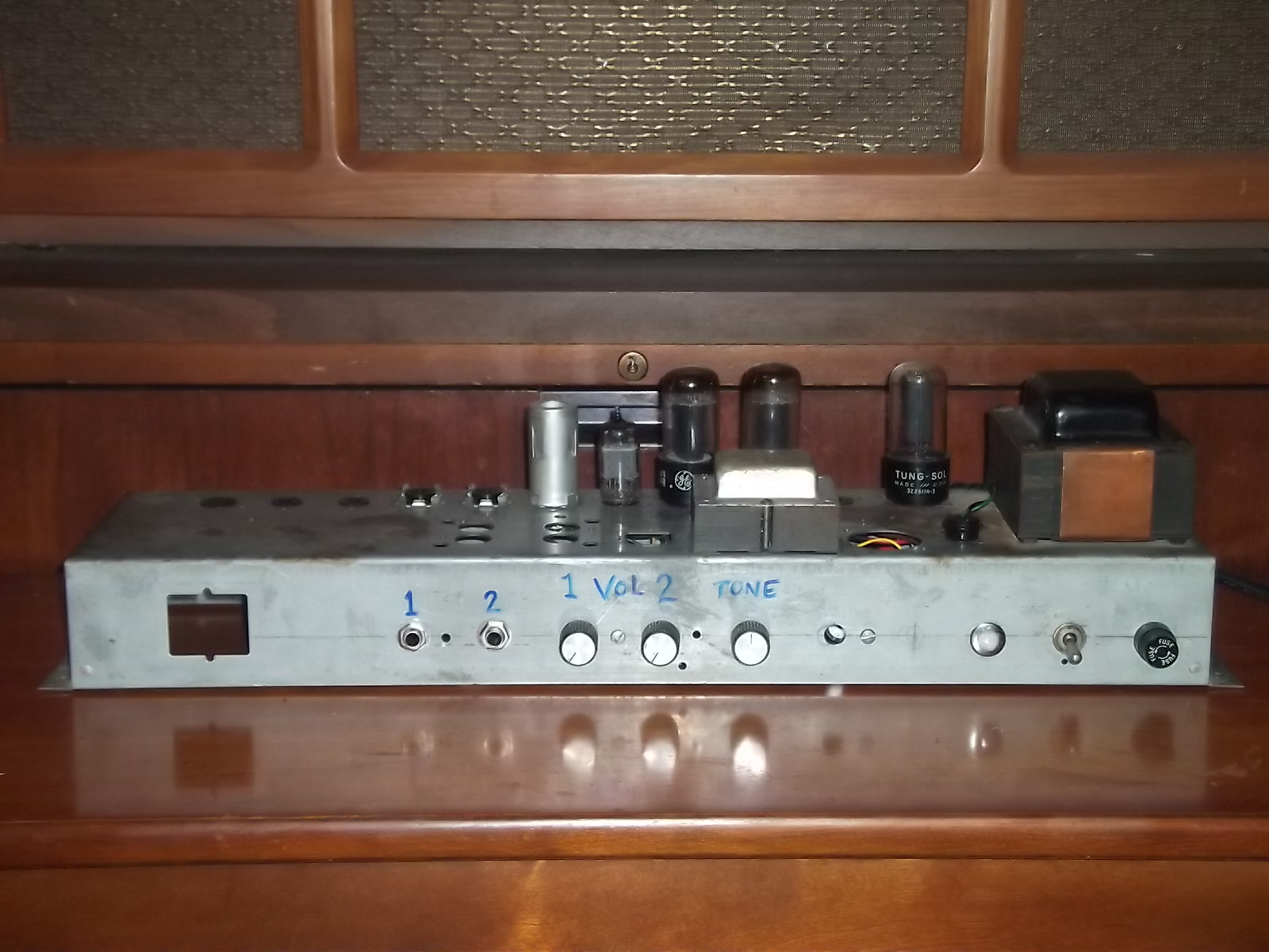

Did you save the smaller reverb amp? There should have been either an AO-35, AO-44 or another one I don't remember right now. Those two I mentioned are the easiest to convert to guitar amps. If the organ is still there, go get that other amp. The AO-29 has a LOT of extra tone-shaping/shifting circuitry at the opposite end of the power tranny. Look at scrimpu's pictures just above your post. See all the space at the left that's empty? That's where all that stuff is at and should be eliminated. And the schematic for those two reverb amps I mentioned are far easier to read. Unless of course you plan on gutting yours and starting from scratch. But using that main chassis leaves you an extra 4-5 inches of unused space at that end. Or did you not have the reverb installed. I just looked up the info and found there was both reverb and non-reverb models for the M3. I thought all M3s has reverb.
Here's a pic of one with the reverb. It's the small amp on the right. That one is the AO-35 and there's a wealth of info on the net for converting one of those. Also much info for the AO-44 as well.
