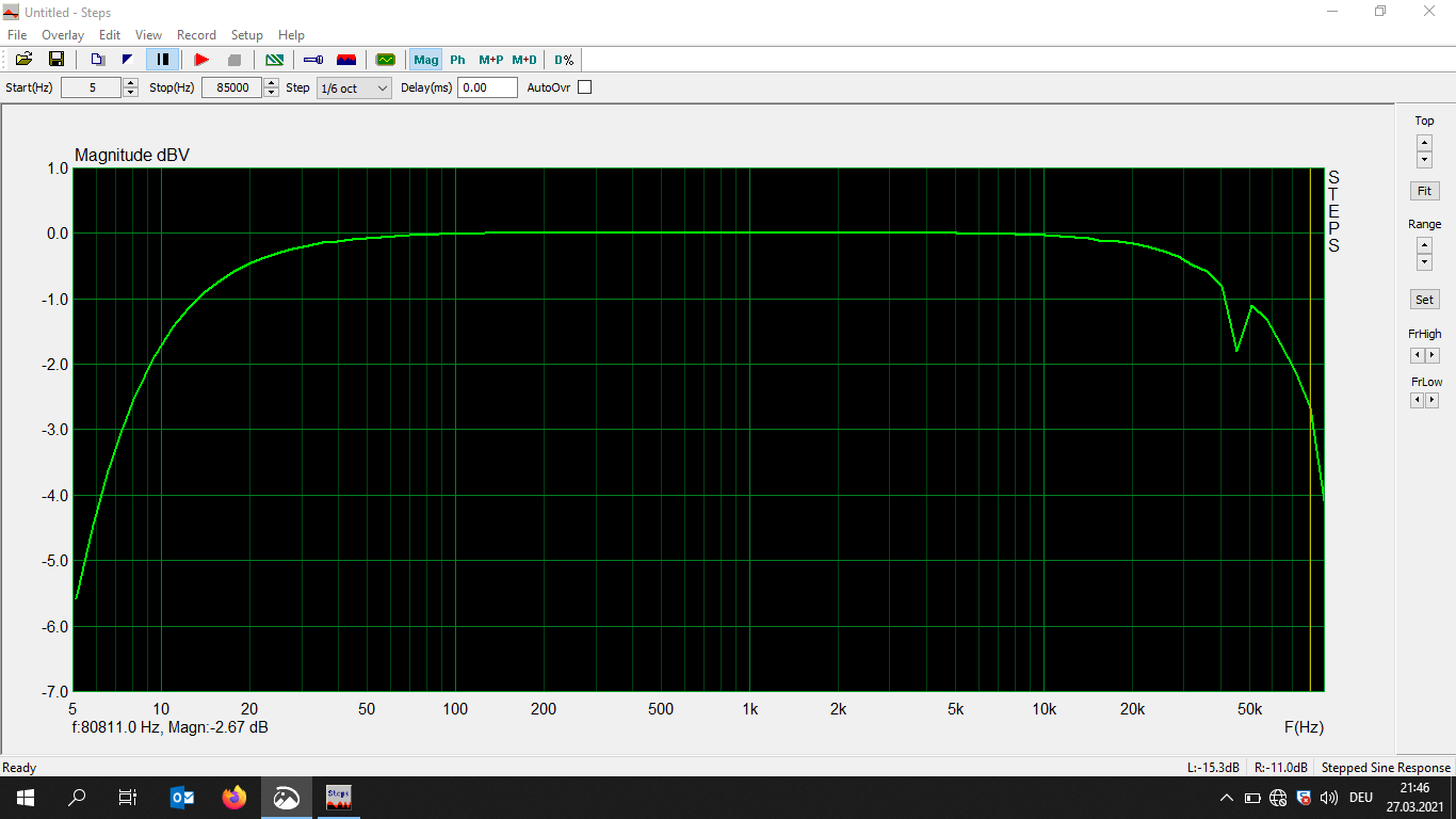

What's the HF like?
A lump that size may have 300pFd self-capacitance. No less without much extra expense and increase of DCR.
Plot it on a reactance cart, if you can.
The 200H at 50Hz is 60Kohms. The 300pFd with 60K falls past 9kHz.
Yes, re-figuring with 20Hz makes 24k and 22.5kHz.
It is liable, even sure, to also have leakage inductance and a top resonance.
Here a (quick & dirty) test with a 2P29L which I did a year ago ... didn't note the output cap-size and load impendance - i was more focussed on mA vs. distortion when I run this test.
I can't say much about sound quality. First i didn't have another choke to compare. Second I didn't focus on pure choke loading cause the gain is too high for my system. It was more a proof of concept (with benchtop supplies) to see how microphonic the 2P29L are and to have a measurement reference vs. choke + parafeed (LL1930).
From a technical perspective I like these chokes. They are not expensive, have a good FR (despite they are marked as power supply chokes) and a resonable low DCR.
btw. the sticker on the chokes states 30mADC not 40mA.
