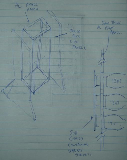

This amp I'm building now is neither complex nor big (well from my perspective anyway – especially compared to some of the other things being built up in my shed)!
Attached below are a few crappy conceptual drawings of how I’m going to construct this amp. (No dimensions added yet and the scribbles are not really to scale, but they should give an idea.)
The amp will stand upright, like a tower, probably 1 to 1.5m tall. It will be constructed around a TIG welded frame made from 50mm by 50mm aluminium angle 5mm thick. This frame will support everything, including the transformers.
Two varnished solid pine bits (15 or 20mm thick) will form the side panels and the legs. The front panel will be cut from 5mm thick aluminium sheet either painted or powder coated gloss black. The lower section of the front panel will consist of a big Conrad heatsink for the heater supply regulators, behind which the numerous power supply toroidal transformers will live.
Nearly all the electronic circuitry and all the valve sockets will mount on various sub panels attached to the main frame, about an inch from and parallel to the inside surface of the front panel. All tubes will mount horizontally, poking out the front panel.
The front panel won’t actually provide structural support for anything, being easily unscrewed for servicing access. The rear panel will be cut from a sheet of pegboard, with flyscreen wire glued to the inside surface, over all the holes. This will ensure adequate internal ventillation. As for the top panel, that will just be another pine sheet.
The aluminium angle frame will be fitted out with pneumatically riveted Nutserts for screw mounting of all the panels.
BTW, ~250W per channel for HiFi use driving not-so efficient speakers with high dynamic range material at reasonable listening levels (but still avoiding clipping) is much less over the top than many people here might imagine.

A drawing of the front. There will also be a vintage style pair of current and voltage monitoring meter movements, switchable between the various anodes, cathode, etc and several blue leds.
