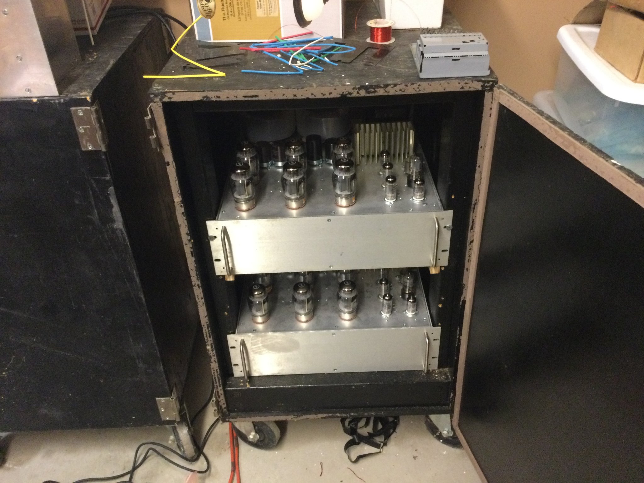

People tried to “discourage” me too but I did it anyway. Like bass? You could power a small disco with these. Seriously — they blew away my first Phase Linear, which was actually used for mobile disco. 300 watts “music power”, calculated from peak o-scope readings, 210 watts continuous sine wave.
Yeah, the rack is heavy. So is the one loaded with CA18’s and so are the lab horns. I’m used to “heavy”.

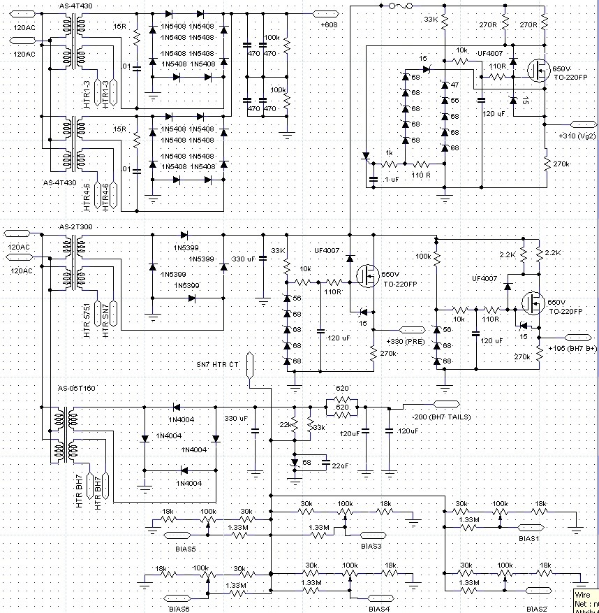

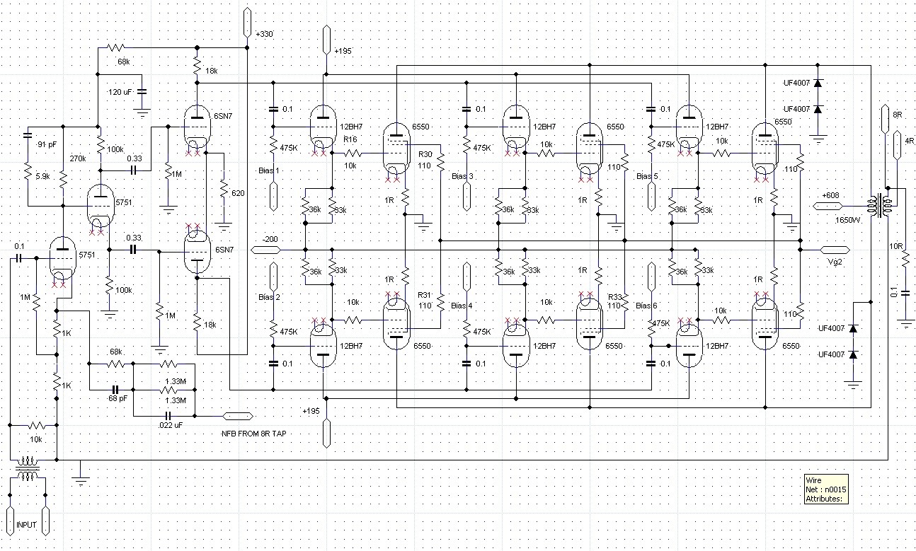

That is a very serious amp. I like the cathode follower drivers of the output tubes with solid state power supply. Fantastic driver (so maybe one driving multiple 6550s?) and it keeps the 6550 grids negative until the cathode followers have warmed up. Why not 6SN7s as a cathode follower? Maybe the warm up time is too short? I personally like Maida (Millett version) regulators. I think they have better performance than the zeners.
6550’s are particularly picky about g1 resistance, which is why the direct drive followers in the first place. Rk of just about any little triode is at most a few hundred ohms, so it could drive multiple 6550’s. But then you lose the ability to individually bias them. Depending on matching, an overall balance control may be enough. I suppose you could use 6SN7’s, but I wanted to use something that can take being run a little hotter while still being available new. And didn’t want to use up all of my old stock 6SN7 Sovteks some place where linearity didn’t matter as much. If I didn’t intentionally limit this project to standard audio tube types that are in production, I might have gone with 6BL7s for drivers.
Warm up and stabilization time is done the brute force way. I have a 555 timer and relay set to turn on the HT and 6550 heater power trafos 15 seconds after throwing the power switch. Whole front end comes up first. The 4 transformer power supply was me being a cheapskate and wanting off the shelf units. A custom made unit would have been well over $200 per channel the Anteks cost, probably more like $500. And at the time I didn’t have suitable cores or all the wire on hand to wind my own. Separate trafos works out better for the delayed start anyway.

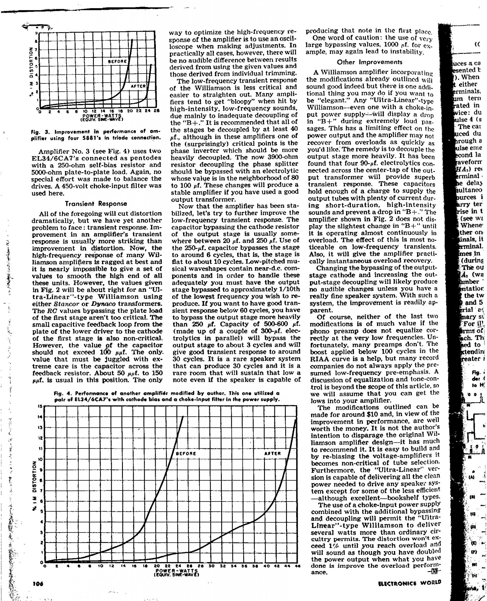

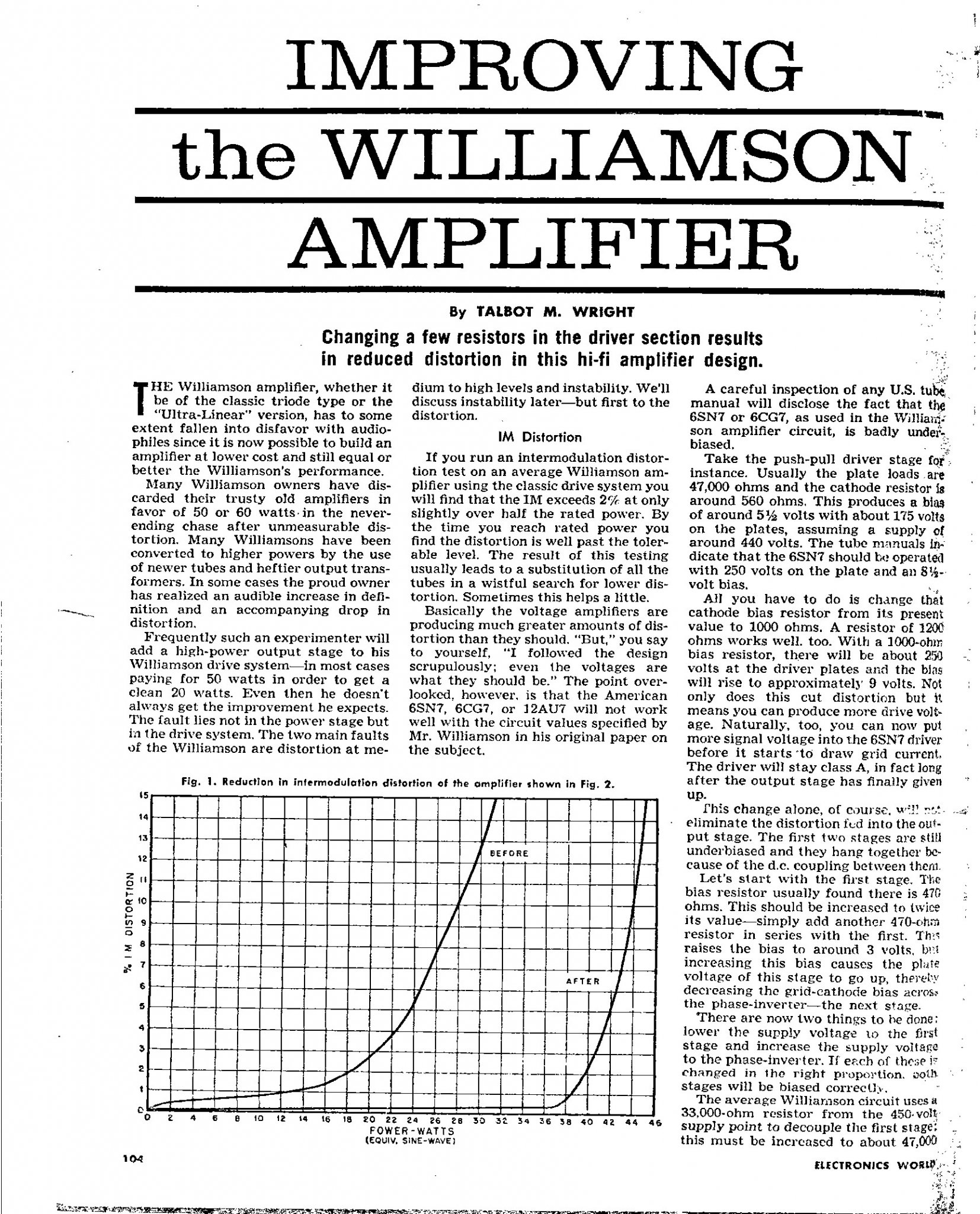

We build amps that are very similar to wg_ski , but Maida regulated screens and modified Williamson driver ( see "Improving the Williamson Amplifier by Talbot M. Wright) with additional cathode followers (the driver stage regulated from the single Maida regulator). This allows optimal g1 resistors. We have found that we can reduce the bias current on the tubes to AB2. We don't individually bias the tubes. There are no problems running up to eight tubes this way, with only individual bias for the top four and bottom four. Reducing bias current increases stability and tube longevity.
When there is that much feedback, you can reduce the bias quite a bit. I’m only running 20 mA per 6550. It actually gets quite listenable once you get it above 3mA and almost acceptable at 8. It surprised me just how little I could get away with.

wg_ski thanks for posting the schematic. What is the reason for the choice of a high mu triode for the first stage and concertina? What is the purpose of the 4007 diodes from the 6550 plates to ground? Thanks.
More open loop gain than another SN7. Some use a little pentode for even more, but then you have to move the dominant pole down. Higher mu is less desirable as a concertina, but with that X14 gain stage after you only need two or three volts out of it.
The 4007’s are for overvoltage protection. You can run it without a load without frying the OPT. It’s been tested, for about 2 hours with music run up to heavy clipping (load disconnected). The output zobel alone might be enough, but I didn’t trust it with a $350 OPT. Those diodes always work for SMPS’s, although you want fast ones for that.
