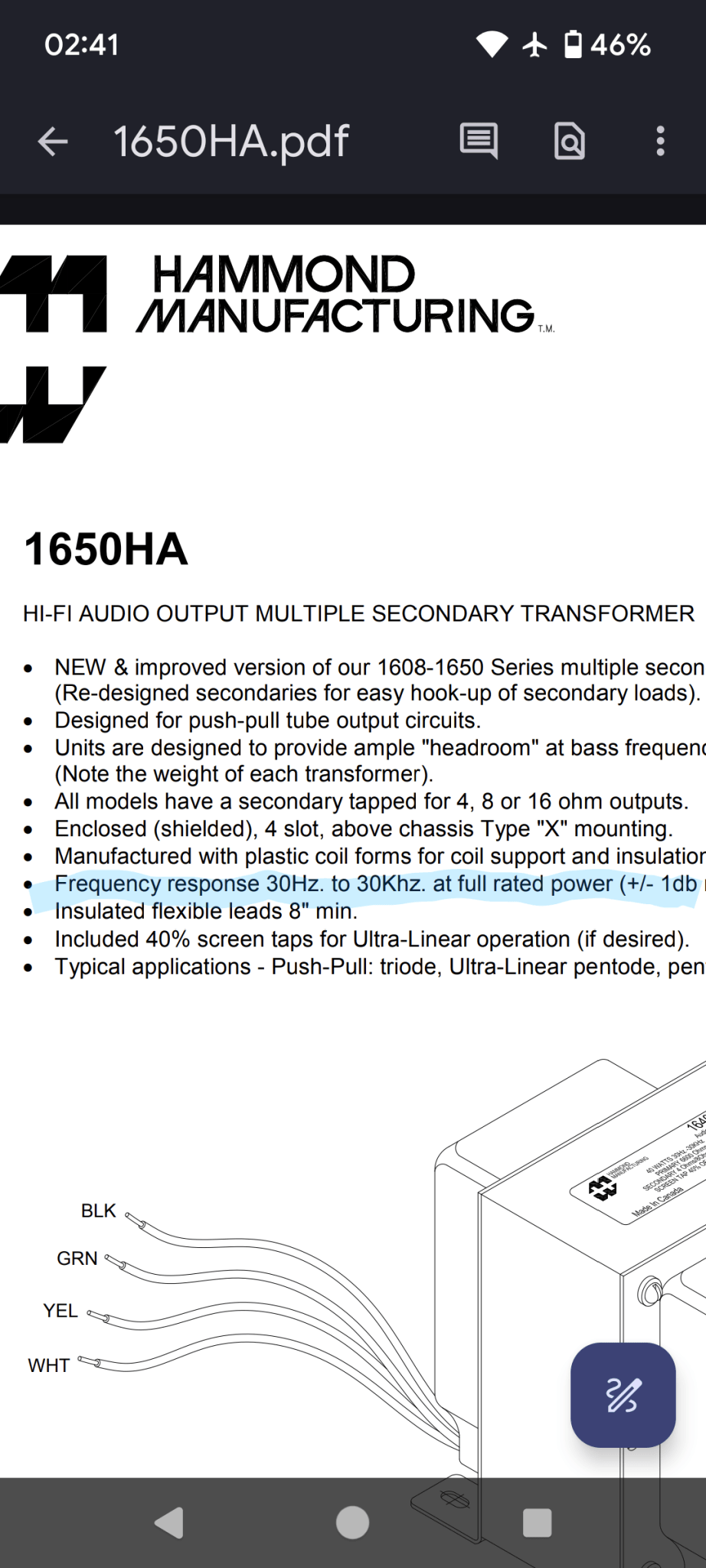

Sorry, X = 2*pi*f*L so... L = X / ( 2*pi*f)
The power rating at 30 Hz is determined by saturation, not inductance. Frequency response at lower drive levels will extend considerably lower.
At 500Hz the reactance of the primary capacitance will dominate your bridge reading. In fact they may look capacitive rather than inductive. You would need to take the measurement at nearer 30Hz. The primary inductance is important for the LF stability if you use negative feedback. I've used the Hammond 1650T in many PP designs and they do deliver the full power at 30Hz and produce the same LF and HF responses in simulation as the real design. The 1650T inductance is quoted at 60Hz I see on the data sheet.
You may be more successful measuring the inductance of the secondary with the primary open and then multiplying by the ratio of primary to secondary turns squared or the voltage ratio squared.
