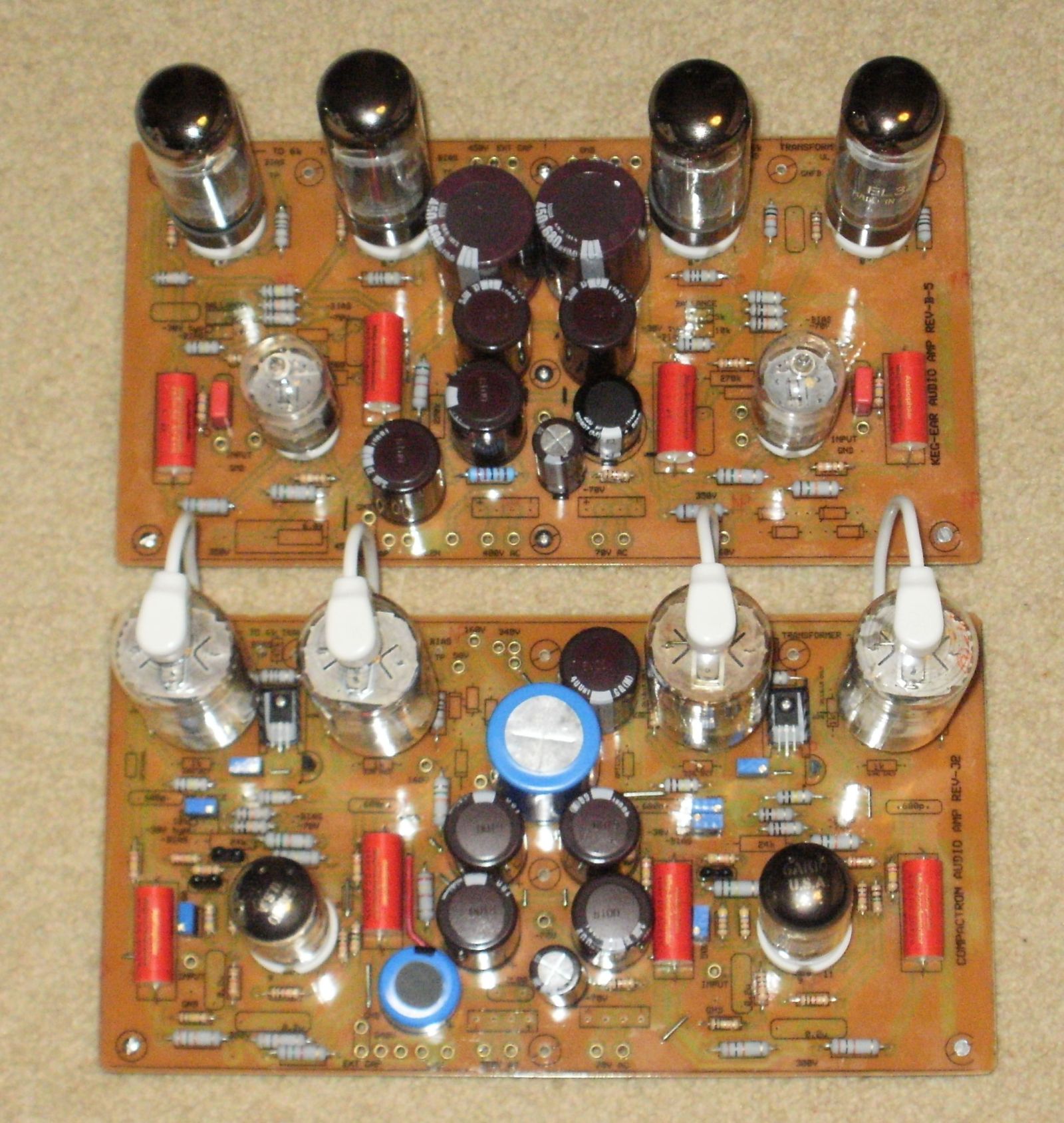

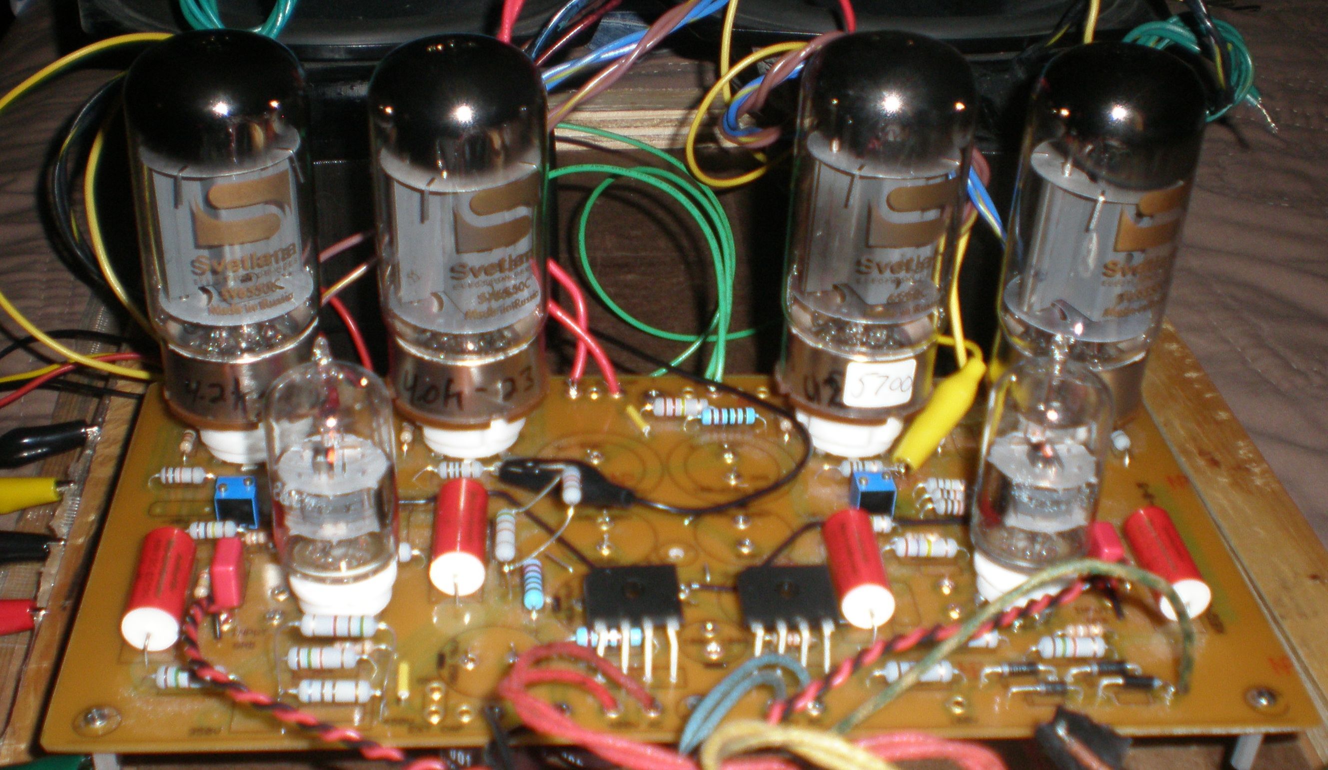

When I started to design tube amps I found an interesting graph of class A vs AB output power. I wanted a compromise with a larger class A operating zone without giving up too much power. I wanted a universal transformer that I could drive with an assortment of output tubes. My concern was the output impedance. The higher the Ra, the larger the iron impedance needs to be. Thus a decision was made on 6.6k.

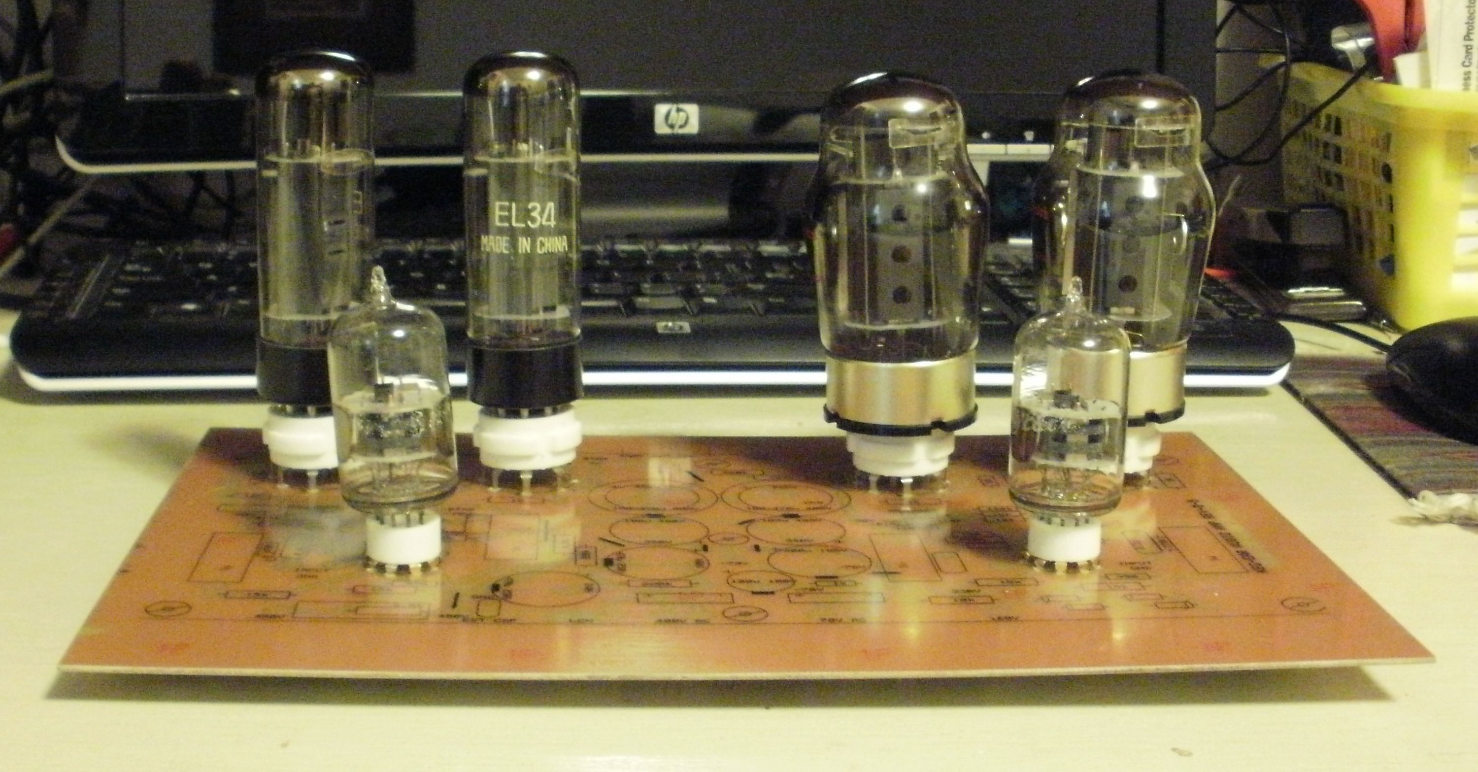

I design 2 different platforms, sweep tubes and the 6L6 family.
Both are PCB based, just because I find it easier and it works great! I goal was to design amps that others could make by the toner transfer method.

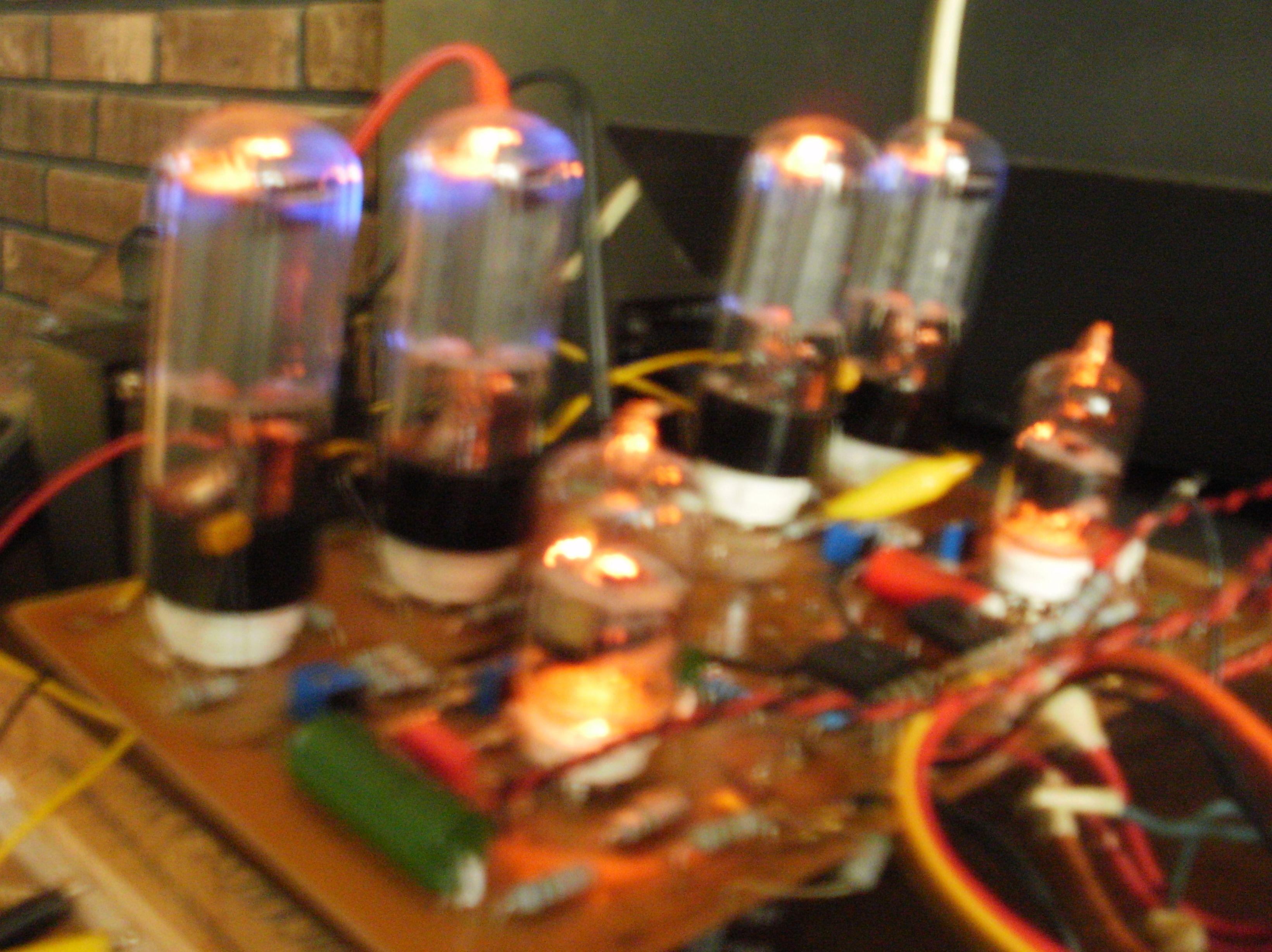

A pic of the little Russian 6P3S 6L6 tube at 360 VB+ with a little blue glow..

this is my EL34 pp amp, using russian 6J9 as input tube and 6CG7 as ltp drivers.....circuit culled from Mullard 5-20, Harman Kardon Citation5 amp circuits.....
what makes my build different from others is the use of common mode choke forming part of filtering circuit.....another is the generous filtering, each channel is separated by 3amp diodes, 500uf filtering caps each channel, use of single coil fwb circuit so that transformer heating is lessened compared to center tapped....about 500ufd is also used before and after the common mode choke.....
filaments are biased by dc at about 50volts to minimize hum and noise.....
i think that Hammond and Edcor and other traffo makers should make the hv coils in their traffos as 2 separate coils, so that users have the option to series those for center tap rectification, or parallel for full wave bridge using silicon rectifiers in conjuction with tube rects.....
