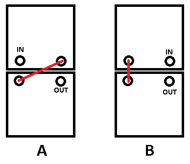

3rd, you can mount the chokes on standoffs, bottom to bottom and wire the chokes with one winding backwards. This makes the pair of chokes hum buckers. In my test setup the pair of chokes picked up 20dB less hum than a single choke.
Gary
Sorry to dig this thread up out of the dark ages, but I'm interested to know the exact wiring which would enable these chokes to operate in the above fashion.
In the figure I have excluded the possibility that one choke's lead are facing the other direction, which could very well be the mentioned setup.
