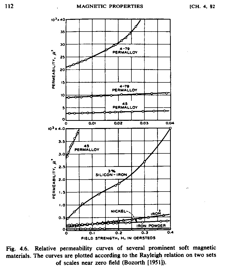

Ideally the inductance ratio would be 625 also, since that goes by turns squared too. But practically, the measurements were not likely done at the proper scaled currents. Core permeability changing with excitation level messing with the measurements..
Would it be possible that company like Hammond do not know this ?
Anyhow, that data give about 50 % too low impedances. That is quite big error.
I reported Hammond about this and they already replied with additional questions. Let's see what will be their final answer.
Looks like about an 8 to 1 variation of permeability for silicon-iron.
Only if the measuring currents used are in the inverse of the turns ratio. (ie, same core excitation level for each case).
Using the same LC meter obviously won't work.
With a Variac to set turns ratio scaled voltages
(with a V meter and an I meter to measure V/I = Zl = 2 pi f L ) should work.
There could be some discrepancy if the winding resistances aren't also in the N^2 ratio, but a well wound xfmr would normally satisfy that rule. (gives lowest power loss for a given winding window)

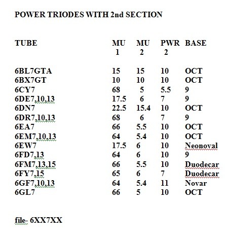

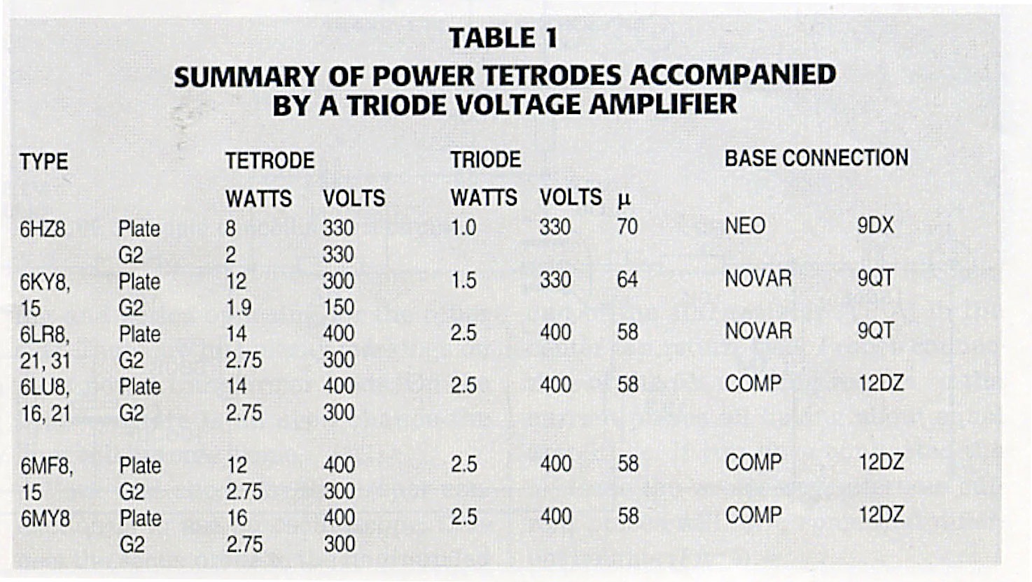

The EL84 in triode is not exactly the greatest choice. Altho easy to drive with its high triode mu it needs a high plate voltage.
Max plate dissipation is soon reached.
There are a number of dissimliar triodes & triode pentodes used as vertical deflection in TV that make very good SE amps.
Driver & output in a single bottle. Refer to the attached. I've built SE amps with both 6EA7 & 6LU8 with very good results.
