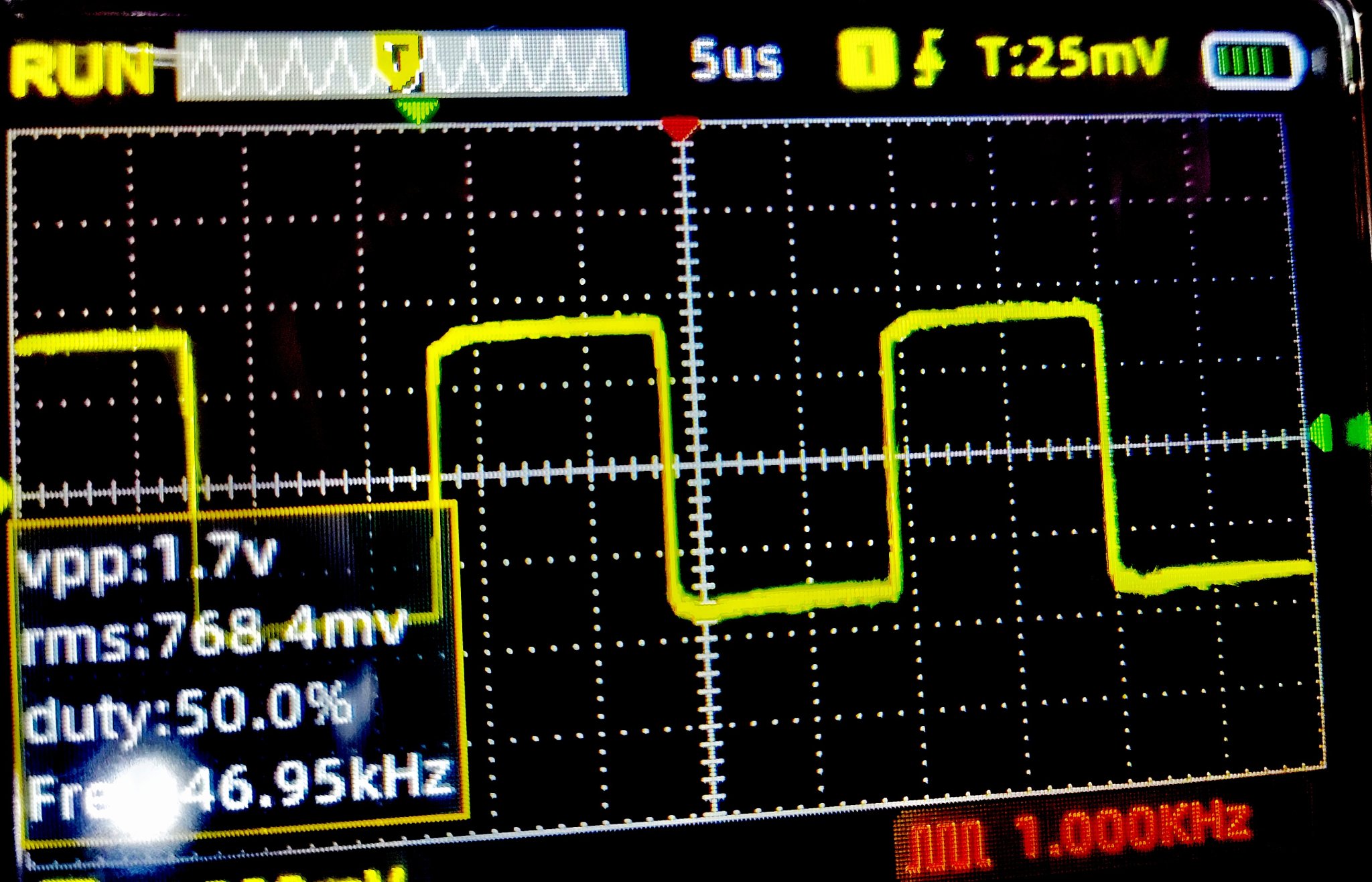

The rail voltage goes up to 106V when the input voltage is 14V.
I did install 640Ns on it. The amplifier is rated for 600 W into 1 Ohm. Maybe it will be alright, I guess. Also, the two other part numbers cost three times as much as the 640N here.
What if I lower the oscillation frequency? Would it be able to improve the waveform?
I've seen some amplifiers using a similar circuit design with a 47 kHz oscillation frequency, and the waveform was much better.
For the resistor, I will do as you suggested.

If you drive the amp hard while watching the carrier frequency, you should see the frequency drop significantly from idle to when it's driven hard. If you have a low idle frequency, the high-power frequency may be too low. I'd prefer that the high-power carrier be up around 80kHz.
The wave shape isn't all that critical as long as the outputs have a good drive signal amplitude and shape.
If that's a handheld (battery-powered scope), you can check the drive signals by placing the probes on the gate ans source of the FETs.
When you get the amplifier fully assembled and during testing, confirm that the output stage part of the heatsink is relatively slow to heat up.
