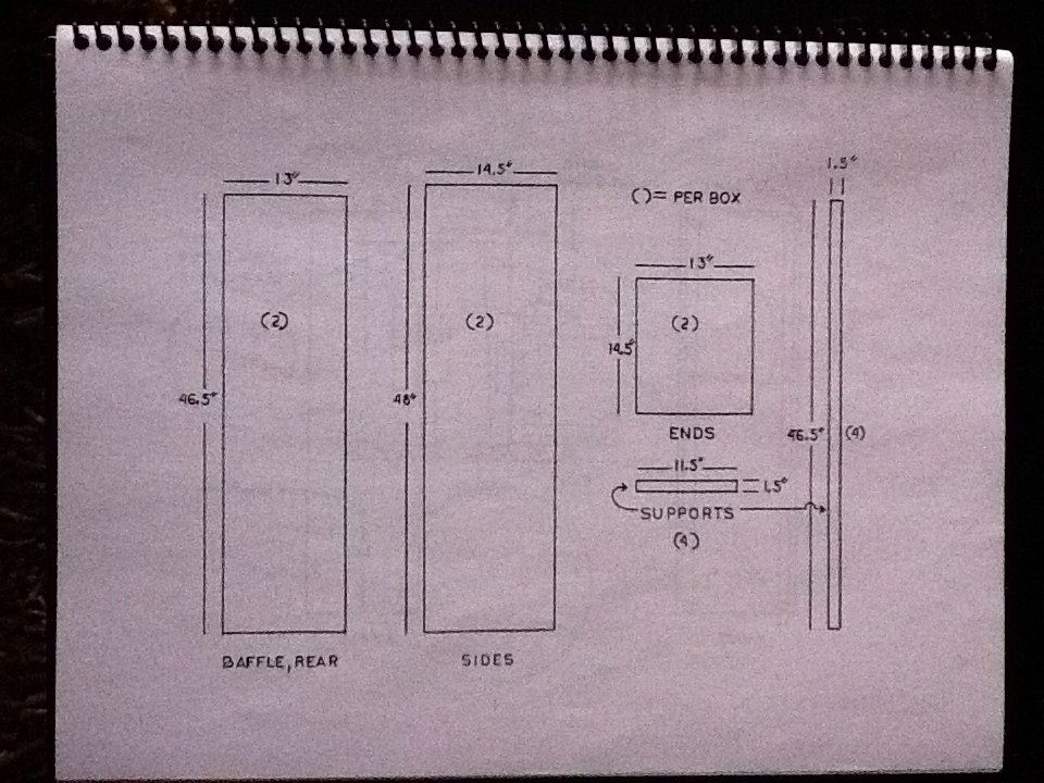

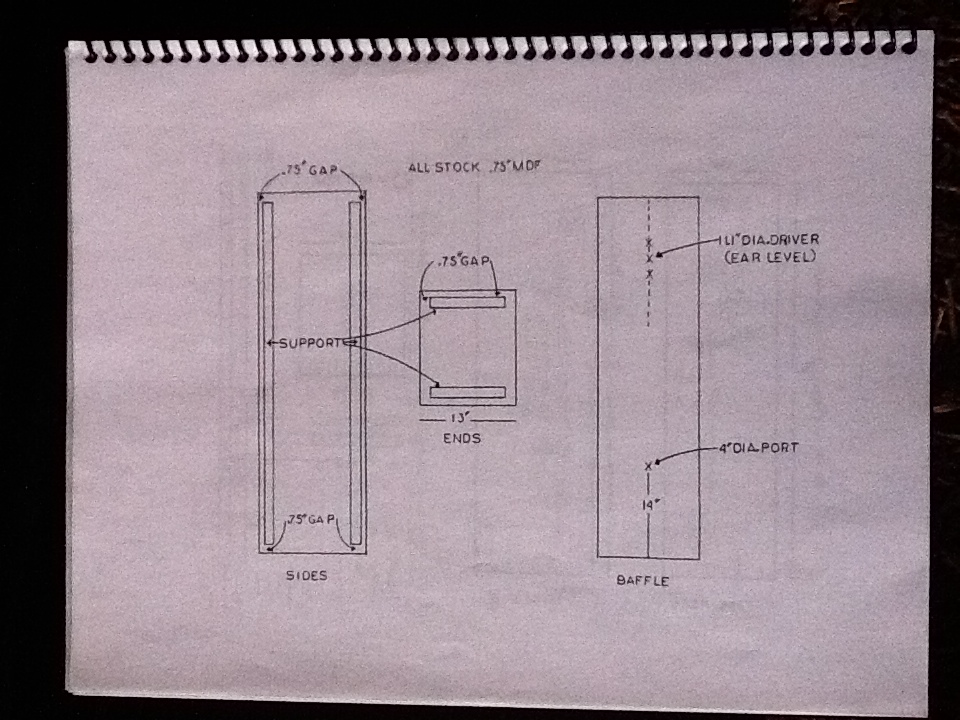

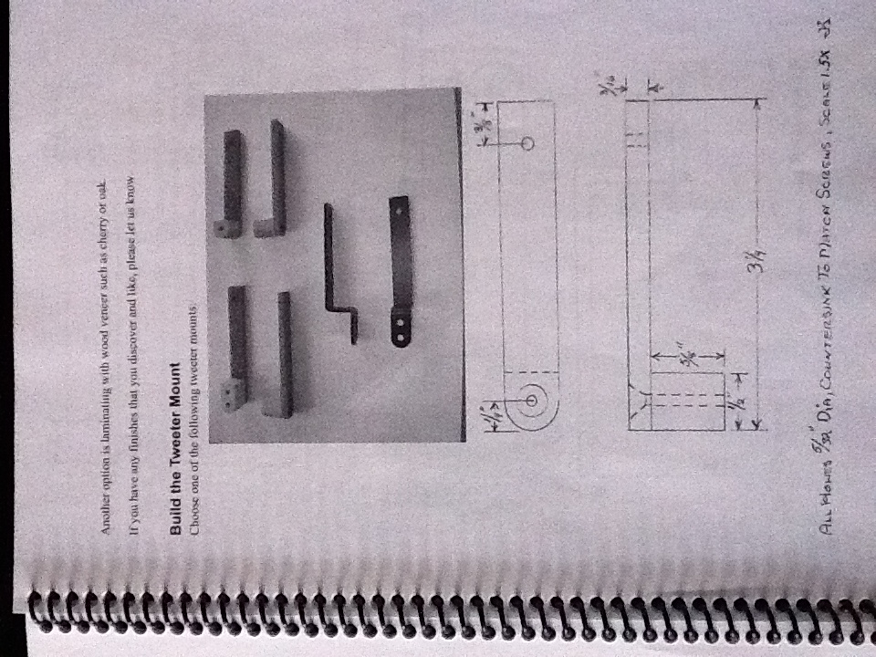

Hammer Dynamics Super 12 looking for cabinet plans
Dimensions are as per pictures

Construction manual size is about 75Mb. Please send me your email address to post it.

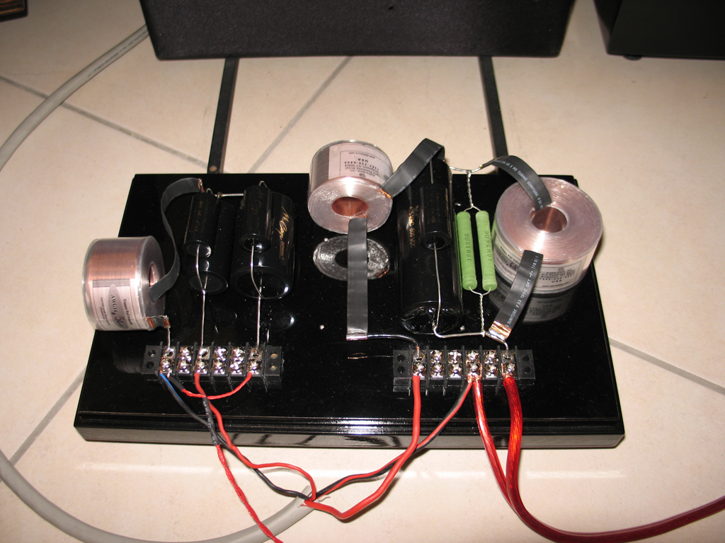

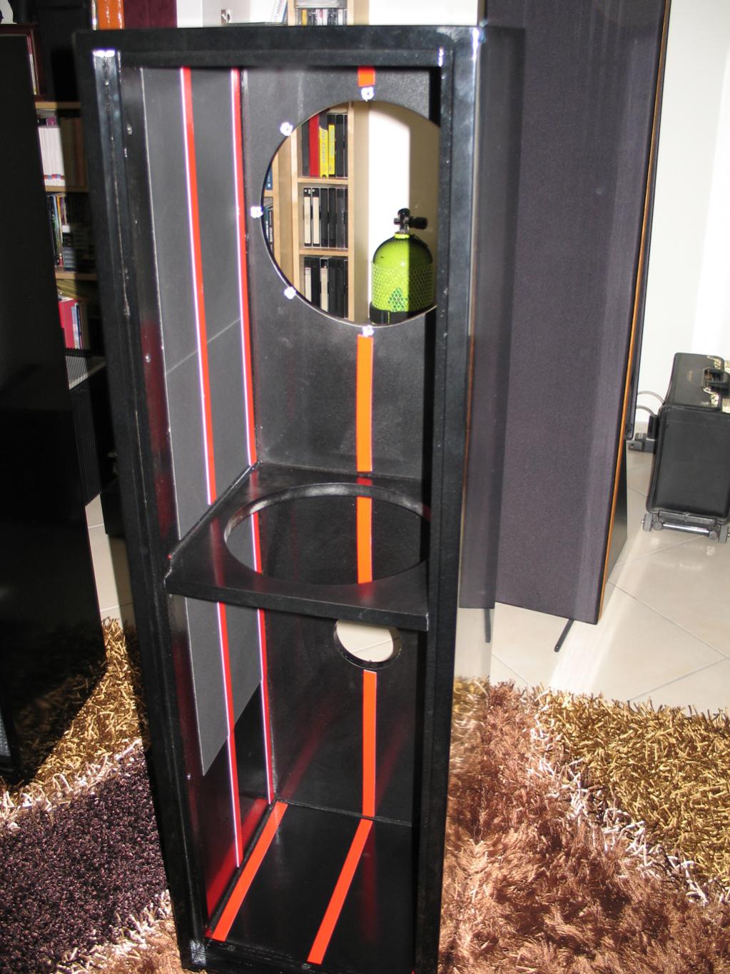

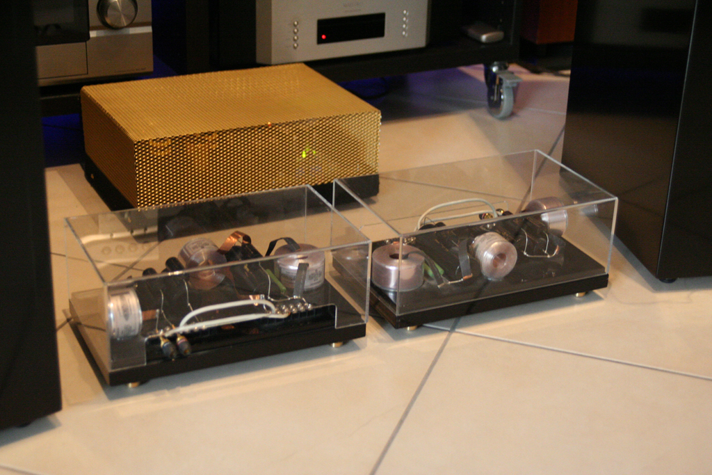

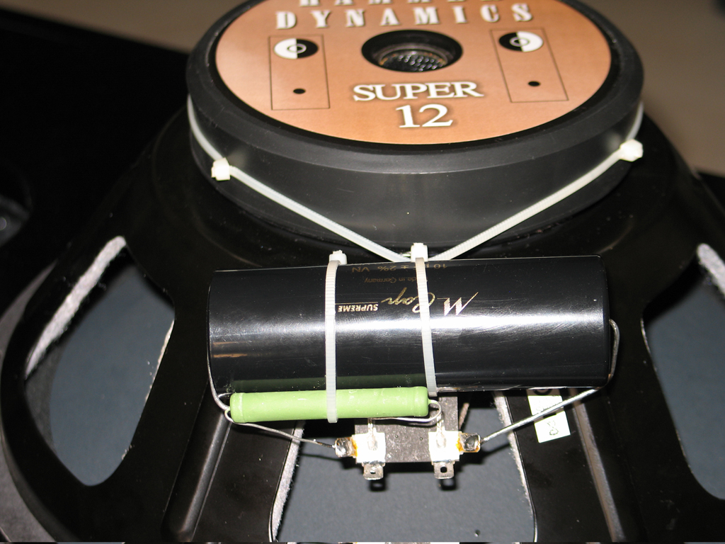

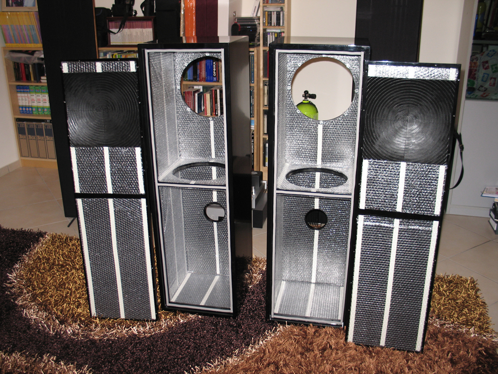

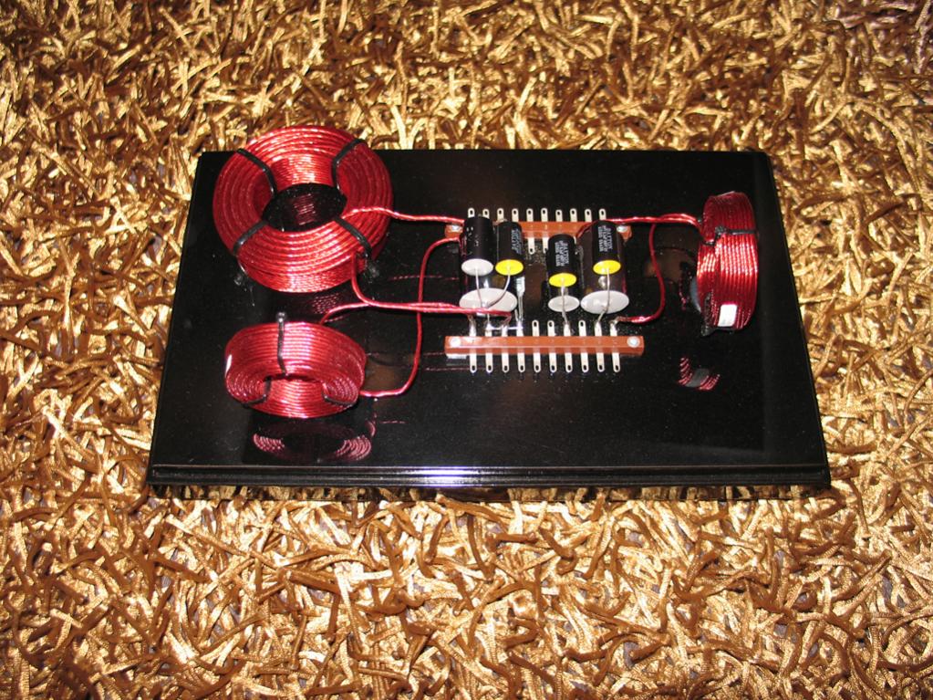

Here are some box and x-over (before and after upgrade) pictures.
Enjoy!

Regardless, seems like one was the same as in the posted manual except with the driver relocated per my calculation and the vent much closer to the bottom at 1/7th, which is what's shown, but I was working off of a layout with the vent much higher, so either I got wrong info or he apparently rethought its location to an odd harmonic for whatever reason.
The driver is too, so technically OK, though further down is intrinsically smoother, allowing less damping to be used.
My 'optimum' version used his CSA, but taller to get the driver up to ~38" based on my driver location calculation, but still don't have access to that spreadsheet, so not sure what the height was. I can't remember if the vent was at 5ths or 7ths though.
