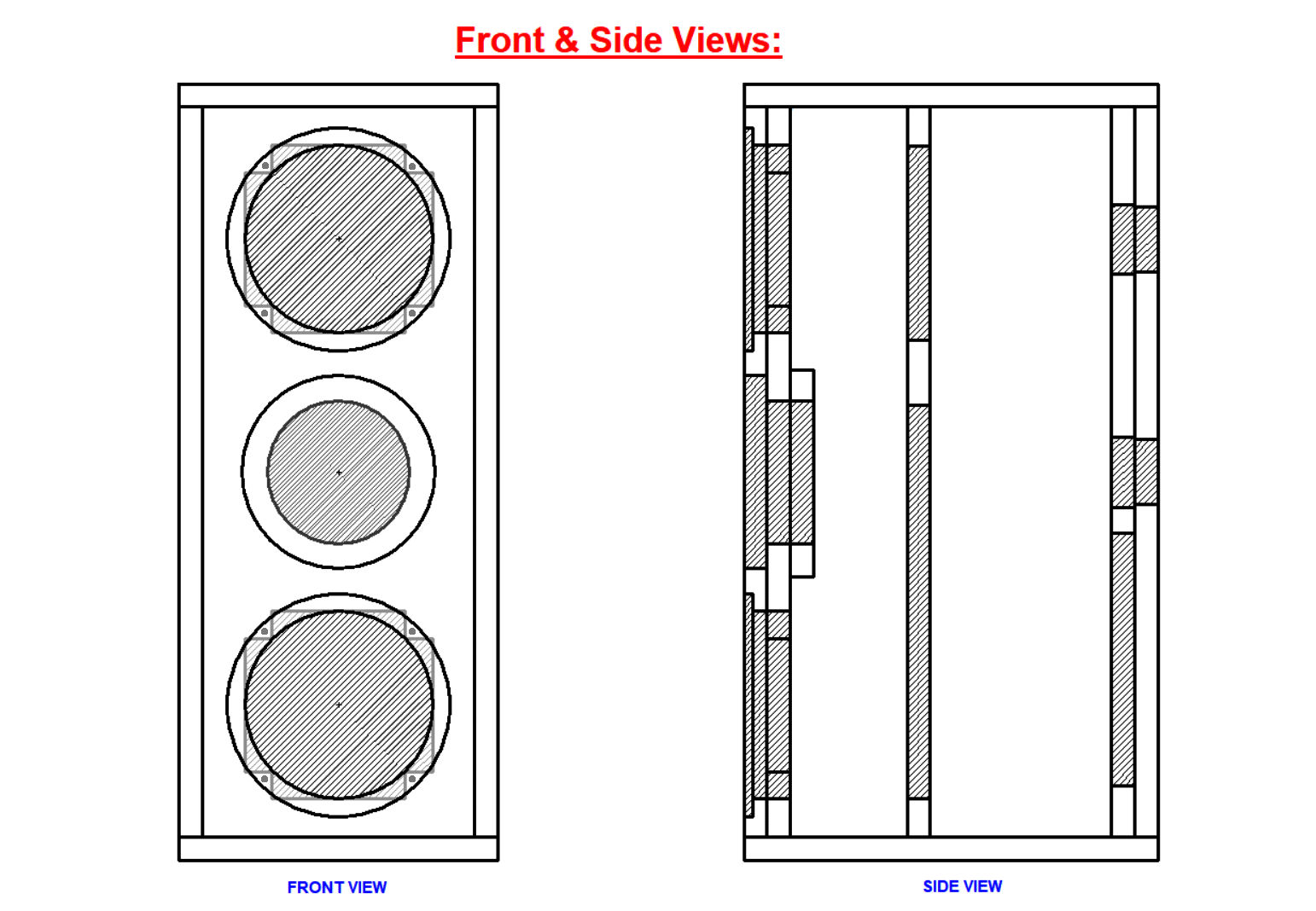

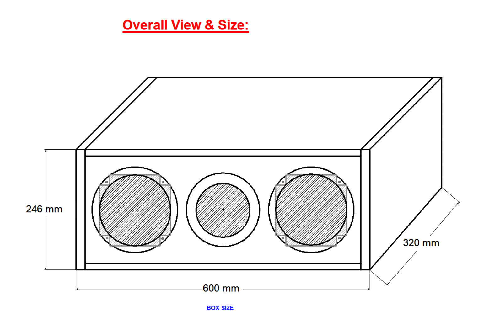

I was approached by a client and as part of that assignment I did something that was a logical thing to do, I redesigned the box of the Hamlet so that it is a bit more compact all round and also a definite improvement in a number of ways. The regretful part is that it is commercial and that it will cost a very fair $120 into my PayPal account. I put my trust that the person will not pass it on to others. And since the cost is so modest, only a cheapskate would do that. So it will be on the honour system.
Below is the overall dimensions:
It can be used vertically as stereo pairs or in multi-channel situations, and of course on its side as a front centre channel. The drivers continue to be "MFC" and the crossover has not changed. Same goes for the Tweeter and Waveguide. There is also a space created at the rear of the cabinet where the Black Crossover PCB fits, the Green PCB does not fit.

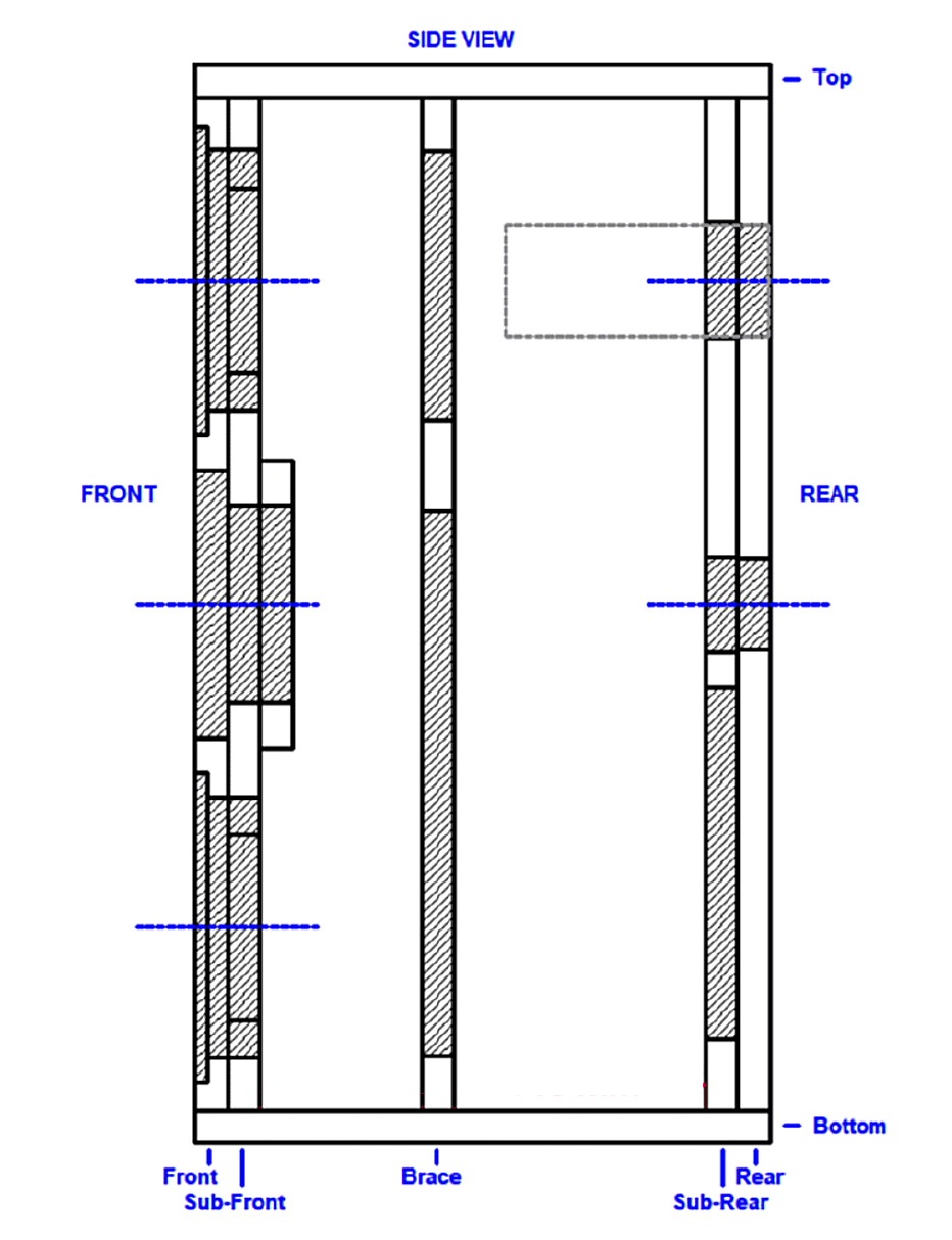

A couple questions.more compact all round and also a definite improvement in a number of ways.
What thickness of plywood/mdf is to be used? Also I see what looks like a back stiffening panel.
also, what stuffing is to be used in it?
These are two things that present issues in the USA. 3/4" wood is standard and polywool batting is hard to get.
I agree, it looks like a nice design! The driver placement is a lot closer which aesthetically is really nice.
It's all 18mm MDF (plywood with at least the same density can be used) and if suitable adjustments are made, 3/4" could be used.
Yes, 3/4 is 19mm and it looks like your ply is 18mm. The only thing that would have to be adjusted is the side panel by 2mm. For the volume displaced by the vertical panels going front to back, I believe we are looking at 5mm difference total between 19mm and 18mm. However, with most of the panels being fairly open (brace, driver cutouts etc... I doesn't seem like a big deal.
So the speakers would be 2mm wider (due to the thickness of the side panels), 2mm taller (same) and if you really wanted to compensate for the extra mm, then 5mm deeper. Although that probably isn't a big deal. Very nice! A USA friendly design!
