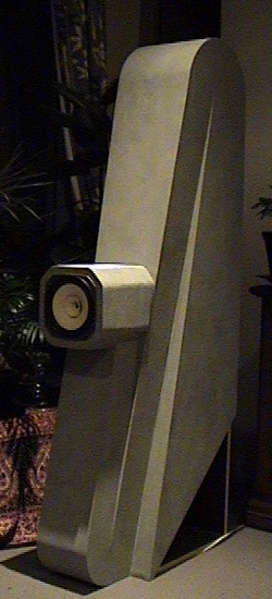

Finished this fe166e project recently, and have been going through the music collection to test 'em and break 'em in.
Length is 3.75m (just under half resonant wavelength of fe166e), throat size is 0.0086 sq.m (13.3sq.in) or 0.65*Sd. Mouth is 0.14sq.m (231sq.in)
Expansion is something like half way between conical and exponential.
On first listening, I thought the cymbals sounded really horrible like dolby C, totally compressed and mechanical sounding, but with a few hours they've really smoothed out. I guess this is the coupling between the main cone and voice coil/whizzer loosening up? I see why these drivers require a long break in. The bass response seems to have improved too, not so much the extension, they've more like 'mellowed', for lack of a better description.
I can't see why you would need a T90A tweeter with these as the treble seems balanced to me, but I suppose I wouldn't miss them until I tried them!
Overall, I'm really happy with the result. The bass extension is great, and the Fostex drivers sound dynamic and very open right accross the frequency range.
There's a picture attatched for anyone interested. I priced Jarrah veneer, but thought better of spending more on the finish than the drivers, so my lass painted them in 'suede' effect textured paint and I really like the finish. I think timber veneer might have made them look a bit overpowering.

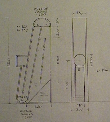

Ok, I went over the drawings in pen to make them show up better.
The one attached is the assembly drawing.
Note that the first part of the horn (around E) is shaped to fit the finished compression chamber, so I left a bit extra on the relevent panels and pared them once assembled with sharp chisels. (Easy with MDF, harder with ply!)
I also fabricated the chamber parts into an open octagonal shaped box braced with the speaker panel and later cut the back angle to mate up with the cabinet upper front panel, if that makes any sense.
I didn't fit the mouth deflector panels as I haven't decided on this area yet.
Hope the pictures show enough detail. Anyone is free to have a go at these as I designed them. I can answer any questions you might have about the construction, but don't ask me what the phase response is like, as my scope and test gear still reside in the UK.

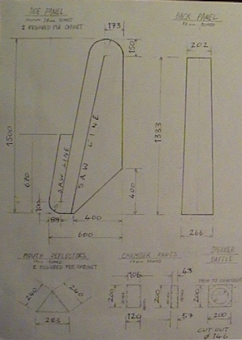

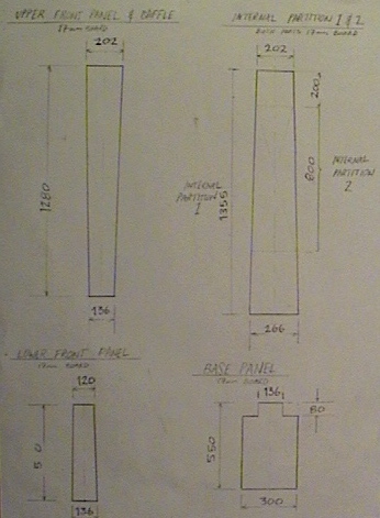

Here are the drawings for some of the parts.
I cut the curved segments out of one rip of material, then individually cut them to fit between the side panels to make up the curve. A small fillet was then cut to fill the small gap left at the end of the curve.
Also, I left the speaker panel oversize and edge trimmed it with a router to the octagon shape before centering and cutting the speaker hole.
Next post is the last drawing.
