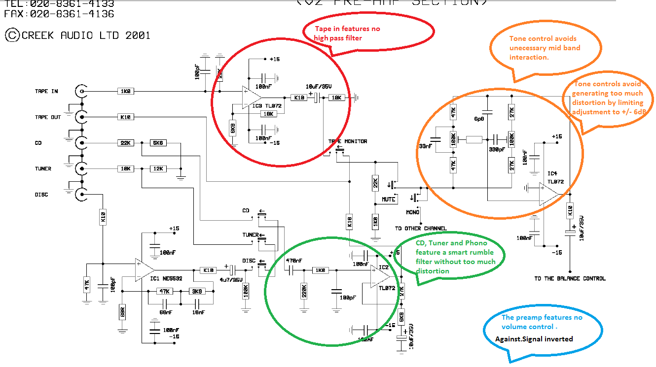

Hi Nico,
The other day there was a timely posting in the forum that had a preamp that is quite interesting and follows some of my philosophies 🙂 . There is no shame in acknowledging another mans work. http://www.diyaudio.com/forums/solid-state/66036-creek-cas-4040-amp-schematic-2.html . Attached is my explanation.
kind regards,
Harrison.

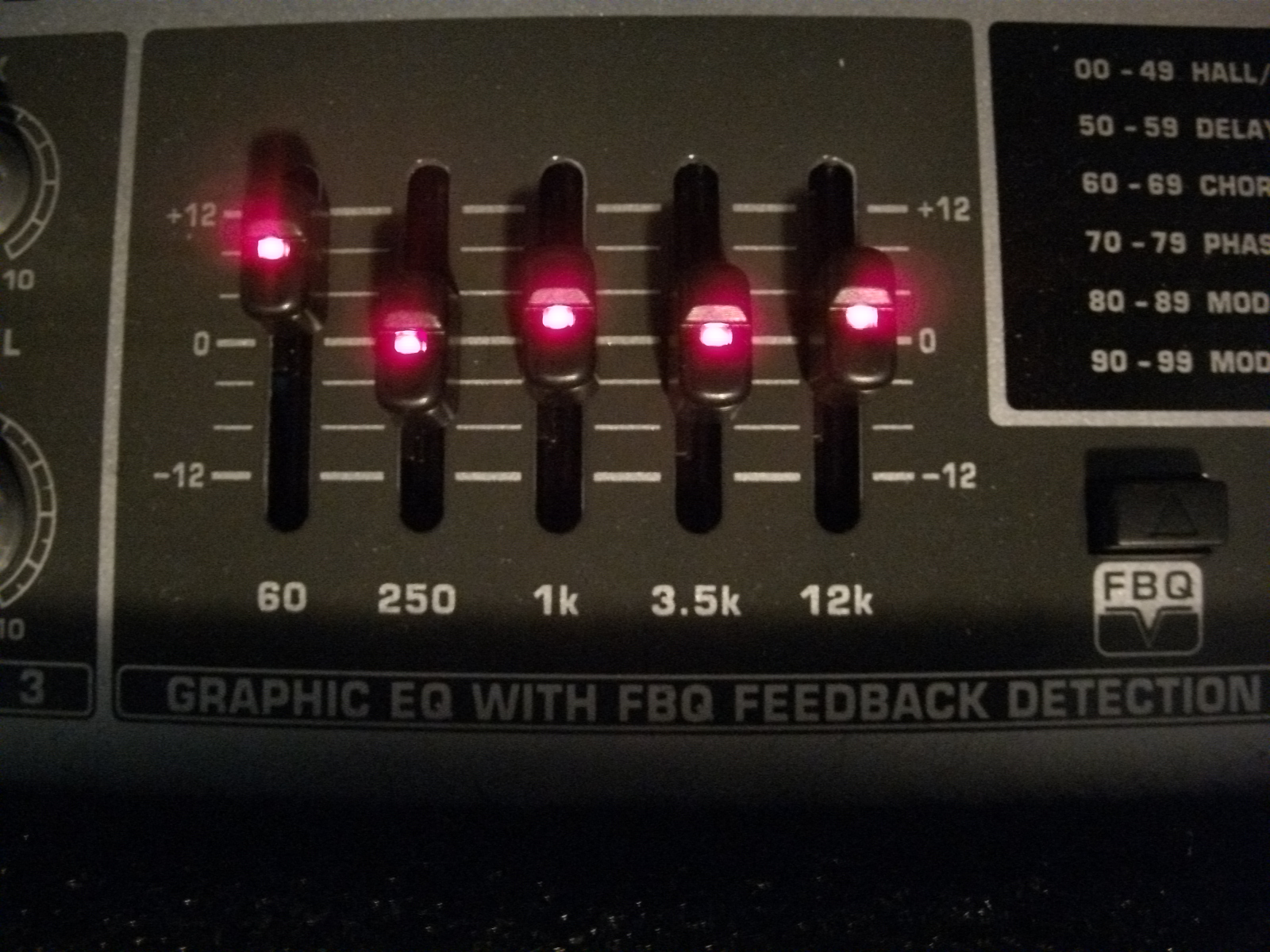

one of my eq settings
This is one of my equalizer settings on one of the two way commercial products.
60Hz@+6dB, 250Hz@-2dB,1kHz@0dB,3.5kHz@-2dB and 12kHz@0dB
As can be seen not much is happening in the mid band 😉

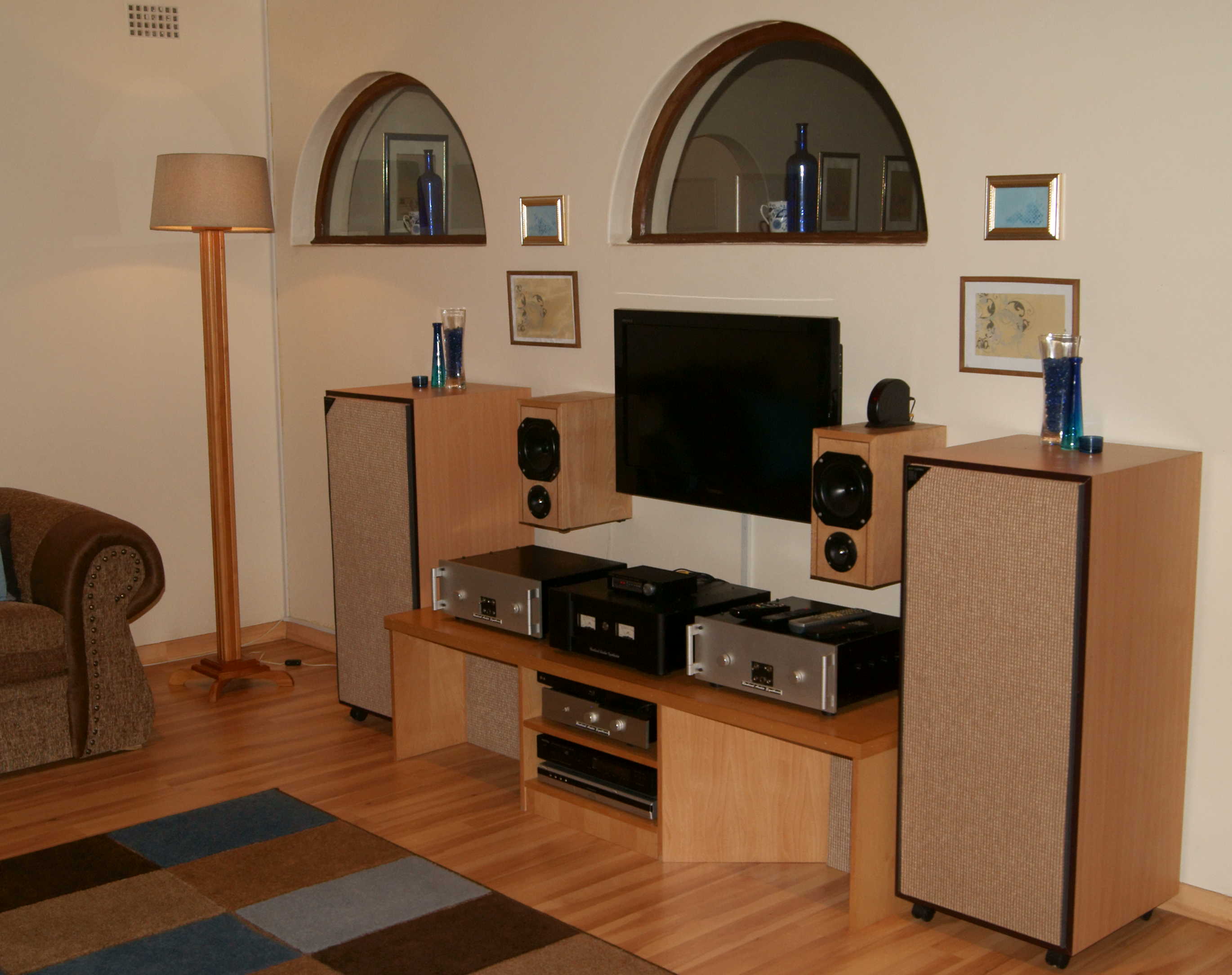

Hi Harrison,
My amps are all very fast, very low THD and quite high power, though my listening level is moderate. Speakers are set all in front of the listener in a typical stereo configuration...... a picture is simpler.🙄
Black amp is 4 channels and the two side amps are 2-channel total of 8 amplifiers. All amplifiers are identical circuits.

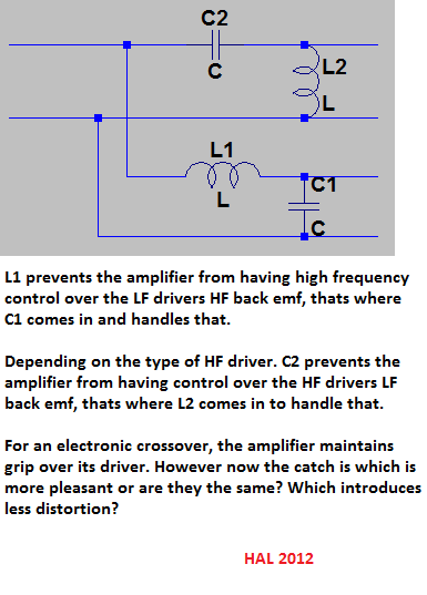

Hi all,
What sounds better ?
1. Using an electronic crossover as part of the preamp
2. Using a passive 12dB crossover speaker side
What is the actual effect of crossovers on our ears ? Does something special happen to the way our ears perceive music when the low frequency is separated from high frequency content ?

Passive or active cross-over. Although filters changes signal phase, amplitude and impedance I would argue that passive at the speaker end would sound different from active filters before amplification because and amplifier output impedance at least remains more constant and relatively low than that of a passive filter at the speaker element.
I prefer the sound of an active filter multiway speaker, but it is my perception of what I think it should sound like, some would say passive sounds better - I don't believe there is better, only different and the listener makes a choice based on his illusion.

How important is it to maintain phase from the source to the speaker. Knowing that each capacitor shifts our phase by 90 degrees. Thus two capacitors in the transmission will do 180. If we apply an inverting op-amp we fix the shift.
Harison, you will get phase shift, but I do not think that is the problem. The change in passive filter impedance will have an effect on the response of the drive element. The active filter provided same form and function in my opinion will sound better controlled than the passive type.
I find that high order elliptical filters seem to do a better job because of a very high roll-off rate almost a brick wall and phase linearity in the pass-band, you can decide on the amount of passband ripple.
Maybe others have other experiences.
When it comes to safety of the drivers, then a passive filter cries king. If it is active system and you accidentally connect the woofer amp to the tweeter, it is history. At least this cannot happen to passive systems.

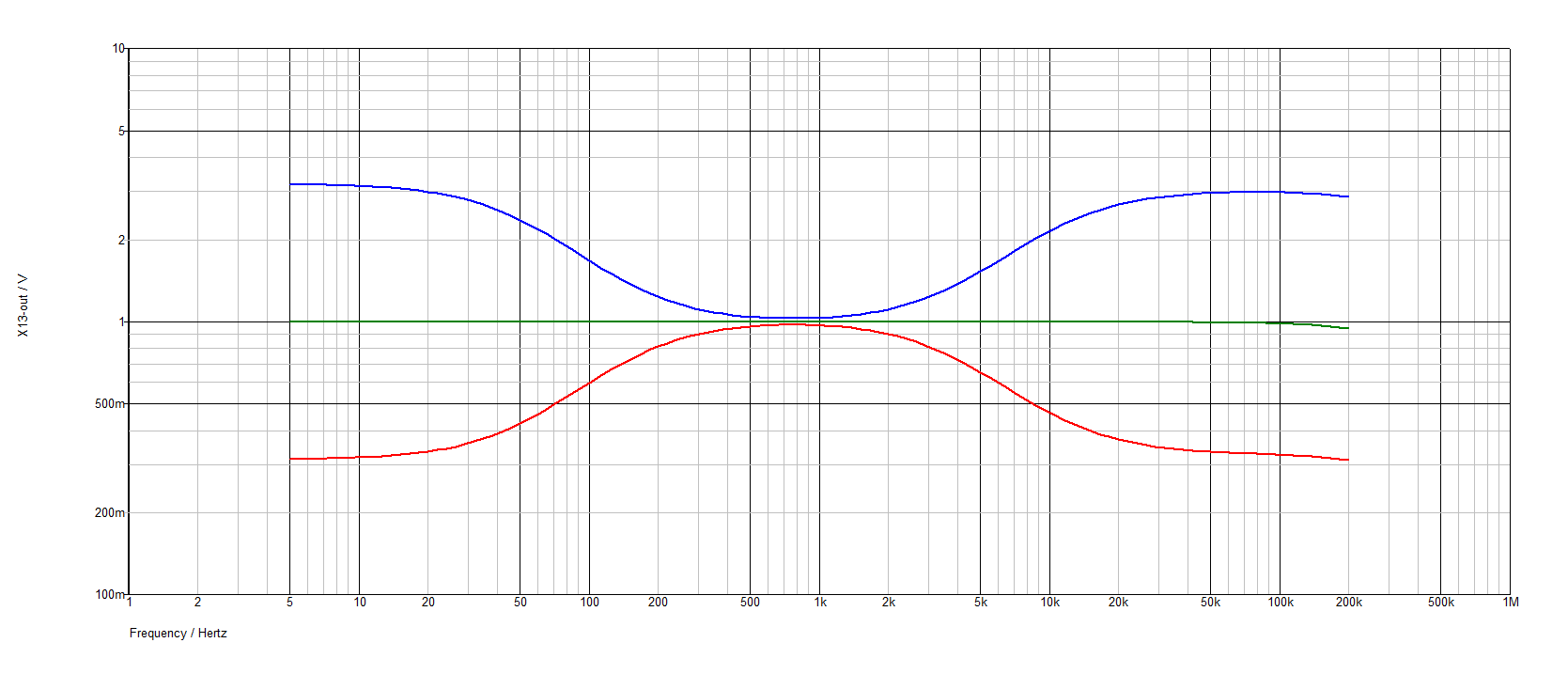

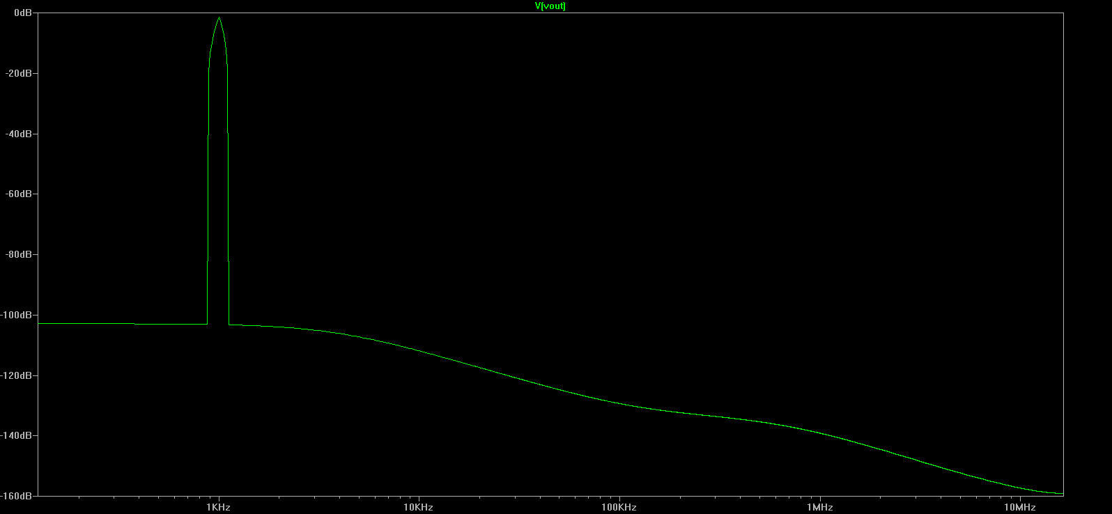

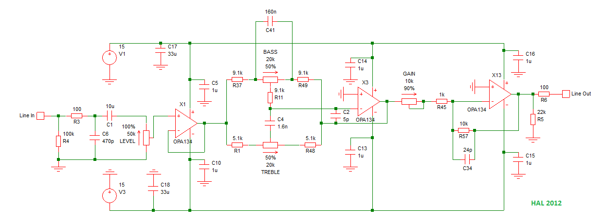

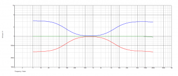

an attempt at simple and sweet
1. Feel free to air your thoughts on this version.
2. PCB volunteers needed
3. How hardy is the OPA134
kind regards,
Harrison.
Hi Drow,
The latest mod features a volume control. I was thinking of you 😉. How often do you find yourself activating the low-cut filter on your Behringer mixer ? If not often this may work for you.
