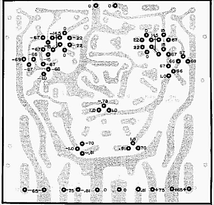

I just went to check this amp and the left channel is working perfectly, but nothing happens on the right...but when I reset the speaker cables I do get a loud crackling response from the right speakers, but no music...I am wondering if the problem is in the input jack for the right channel. I already tried reversing the input cables to no avail. I pupped the top cover and everything looks ok, what should I be looking for?

I suspect your problem is with a component on the PCB. If you have a good meter and know how to work about potentially lethal voltages you could check the points on the diagram and see how close they come to those expected -- as shown on the diagram. These voltages are referenced to ground.
Remove the remaining sheet metal screws that hold the heat sink and fold it out, then remove the 3 small screws around the periphery of the PCB so you can get at its back side. This will allow you to check these voltages.
But, before doing this, you should first run a hot iron around all the traces and refresh the solder joints to the devices soldered to the board. Sometimes a solder joint develops a microscopic lesion and as it makes/breaks contact a popping sound occurs.
You could alternate heat and cold to the components on the board while listening for sounds. This might help identify which component is faulty.
And, you could try tapping each component with the plastic handle of a toothbrush to see if any spot makes the bad sounds.

And, you could try a spritz of TV contact cleaner on the switch on the back panel, the one to bridge the amp probably labeled "Stereo/Mono." If its contacts have corroded over the last 20 years you might get some bad sounds. Spray the switch's contacts and work it back and forth.
