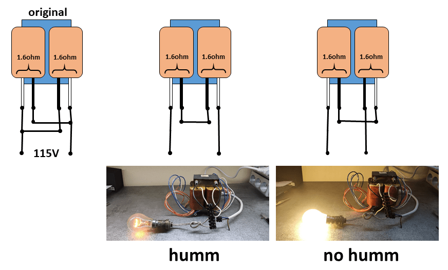

My 115V Hafler p3000 has a transformer wired as shown on the left.
Before I blow everything up, would someone please confirm that the rewiring for 230V as shown on the right is OK?

Possibly, it depends on the individual transformer. Some are OK and designed for both and some not. If it's buzzing loudly then it is being pushed into saturation. There is no easy fix for that, the input voltage would need to be reduced and that can't be done in an easy lossless way.
I find it WEIRD that the 115V example you have black and white wires connected the opposite way, but in any case use of a DBT will help you find the proper phase.
Also: Hafler is a serious Compny and if they provide a 230V option then it certainly must be 50Hz rated too.
So you may have yet another problem.
Disconnect all secondaries and retest.
Use a 100W bulb, what colour is the filament?
It should be red or barely orange, definitely not BRIGHT!!!

I just found by chance that my transformer model has a double primary connected as shown in the picture hence the initial post.

The Hafler transformer is humming too (amp fully operational) when operated with an external 230->115V transfomer.

You could use a power resistor instead of the light-bulb. Could be 47 ohm 100W or similar, or a curling iron, or any similar heating device.
You would have to measure the voltage drop across the series resistor, ideally with the transformer disconnected from everything. If it's more than 10~20V, you have a problem.
Note that this type of transformer (named "cuirrassé" in french, but is probably not translatable as iron-clad) requires a good balance of the drive and load on each leg of the magnetic circuit.
In principle, series or parallel connections can achieve it properly, but if the secondaries are used with a center-tap full-wave rectifier, there might be imbalances during the cycle, causing unpleasant effects.
Using both sides separately is possible (I have done it), but you have to cope with a large leakage inductance, + buzzing and emission of stray fields when the load is heavy

If the transformer buzzes with the correct 115v applied (measure it to make sure it is not actually higher than that) then either the transformer is just noisy with little you can do or the mains is very asymmetrical as that can cause a buzz.
Do try it as @JMFahey suggests with the secondaries not connected.
The transformer humms by itself at 120V, no secondaries connected.
According to google, P3000 transformer humm is a frequent problem and seems to have been cured in the later versions.

In your case humming connection is fine, and non humming is wrong, it´s not humming only because its shorted because of wrong phase.
In fact, I am quite certain that you do not hear hum (a deep and smooth 50Hz frequency) but but buzz, a nasty bee/mosquito type sound, very different in quality.
Both have a 50Hz fundamental frequency but hum is quite pure, while buzz is full of much higher frequency harmonics.
For a transformer core to hum it needs to pass a lot of current (which is not happening, bulb is barely alight) because the whole core is expanding and contracting, while buzz comes from a couple loose laminations vibrating and touching each other, that takes very little power.
Heavily overdriven or shorted humming transformers typically blow mains fuses, buzz does not, it´s annoying but not destructive.
You might try to dunk transformer in varnish overnight, then hang from a broomstick between 2 chairs (put a can or lots of newspaper on the floor to catch varnish drops) until it dries.

When connected directly to 230V (without DBT) the humm/buzz is really loud. Not sure I want to fiddle with baking, soaking or torturing the old beast 🙂.
I don't want to keep listening to this noise and will investigate other solutions for the amp.

With the correct connection (humm), a 100W lightbulb shouldn't begin to glow: the magnetizing current of a good transformer is well below the threshold.
This means that the iron is either of poor quality, or insufficient in core area for 50Hz. There is little you can do to address the problem
