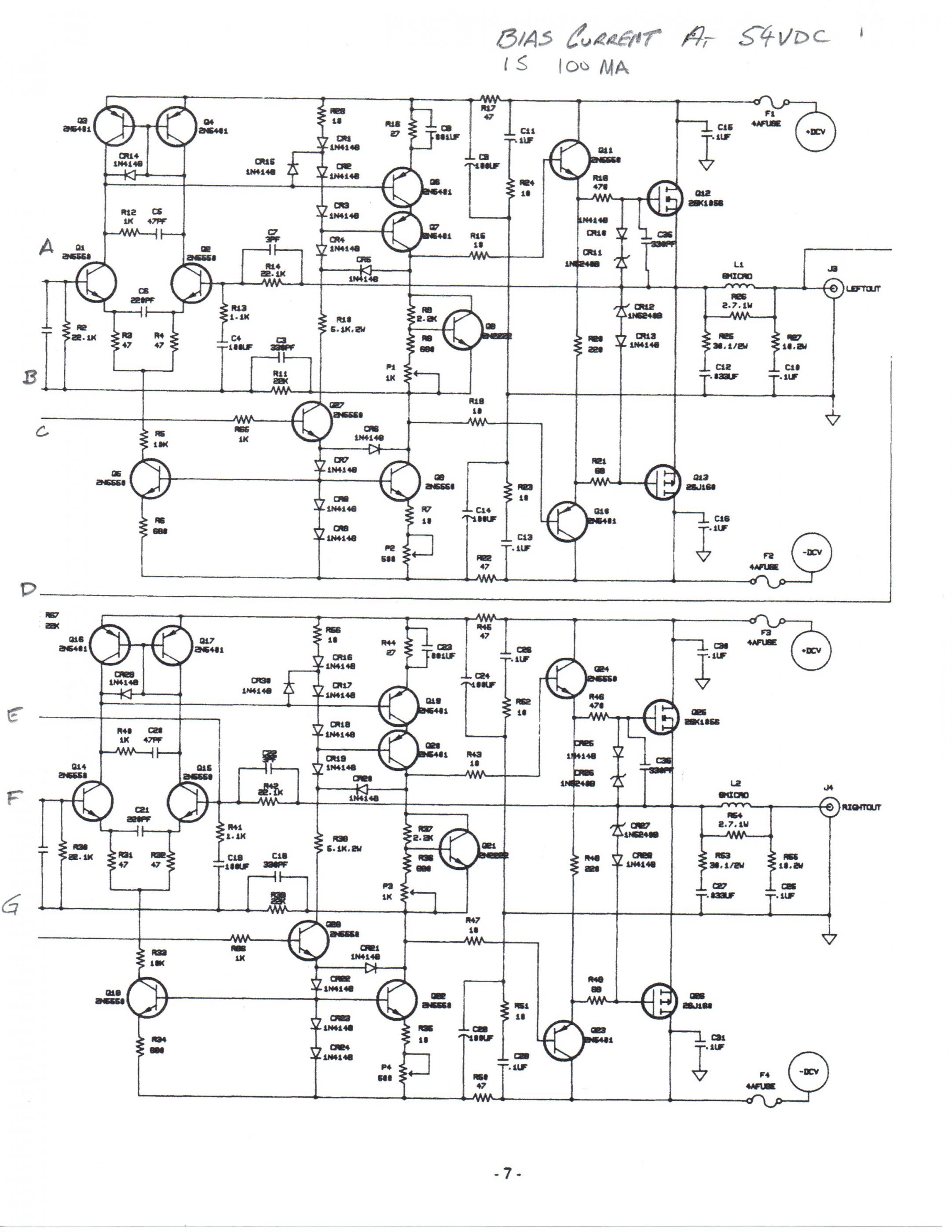

R7 and P2 determine how much current is flowing through the VAS. Normally, it's just a single fixed resistor. In this instance, they added a variable resistor so that they can adjust the VAS current or to tune it to exactly what they want.
The 2N2222 must not be on the heatsink. Actually, it's not required. A normal trimpot will do. The outputs are 2SK1058 and 2SJ162. They are lateral mosfets. No thermal control is necessary.

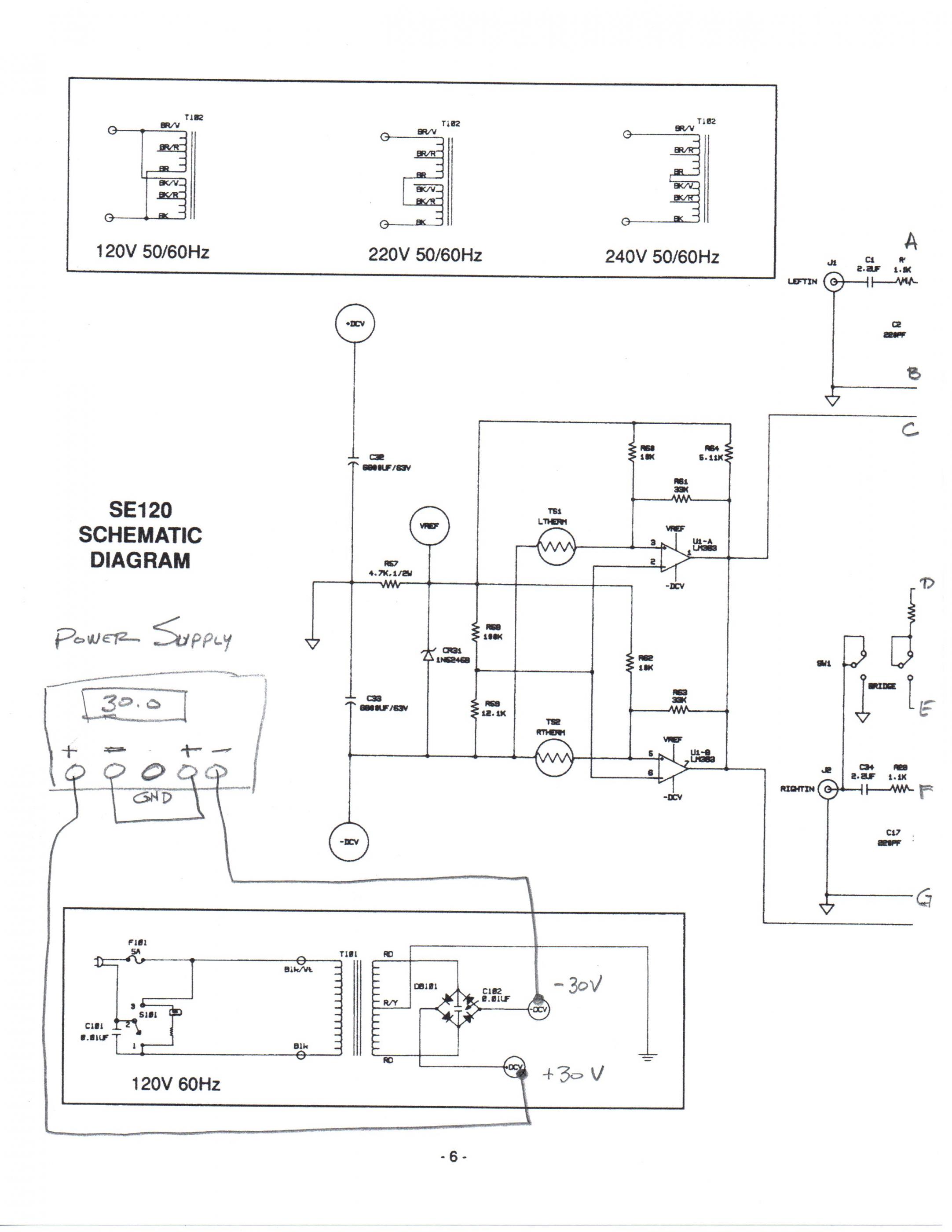

New question. How does the LM393 control the base of Q27 to turn off the current flow when this amplifier gets hot. I know the thermistors are at 10k ohms. They are part number MEPCC#2322-640-63103. The voltages inverting, non inverting and output from the comparators are all negative. This seems like it would keep Q27 turned off all the time and the circuit should not have any current flow through it. Pin 1 of the comparator output is -48.9V and the base of Q27 is -.088 volts. This is what I cannot understand. I have attached the schematic and voltages for this circuit.

LM393 is a comparator. It compares the two inputs, + and -. When the + input is more positive than the - input the output is open or high. When the -input is more positive than the + input the output will be low. Depending on the circuitry around the comparator the output can be a positive voltage or negative voltage. So under normal conditions the outputs, 1 and 7, will be a high voltage. This high voltage will then bias Q27 on, the base needs to be more positive/ less negative than the emitter. With high temps the + input will get pulled negative because of the thermistors, TS1 and 2, causing the outputs to go more negative turning off Q27 until the temps get back to normal. Is the base less negative than the emitter? Clear as mud now.

All negative? That's a negative. In normal operation at low temperature, LM393 (+in) is maybe 1/3 of the way up between -DCV and VREF. (-in) is only around 10% up at best (hard to say because too many values are unreadable). So then the LM393, being the open collector thingy that it is, would let its output be pulled up to VREF.
With Q27 base being pulled towards VREF, 15 V above -DCV, Q27 turns on hard, much like a switch, and can therefore be treated much like a direct C-E connection.
With rising temperature, the NTC thermistor will reduce its resistance and LM393 (+in) voltage will drop, up to the point where it drops below the constant voltage from the voltage divider at (-in). At this point the comparator will pull its output down, all the way to -DCV. Now the voltage across the 1k - Q27 B-E and diodes CR7-9 is going to be, well, just about zero, or at least no more than 0.2 V or somesuch.
This in turn causes Q27 to stop all this conducting business, and CR7-9 get pinned to -DCV, while CR1-4 get pinned to +DCV. With a reference current of zero, LTP current source Q5 and VAS current source Q8 stop working, and Q6/7 end up pinned against +DCV doing nothing. The bias spreader Q8 has no more current to work with either and reduces its voltage towards zero, bringing down output stage bias to zero as well. Output stage input being pulled to ground via R11 at this point, the output approaches ground potential - not like FETs at zero current are going to do very much pushing or pulling anyway. In short, the amplifier shuts down completely.
The 33k positive feedback resistors on the LM393s provide some hysteria, err, I mean hysteresis. In normal operation, they pull the (+in) voltage up a bit, shifting the threshold up and thus delaying the onset of switching. Once in thermal shutdown, they pull the (+in) voltage down a bit, shifting the threshold down so that the amp has to cool back down a bit before it becomes operational again.
Re: P2, I'm not sure why it's called that, it just sets VAS current. Not sure why this would be adjustable over such a wide range, the probability of a TO-92 like Q8 being run at tens of mA on ~50 V is just about zero (rated Pd typically being 625 mW, so that's 12.5 mA abs max, typically more like 6 mA, maybe less).
Q21 doesn't need to be on the heatsink because that's a lateral MOSFET output stage. Laterals have a negative temperature coefficient so are basically self-stabilizing and don't require thermal tracking like BJTs and most everything else would.

Balance, P2. Best adjusted with a distortion analyzer, but sans that you can adjust it for symmetrical clipping at high signal levels.
Theoretically, you are setting the amp so that it has no offset even without feedback. If P2 were set perfectly (which is not going to happen 🙂) you could lift the right end of R14 from the output and instead connect it to ground, (opening the feedback loop) and the amplifier offset would remain at zero.

The right channel works, but resistor r53, 30 ohms is burned through and has remained functional. Regardless R53 requires replacement. Question, what caused this resistor to overheat and burn through.
The left channel is not in good shape. R25, 30 ohms and R21, 69 ohms are toasted. R21 is the P Mosfet gate resistor. C14, 100 MFD, 50V, is burned on the side of the can. Both positive and negative rail 4 amp fuses were blown when I opened the amp up amp and I have not replaced them.
Someone replaced the N Mosfet capacitors with 560PF on both channels and they should be 330PF. I cannot tell if these are gate to source or gate to drain.
Lastly, someone replaced the left channel mosfets with 2SK1057/2SJ161 pair, which are a higher voltage rating than the right channel 2SK1056/2SJ160 pair. so at sometime the original pair were blown.
I think someone must have tried to press the stereo/mono switch and blew the fuses, but I am uncertain as to the real mode of failure.

If R53 is burnt, at some point the amplifier behaved very badly, or someone ran high frequency, high amplitude test tones through it. Probably the latter. I think you can replace R53 and be OK. It makes a Zoebel along with C27, to protect the amplifier against loads or speaker cables that might cause instability. Generally, it's most needed when there is nothing connected to the speaker terminals.
If R21 is burnt then Q13 is also gone. Q13 likely emitted its smoke (transistors need to retain their smoke in order to function), and its gate shorted, taking out R21. Q10 is almost certainly also fried. The resulting general DC failure caused there to be too much voltage on C4. I would also check that Q1, Q2, and R13 remain functional. If there was a high enough DC on the base of Q2 to burn out C4, then these components were stressed.
So, I think you may be able to replace Q13, Q10, R21, R25, and C4 and that may be all. Check Q1, Q2, and R13. Do you have a way of bring up the +/- DCV rails slowly, and with limited current? Some kind of bench supply? That would certainly help.

Q13 may also have destroyed Q12, now that I think about it. Q11 is probably still OK. I'd replace it anyway. Those are cheap.
