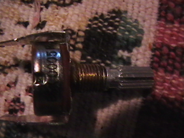

I am deperatly searching for a B5k ohms potentiometer to replace the one on channel 1 of my beloved Halfer P 3000 Transnova amp.
Anyone knows where I can find one?
It should look like this:
P3000 pots
According to the schematic/partslist, the front panel pot for channel 1 of the P3000 is R24A/R24B, whcih is a dual 10K pot, not a 5K as you stated. The part number for the original pot (Hafler) is RV-0818; the mfg (ALPS) part number for this part is 344A-10KBx2.
Hope that helps.
