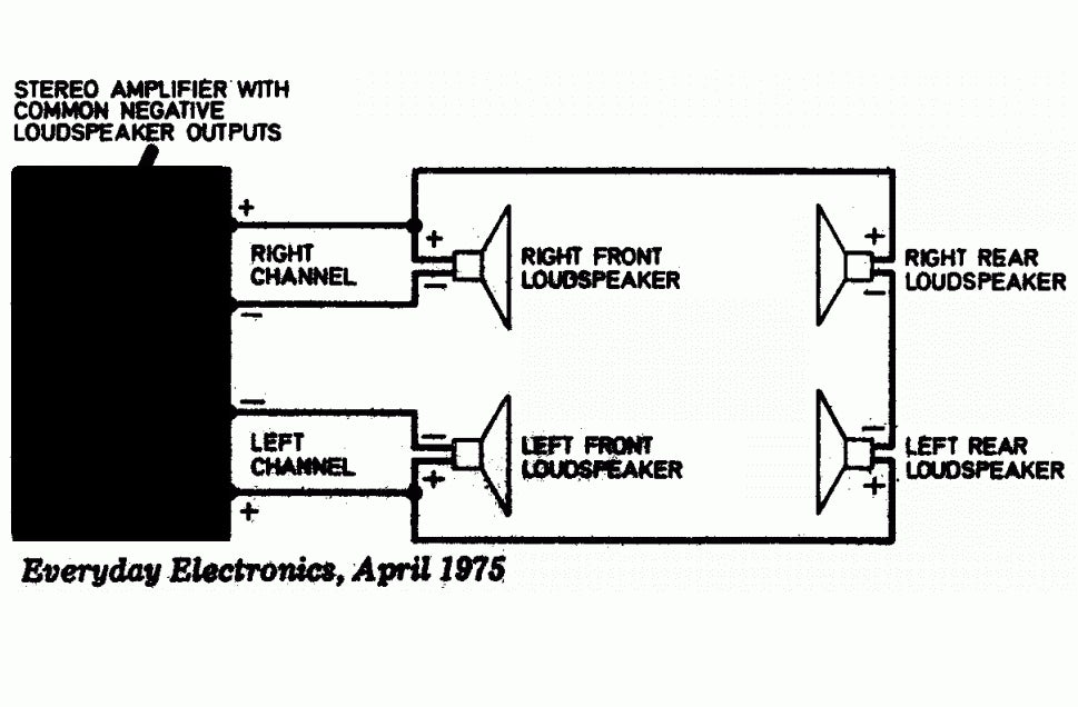

Does anyone (or NP if he sees this) if I can try a simple Hafler Matrix surround speaker set up tied onto my Pass 250.8?
The circuit would tie a rear pair of speakers on the amp, positive Right out to positive in -rear speaker- negative from same rear speaker tied to negative on other rear speaker and positive on the second rear speaker going back to the Left Positive speaker out on the amp- essentially running a series path out of the Right amp speaker thru the two rears and back to the Left positive speaker tap on the amp? Can I experiment with various resistors in the 10k ohm range to attenuate volume in the rears?
I know Pass amps have a different set up on amp outputs than most amps ...thanks
Simple schematic attached...
