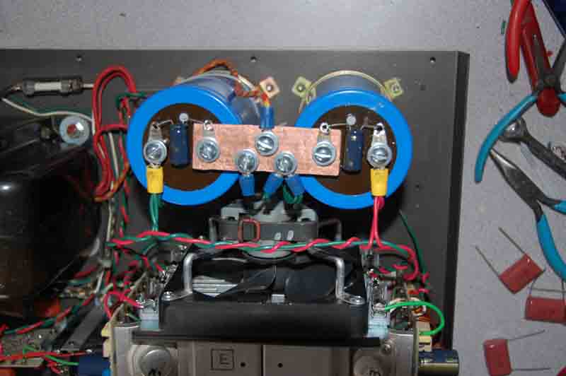

Question: I want to rewire the B+, B- and ground leads from the filter caps to the boards. I am also going to remove the fuses on the chassis floor and substitute and mount tandem fuses up on vertical aluminum strips adjacent to the fan. Anyone see any problems with this??
Here is the question...
Is it preferable to continue to run the power leads from the filter caps directly down to the chassis floor, along the floor, then up to the fuses/boards (as in the unmodded situation) OR to bridge directly across the airspace from the tops of the filter caps to the fuses? Bridging directly would need only about 1/4 as much wire.
Thoughts? Issues? About any of this?
Thanks!!... and more later.
PJ
Here is a pic....
Got the fuses moved and used the existing Hafler wire to "prototype" the wiring. No more fuses on the floor of the amp, leaving open the opportunity in the future to add two more big caps.
I intend to rewire with one gauge heavier teflon coated wire, but this looks pretty clean to me. In addition, a portion of the wire run from the big caps to the amp boards will run along the inside of the cover when it is on.
Big caps bypassed only with a 47uF/100v electrolytic, but I plan to bypass the B+ and B- right at the boards with 1uf polys.
Comments? Issues?
