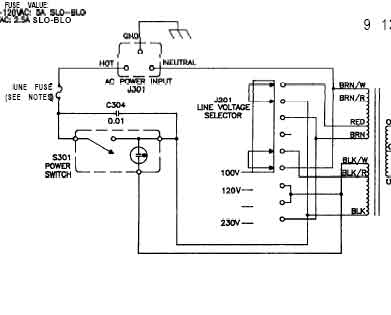

Hafler DH-200 switch
from one of Hafler amps;
there you can see how switch is connected
little play with multimeter will tell ya how to connect switch
always use suppressor cap,as others tells ya already

Thanks slow. I'm trying another switch tonight. But if that doesn't work, what wires do I hook together to bypass the switch? There is a small wire from the fuse, a large black wire from the plug, another small black wire to the light and another blue wire from the right channel board.
I will probably regret this, but...
To see if it is just the switch, connect the two wires together that do not go to the light. In other words, connect the wire from the fuse to the wire from the plug. This is just temporary. If it works, use the new switch when you get it.
If the fuse blows again, it's not just the switch. You have a big problem somewhere else. Quit while you are ahead and have a tech finish the job.

You need to get up close and personal with the Hafler DH-200 schematic and wiring diagrams. You can get these at WWW.HAFLER.COM. Go to the Archive library and download the pdf file for your amp.
The switch has three prongs. Two are to switch the AC, the 3rd is to light the pilot light. The proper switch has the numbers 1, 2, 3 embossed on its back side. The Hafler wiring diagram shows the switch wiring complete with the numbers 1, 2, 3. If you study the diagrams and get the proper switch and match up the 1, 2, 3 connections installing the switch is as simple as "1, 2, 3." 😉
Install a ceramic cap across the AC connections and make it a .01 uF cap as previously suggested.

When you get the Mouser switch, tell us about it. The Carling variety I purchase locally has the 1, 2, 3 numbers molded in. Does the Mouser switch have the numbers?

The Mouser part number I gave earlier is the Carling Mini-Tippette (or whatever they call the silly thing) direct replacement for the original switch, albeit with a 50% higher current rating than the early version of the switch. Jeez, guys, did you think I'd send you off on a wild goose chase? I've rebuilt four or five of these things in the past eight months or so and have yet another lying open on the floor behind my workbench, ready for Evil Experiments of a JFET nature. I also sold scads of the things back when I was in retail.
Yes, the switch will come in with the 1 2 3 connections stamped on the side. DO NOT IGNORE THE NUMBERS. Connect it as per the original Hafler schematic and you'll be fine.
