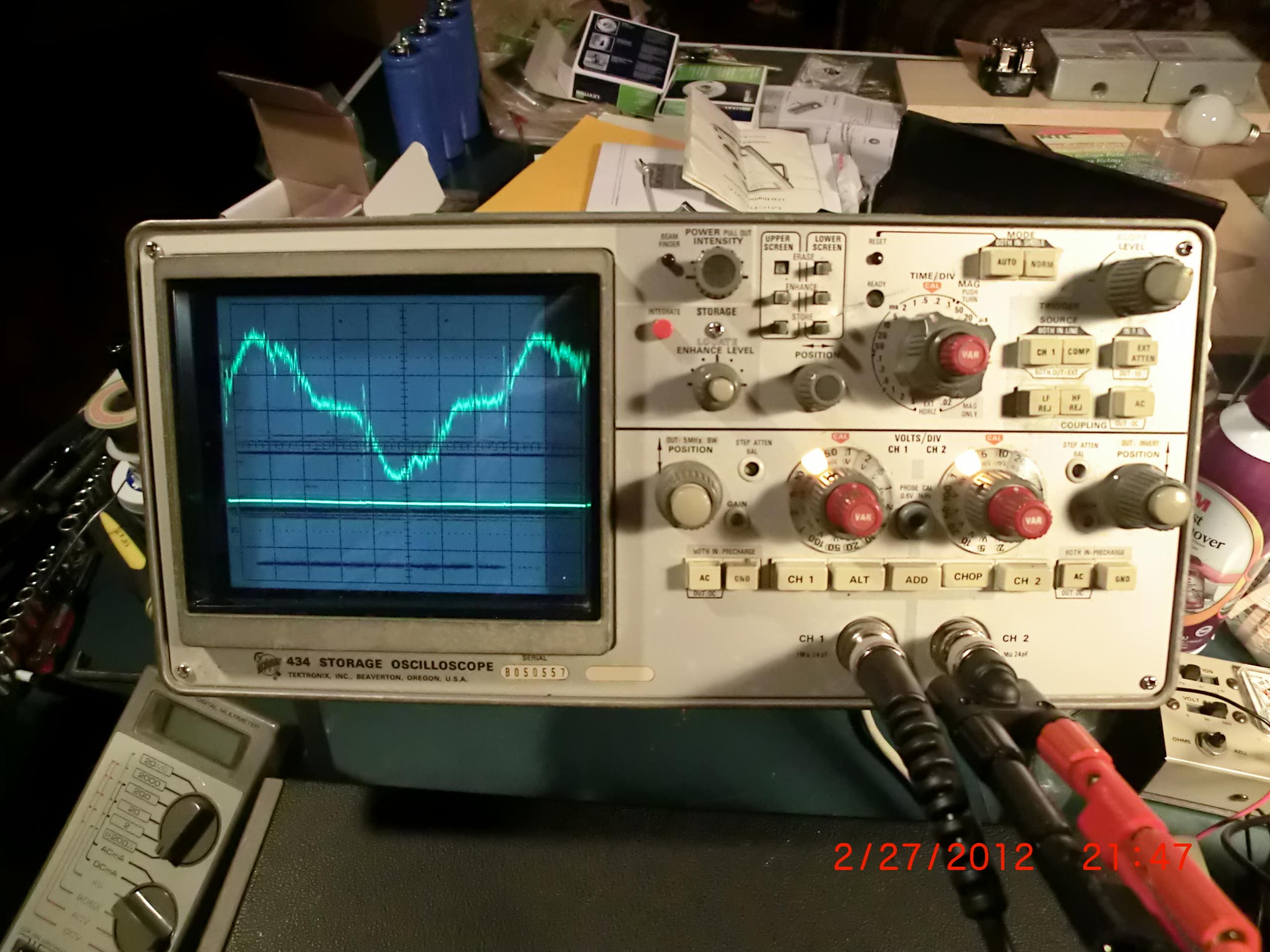

After replacing all the electrolytics on the driver boards + transistors Q1-6, everything was great!! Amp was quiet, and DC offset was near zero.
However recently, I've noticed a very quiet squeal + hiss + hum coming from the speakers. Keeping it in perspective, you can barely hear it unless you get pretty close to the speakers, but definitely audible for critical listening.
Using my DMM (not the one in the picture), I measure 0-1mv of DC and 1.8-2.5mv of AC. In addition here is a picture of how it looks on my scope. The lower trace (flat @ 20 mv/div) is the signal at the input to the driver board, and the upper trace is at the speakers (a mess @ 2mv/div). Horizontal is at 2ms/div.
The noise always there, but does drift up and down in amplitude a very small amount.
The right and left channel exhibit the same signal (on scope) but the right channel is a little higher amplitude (+~50%).
R39 and R45 which can go bad and cause hum are good (if you're a DH-200 person, you know about them and most will tell you to check them first)
Finally, another observation. If I bring my hand close to C1, which is very close to the line level inputs into the driver board, the signal on the scope goes up dramatically. I can put my hand anywhere else around the circuitry with little effect.
I have reflowed a lot of solder, but if this sounds like a cold solder I will do it again.
Ok, those are the clues I've gathered. What's next?

Try shorting the scopes grd to the amp chassis grd. Shorting the inputs is very important if your looking noise or hum...
cold solder joints are common on haflers , from your fuzzy picture looks like bias is too low crossover distortion at your zero point. that being said the bias generator trannies frequently fail, if I recall a common 2n2222 or mps2222a, parts list specs a NP2222.
regards, E
Normal.
Your body works as an aerial receiving all the dirty electromagnetics fields laying around.
You induce them into input C1 when aproaching your finger.
