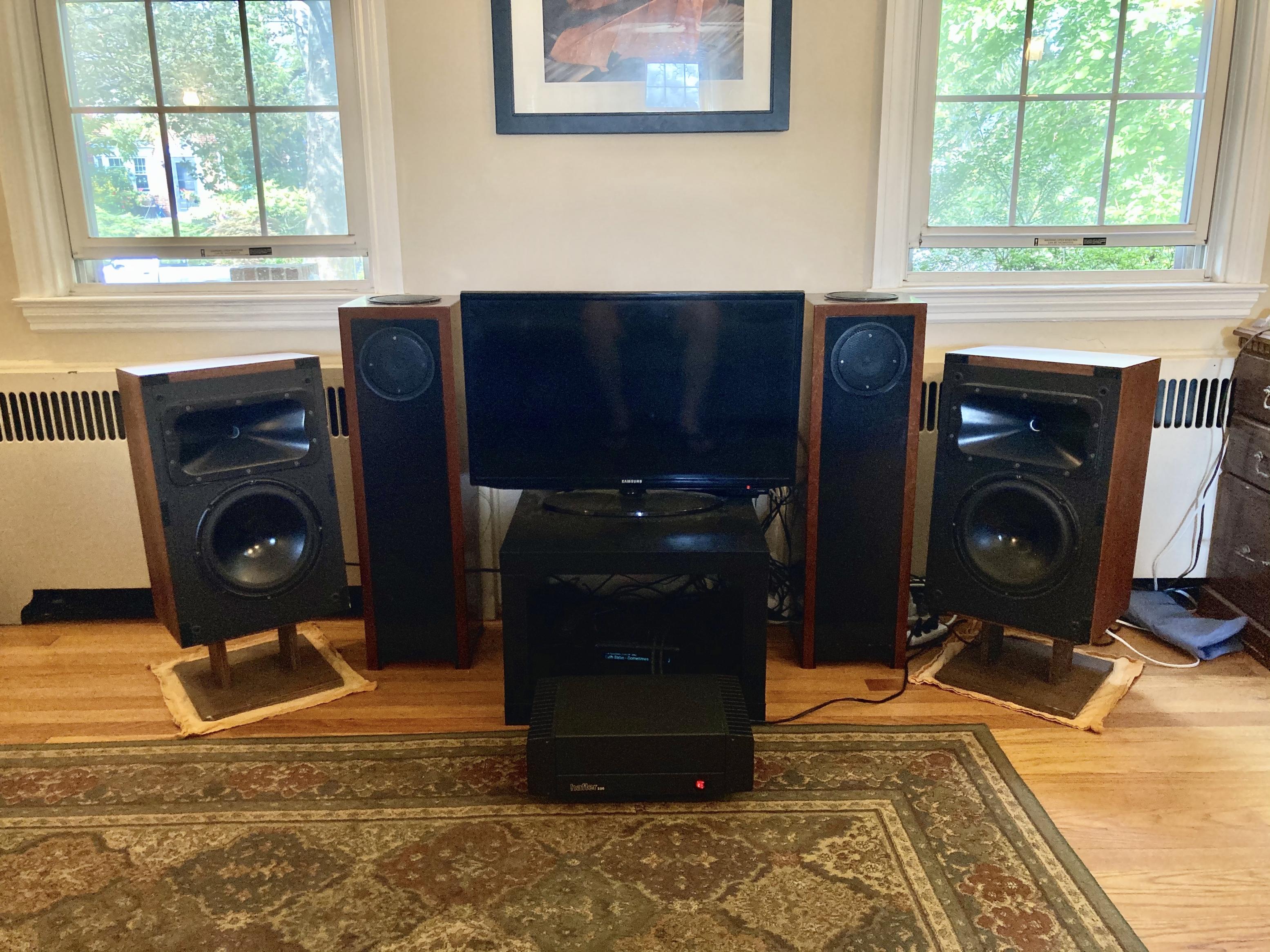

It is certainly very fun to play with different speakers to see how an amplifier performs with different drivers, alignments, etc.
My normal main speakers are the great EL70 Microtowers designed by Planet10 and superbly built by Evan Cotler. I have an ApexJr Mylar tweeter highcrossed on the back for a little extrtra sparkle.
I brought up my venerable Zilch Econowave design speakers from the basement setup to see how a more classic type design would work. I built those speakers with a 10” peerless woofer and Selenium D220ti compression driver in sealed, formerly-JBL-L56 cabinets.
I can’t decide which I like better. Totally different philosophies, pluses, and minuses to each. The Econowaves are definitely more in-your-face for detail and clarity at the opposite ends of the hearing spectrum. The Microtowers are more engaging in overall balance with fullrange drivers and transmission line low end. The DH-220C is sublime with both sets.

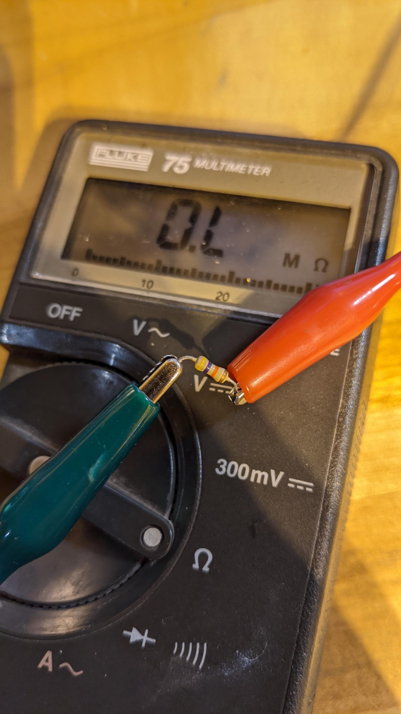

D1-6 diode string biasing is off as measured on the bases of Q1,2. Input stage tail current is calculated by measuring the voltage drop acrosss R8,9 as you can see it is off.
The diodes seem to measure good with the diode check; all measuring around .58 each. Q1 and Q2 seem to test good with the diode check in-circuit.
All of the transistors seem to test fine in-circuit with the diode check, which I know doesn't mean they're 100% good. I guess I'll make my way through testing the caps for shorts/opens. I'll bring home an ESR meter from work but that may not be the most useful if this is a DC biasing issue. It'll let me see how those electrolytics are doing.
I can make some more annotations to the schematic and post them. Thanks for the help.
alive
The dead board lives! Thanks to rsavas and other forum members who have helped point me in the right direction.
It was indeed a single faulty component causing the bias issue. R4 which is supposed to be 47k was open. It had no physically obvious signs that it was faulty. I've worked in electronics for quite awhile and all the resistors I've ever measured as open were obvious.
