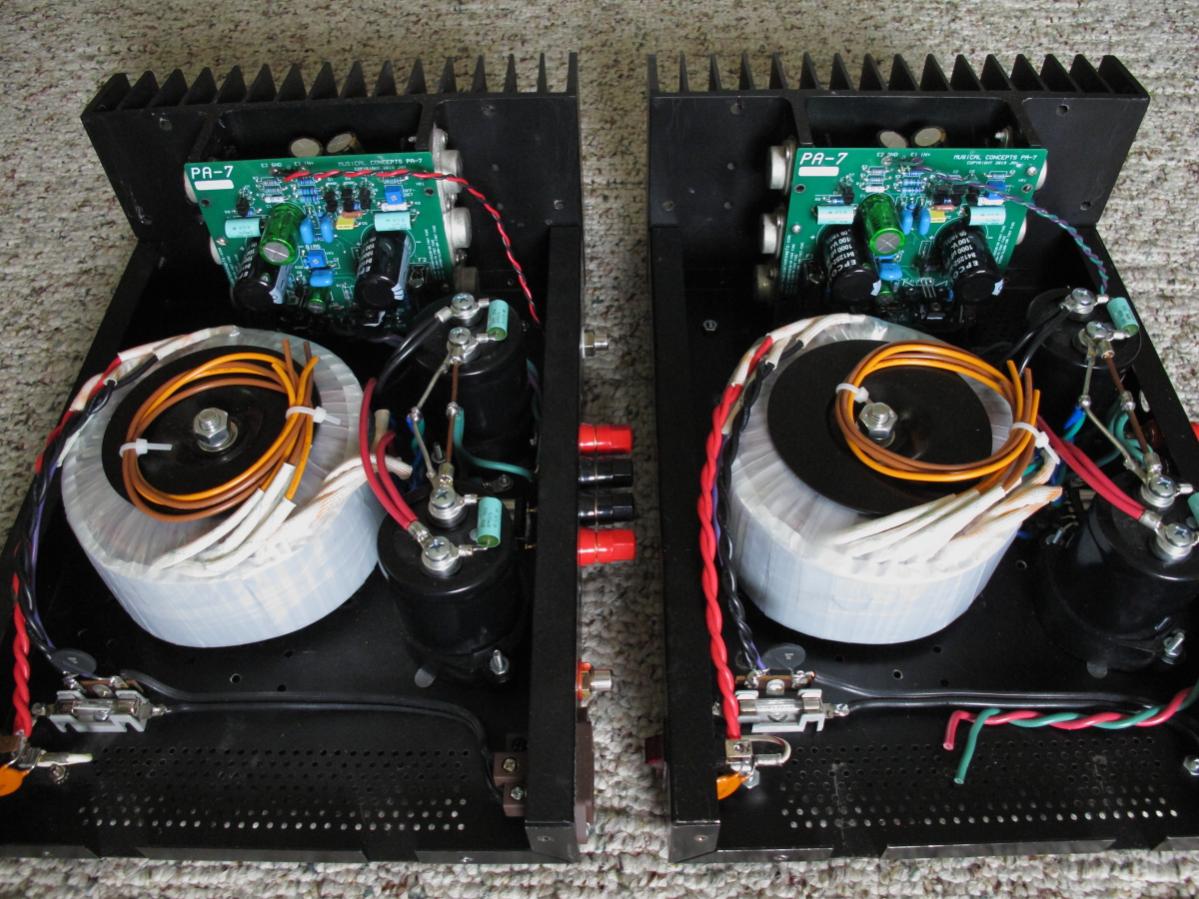

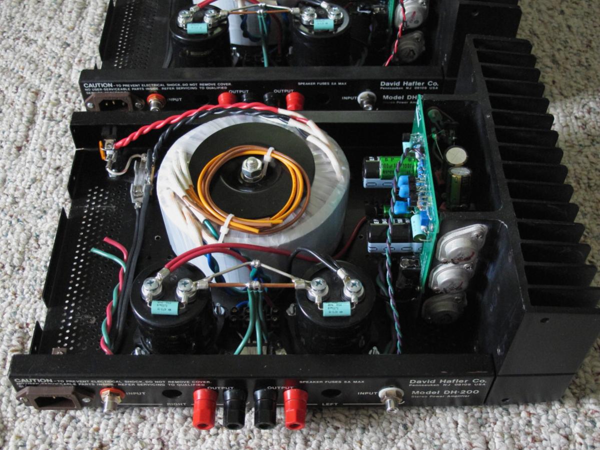

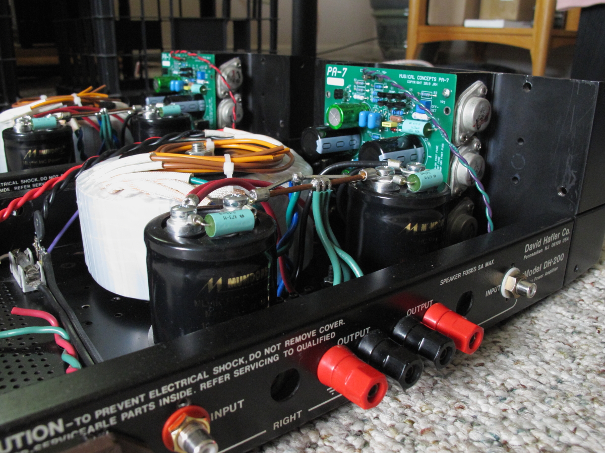

Most recent build - MM230 Mundorf MLHC
I have 2 weeks of run time on my 4th set of Musical Concepts PA7 driver boards, these amps were built with the Mundorf MLytic High Current caps... other wise identical to the P230 mono amps built a while back.
The Mundorfs, while pretty expensive ~ ARE REMARKABLE CAPS ~ they sounded superb on / from the first few notes. They have the same type of clarity... along the same lines as the PA7 boards. They have exemplary bass, weight and definition. I would nearly say ~ break-through ~ it is still too early to say definitively... I cannot wait to build another amp or set of amps; with them... My first impressions, are that these amps are more dynamic than the dual mono "Hafler" 500 with PA7 boards and Jensen 4 pole capacitors... a huge feat and statement...
They are everything I had 'expected and hoped for' and even more... I am drawn to say that I like them even better than "my build standard" Nichicon LNT... [which remind me a lot of the Jensen 4-pole caps] the Mundorfs have incredible speed, sense of slam with no overhang and great dynamics, with natural effortless ease, a relaxed, .but not soft. sounding much like the LNTs. I used the 80v / 22,000mfd LNT and am comparing to the *80v / 10,000mfd MLHC... there is no sense of loss in authority, definition or power. The Nichicons were broken in, when I built the other mono amps. I would like to give them a month before making a more clear / concise comment. *80v / 22K MLHC are enormous, would be a huge challenge to squeeze in a(ny) 200 series chassis.
I like these so much playing [these .are. the best sounding amps that I have heard] through my Silverline SR17 Supreme's... I have yet to unplug them (for long enough) to try these amps driving the Maggies, in place of the dual mono, hot-rodded XL600 amp.
**this is over +10th build iteration of my DH200 "ugly duckling" which I only paid 109.00 +tax, shipping on Flea-Bay. It was so rough, heat sinks, were bent and rounded... never have seen anything like it. The allure for me... it did already have Cardas RCAs and the Pomona 5018 5 way binding posts (worth 75-80$) but the driver PC boards had unusable ~150mv DC offset. Sadly, so common... a significant portion to why I ..do not like.. using the stock PC boards, have such great disdain for them.

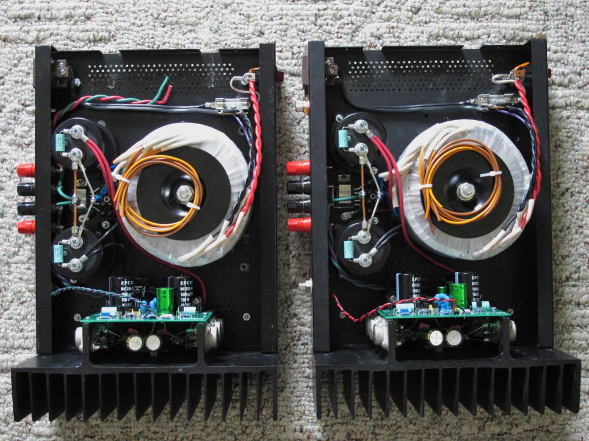

Please understand...
I am only interested in building as mono amps,
only using 1 heat sink, (2) leftover from
stock P230 stereo amp chassis.
1 toroid, 1 rectifier and 1 power module,
in a nice tidy uncramped chassis.

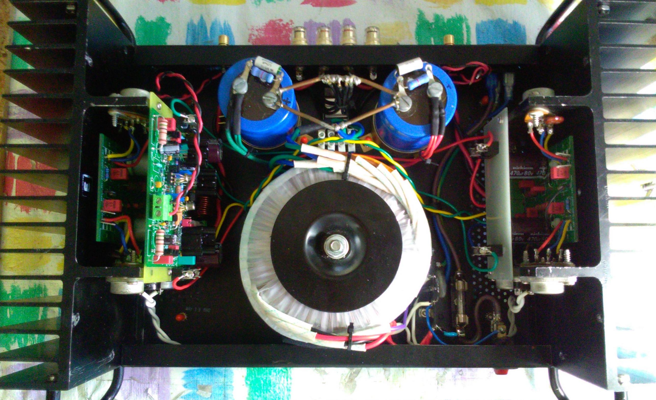

The plan... direction I am heading
I am almost reluctant to share or say: the direction of my thinking...
I now have 4 "unused" DH200 head sinks, that will support an idea
that has been tickling my brain for some time. I have run it by
a few close friends, to work through some minor details.
My next step is to convert or make true dual mono amps,
...not as in bridged... but loading only positive output devices
on one heat sink and negative output devices on opposite
heat sink. It may sound crazy, I may take ridicule...
(which is OK) but I have to try a few ideas out.
*it is about experimenting and learning, and
simply N'th degreeing (proof of) concept(s).
I am working through the actual layout and wiring, which will be
simple, using one PA7 (may experiment with PA4) mounted to,
feeding negative (L) output heat sink, and routing driver signal
to opposite positive (R) bank. I built amps to readily facilitate this
[hard to explain] I will add one B+ wire to positive PS cap and
a signal return back to the driver card for feedback loop.
Essentially only adding 3, maybe 4 wires to the equation and
re-working the heatsinks, driver supply feeds and resistive
loading ~ as an over simplification ~ I am still working
through ideas of optimal grounding (point)
This challenges .my will. for symmetry and wiring simplicity,
but I have nothing to loose, have the parts and chassis(s)
on hand, to support this far reaching prospect.

Putting all of the N-channel devices on one heat sink on one side of the chassis, and all of the P-channel devices on the other heat sink on the other side of the chassis is a bad idea. Nonlinear magnetic fields from the half-wave rectified class-AB output stage currents will eat you alive in terms of distortion. The optimum solution is to interleave P-channel and N-channel devices next to each other on both heat sinks so that the magnetic fields have the best chance to cancel out (actually, to sum to a linear magnetic signal).
This sort of thing is one reason why it is good practice to twist the positive and negative rail wires that run from the power supply to the modules together.
Bob
Bob
Thanks Bob!!!
Point taken, appreciate your insight and input...
thanks for saving me the headaches.

Dear Oz, in addition to Bob's comments, I think that you face what every designer of Class AB amps has to deal with: balancing the positive and negative half-cycles. Given the disparity between the P and N channel devices used over the years by Hafler, it has always been a challenge for me to match them as closely as I would like for gain and current, not to mention slew rate, no oscillation and other criteria. Even if you buy the latest, matched Exicon parts, they are matched P to P and N to N, not N to P!
All the best on your project,
Ivan
